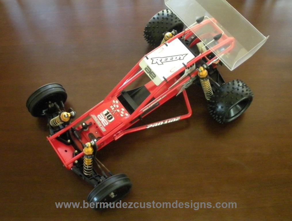

This roll cage conversion looks pretty cool. [$140.00, shipped]
It's drilled for 6-gear or Stealth, and it says you can request anodizing in various colors including "light gold". Here's the eBay ad:

Just a correction; they are paint coated not anodized.

I looked at them and found they would bent totally upon a front crash or even falling on the roof... Not the perfect design. Looks good, but looks very fragile. The should at least include two cross bars in the front (left and right) between the chassis and the nose tubes...

The roll cage is very tough, they are not made of aluminum tubing, but rather solid aluminum 1/4" round bar. Factory front bars are actually made of 3/16" dia. tubing (hollow). The number plate holding the front lower bars together is actually 1/8" thick plate and is welded completely across. Both the lower(main horizontal bar) and upper(roof profile) are each made in one continous bend without weld joints. The chassis is also 1/8" thick plate.Asso_man! wrote:I looked at them and found they would bent totally upon a front crash or even falling on the roof... Not the perfect design. Looks good, but looks very fragile. The should at least include two cross bars in the front (left and right) between the chassis and the nose tubes...
I designed and made them for my RC10 runner, it is both light and strong, but yes if you run it thru a brick wall it will probabbly bend.

im probably gonna have to buy one of the uppers just for my build. The more I think about it, the better its gonna be. the more I look at it, its getting closer to a RC10 Javelin, no.... Javelten, no......Javel10 there we go.
The only thing I wonder about the rollcage is if there is a body that can work with it.
