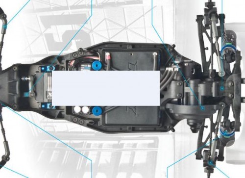

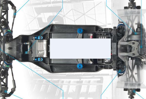

The relevant ROAR rule is:
Rule 8.2.3
All chassis in all electric classes (except those specifically noted) MUST accept batteries up to the maximum dimensions allowed for its application. The legality of a chassis will be determined as presented to technical inspection. Chassis that require a configuration change, and/or a modification to fit a battery of maximum dimensions will not be considered legal, and the racer will be disqualified. Foam blocks/spacers are permitted to secure any size battery in its position, but the aforementioned spacers may never be attached to the chassis.
Fitting a full size stick pack in a mid motor TLR 22 and a B44 would both need modifying and the B44 would certainly class as a configuration change.
If the ROAR rules suggest all chassis must just be able to 'accept' a stick pack, as in must be physically able to get one in there even though there is no way to actually mount it, how do you explain the Durango DEX410 being ROAR legal.
There are engineering drawings behind the side view at the top of each page. On the B5M there is a wall between battery and electrics, and another between electrics and servo. I have drawn a stick pack to scale on the chassis picture, and as you can see it would clash with the servo unless you use a very low profile servo.
The rear motor engineering drawing shows there is a rib across the chassis between the battery pack and electrics, which would need to be removed to get a stick pack in there. as you can see on the picture below, if a stick pack was fitted, while it would fit behind the servo, you have the longitudinal chassis ribs running right through the middle of the sections on either side where you would mount the receiver and ESC. You would either have to cut away the ribs or mount the electrics on top of the battery strap.
