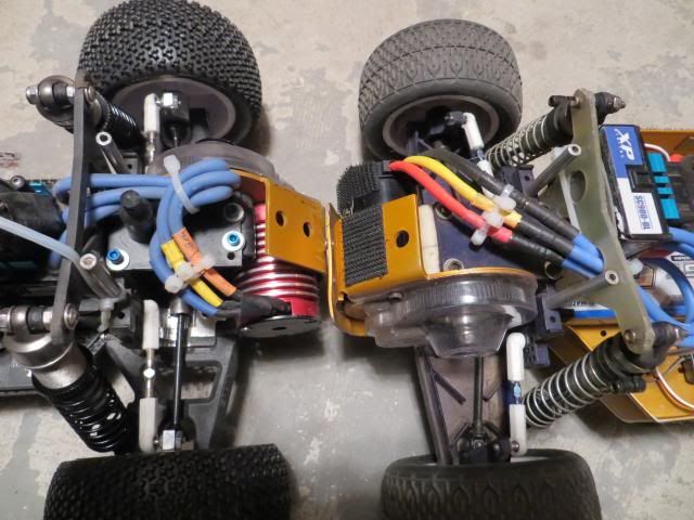

Almost done with the T3 restoration with brushless/lipo. Waiting on a few small items to arrive by mail but pretty much there. What does everyone recommend for front tires? (the slicks are what it came with)
Ran it today, indoors, there 18 inches of snow outside
and wow, it's really fun. VERY different from the 10T i recently restored running a brushed 15T.
Here are the before and after pics. I bought the T3 roller on ebay and it was in very good condition, very loved by the previous owner.
BEFORE:
AFTER:
BEFORE:
AFTER:

It looks in your picture like the bullet connectors have some exposed brass; cover that up! You definitely do not want those making contact, will fry transistors in the ESC in an instant!

Sixtysixdeuce - Thanks for spotting that. I didn't think about that! Today I put liquid electric tape on those to cover up the brass. Glad you saw that!

No problem! Would hate to see your brand new ESC let the smoke out!Thanks for spotting that
Personally, I like to loom them at the connectors, in addition to insulating. I have seen plenty of them rub through; just happened to my buddy's truck a couple weeks back, and his SC104x4 nearly melted to the ground.
This is my trick:
