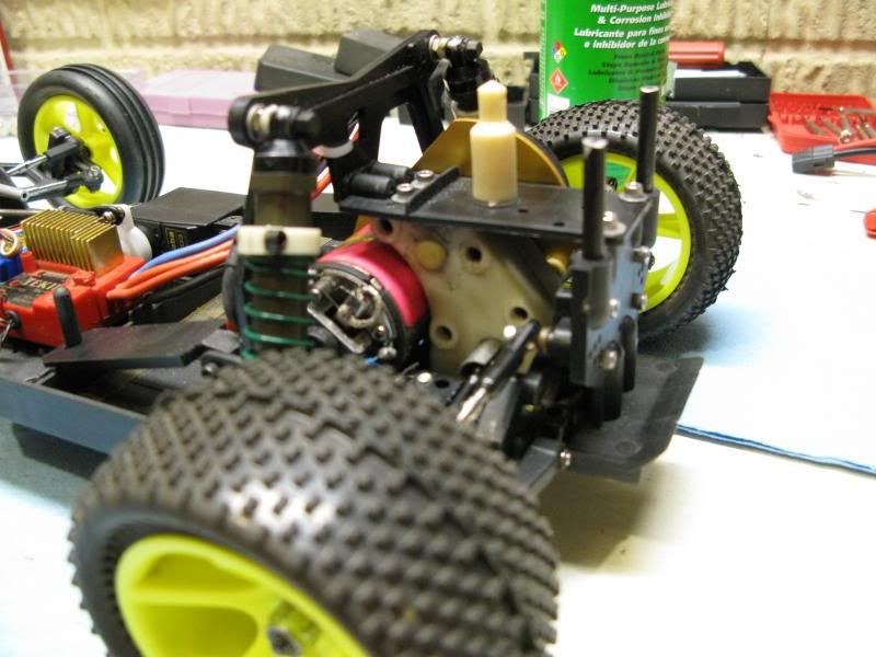

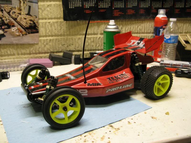

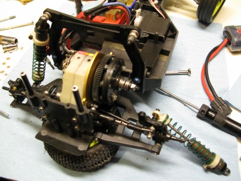

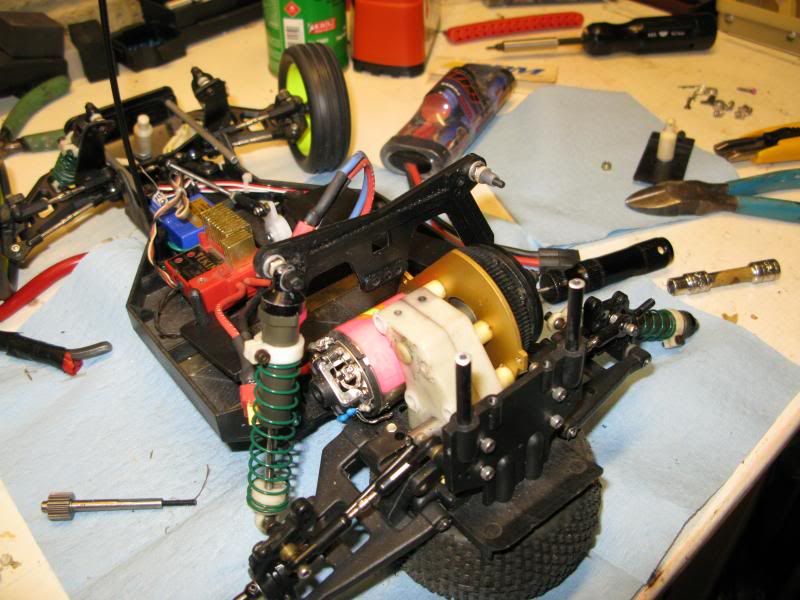

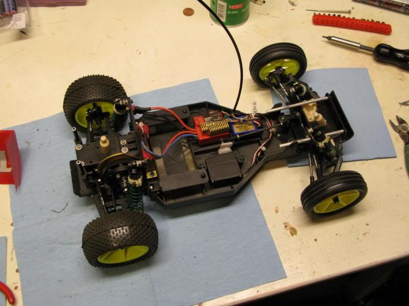

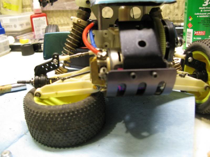

Just the other day I picked up a used RPM 2.65 case off of e-bay. For some reason it had the other side of the slipper shaft drilled out. I thought it was odd, but after thinking the mid engine Tekin RC10 popped into my head. So I used one of my RPM 2.65 hydro drive shafts and a little modification to the RPM case and it was good to go. I'm pretty happy with the overall results.

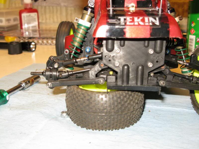

the rear hubs are Losi ??...... what is the part number ??

The Tekin Manual suggests you use Losi Part #A-2038

Yup, I have the same on mine. Use the lower set of holes and it fixes the geometry.

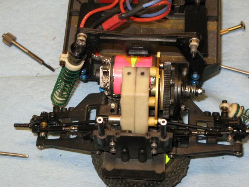

Just like was stated above, I used the Losi hubs as per the Tekin's directions. Here are some close up's of the hub on the Tekin, I also used them on my one team car.
