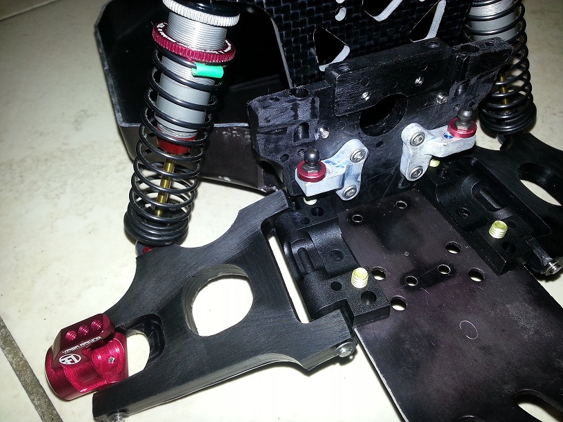

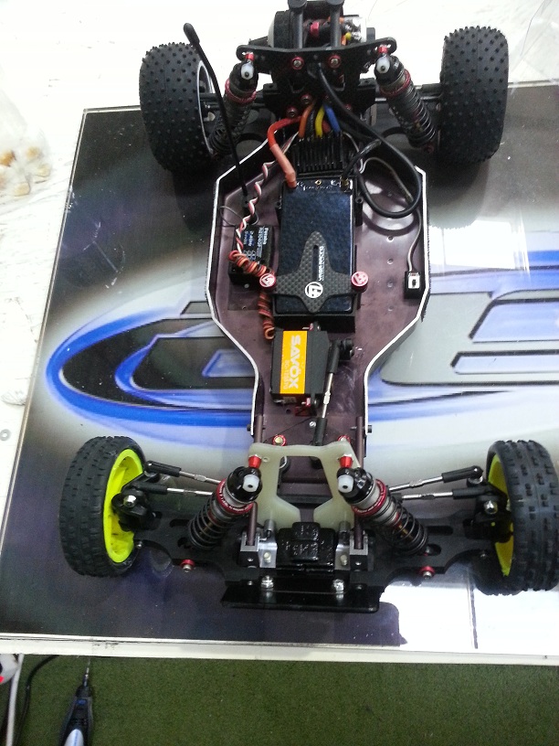

Have most of the parts now so did a bit of assembly last night to check how everything fits together. Front tower is one piece still missing so using a truck version for now....excuse the poor pictures from my phone.

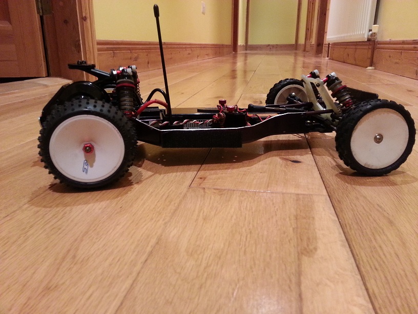

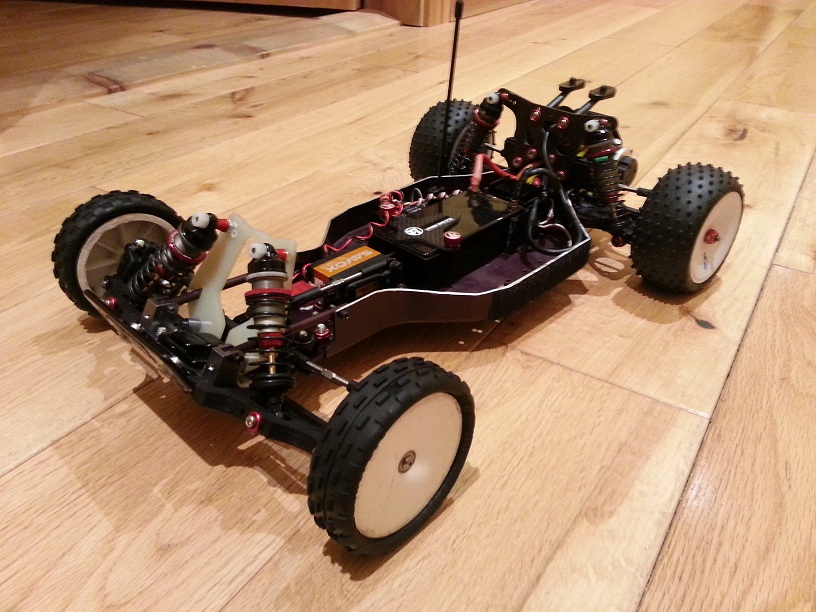

awsome looking car. the red looks great with the black. are those big bores?
Rayzerp
Posts: 58
Joined: Mon Nov 28, 2011 12:32 pm
Location: Kilkenny, Ireland
Re: RC10 "Infinito"
Post by Rayzerp »
Yep big bores....I thought the red would look good but am really delighted with it in reality. The intention is for this to be my regular race car so performance will be more important but looking good is ok too!! :D

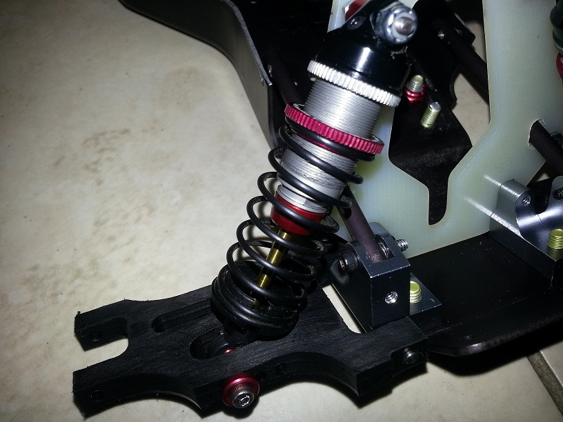

Did you thin up the rear bulkhead to make your inner camber link mod work?

rcgerber wrote:Did you thin up the rear bulkhead to make your inner camber link mod work?
No...I had to do a bit of trimming where the original wing mount tubes were but the alloy parts are bolted straight to the bulkhead. The tricky bit was to position the months to fit around the gearbox.

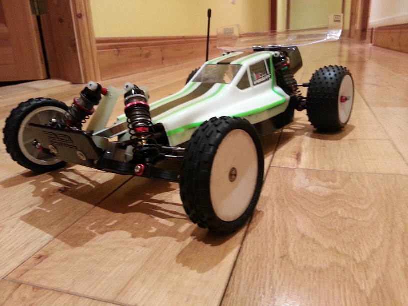

Post by Rayzerp »
Version 1 of this car was very quickly built up on Saturday to go to my first race meeting in 6 months on Sunday. Had to borrow a shell from another car and work with some temporary parts but I really wanted to check how the car ran in its current state as it is going to be my regular runner. My guessed set-up was a mile off and it took me practice and 2 qualifiers to get it dialed but after that the car was fantastic....finised up 3rd in 10.5 class behind a C4.2 and Cougar SV. Could have been better with a less rusty driver and had a few issues with steering ball-cups popping off which I think is due to the angle that they are running from original rc10 rack to B4 outboard parts. something to work on.
