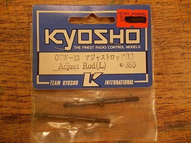

Notice the tie rod being used on the steering linkage to the servo (it does not go there). That is the OTW-11 S. I think the only ones that had that type was the turbo mid/custom/special and are hard to come by. 20 bucks on ebay for just one S and you need 4 short and 2 long (which you have allready in the front connecting your steering to your wheels to complete a set.
My best guess is that it started its life as a turbo mid, than it was stretched by an aftermarket kit, then swapped the rear shocks for the Associated rc10 shocks, then added the white lazer MA-17Hw or OT-121 wheels front and back and then the lazer body.

I think the turnbuckles were stripped from the Lazer, hence the missing pair on the upper front suspension links.

You're right about the stabilizers. You have a point there. Some of the parts should have still been on there. I went with the turbo because of the what looks to be the original fiberglass
shock towers front and back, and not an SE because of the gold shocks in the front. As far as the turnbuckles, the two front ones are OTW-13 Long, the lazer came with OTW-12s M as you
can see from the pictures.

The steering links look like the ones in the pictures posted by Optimusprime with the large hex in the middle, but the camber links are different, they have a smaller hex. I am definately thinking about getting the rere of the worlds car when it comes out. It will go good with my original, and then I can finally run a worlds car without messing up the original, brand new one.DennisM wrote:
The steering rods are most likely Kyosho - but the camber links at the back could be AE. Can You get a better picture from the back.

Many of those tie rods can be had for cheap by searching for Ultima RB5/6 and Lazer ZX5/6 parts. The stock turnbuckles are the same parts, just different part numbers (Thank you Kyosho for using the same parts for over 20 years!).Optimusprime wrote:Notice the tie rod being used on the steering linkage to the servo (it does not go there). That is the OTW-11 S. I think the only ones that had that type was the turbo mid/custom/special and are hard to come by. 20 bucks on ebay for just one S and you need 4 short and 2 long (which you have allready in the front connecting your steering to your wheels to complete a set.
