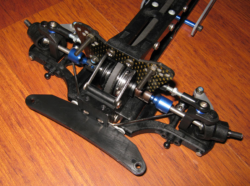

The front end has loads of carbon, alloy shocks, foam bumper, a swing bar, full turnbuckles, ball bearings, and a front one-way unit. The front one-way is not shot, which is great, as the KX-One's front one-way is notoriously fragile and might break in less than a single run. Note that the steering links don't use the traditional touring car system but are directly connected to the servo:

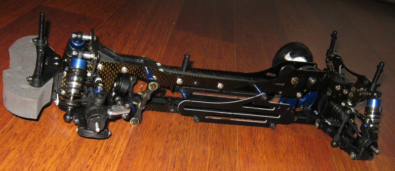

More carbon at the rear, which has very similar equipment as the front. The rear uses a ball diff. Metal motor plate with no fins:
It comes with full ball bearings, some titanium screws, and CVD-style universals on all four corners.

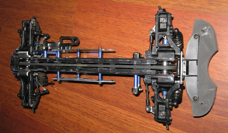

A look at the bottom of the car, with the single belt design having the belt run level with the bottom of the chassis:

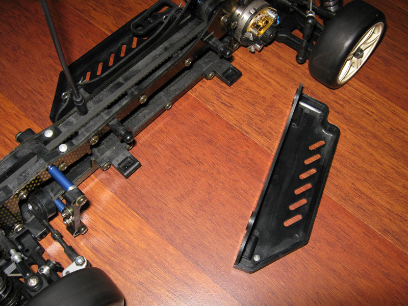

So where does the battery go in this thing? Well, the two bathtubs on the sides of the chassis can be removed, and the battery fits in the exact centerline of the chassis, in between the bathtubs. The bathtubs don't leave a lot of room for electronics. The steering servo fits into a frame just ahead of the battery location:
So yeah, "Beyond the extreme" indeed.
Removing both bathtubs gives the car even more of a classic Optima look:

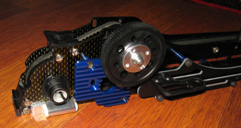

Then I installed the blue finned motor plate, 2-speed, and one of the racing battery holder side plates, as well as some other parts:
A better look at the rear, showcasing the alloy motor plate and 2-speed:

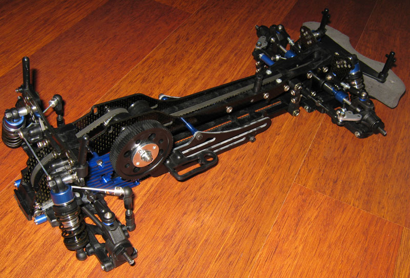

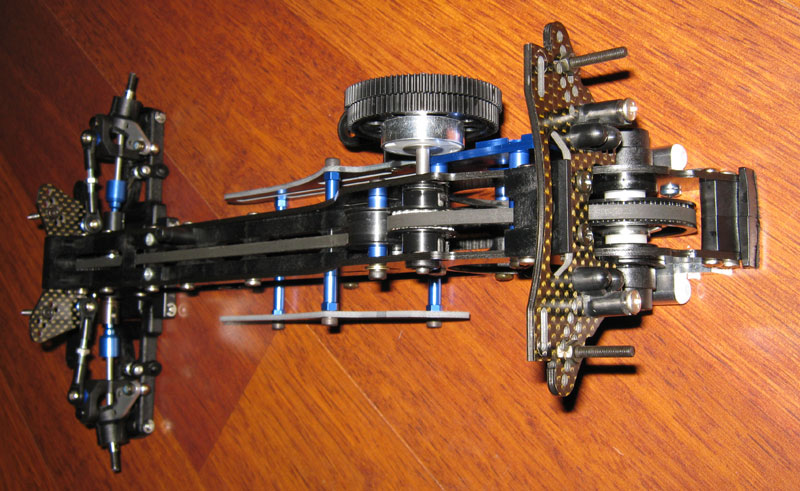

Next I assembled the suspension onto the car. The suspension arms used are those of the TF-4, which means they are hardened and virtually indestructible.

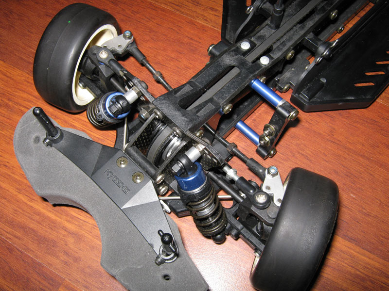

For the front end I chose to use Kyosho's one-way universals, which replace the dogbone part of the stock universals. These should prevent the front one-way from getting damaged too quickly. Each blue part contains a one-way bearing. If I had a second ball diff, I could also use these to have a ball diff and front one-way at once. On the picture you can also see the swing bar and the alloy plate holding the arms together and protecting the hinge pins at the front:
Overview of the chassis at this point:
Where the heck am I going to leave my electronics?!? There's only two very small plates to attach them to!
The rear end, with the alloy suspension mounts. These are shorter than the stock ones, and Kyosho did not include any shorter hinge pins, so I had to improvise using some blue chassis spacers. You can also see there's a spot for a belt tensioner just behind the layshaft:
Some pictures of the completed chassis. Narrow and little room for electronics. Did I mention that to replace the battery I need to remove 3 screws?:
(Hint: This is the bottom of the car :lol: )
The 2-speed instructions point out it should only be used with a 23 turn motor or slower, so I had a look at the 23T Atlas motor I got with it (seemed okay) and put it back in. The 2-speed should also only be used with a FWD-only ESC, and the design seems a bit more sane than Kyosho's Tour Force 2-speed, which lacked brakes :roll: . I wonder whether I'll be able to find a decent brushed miniature ESC nowadays...
