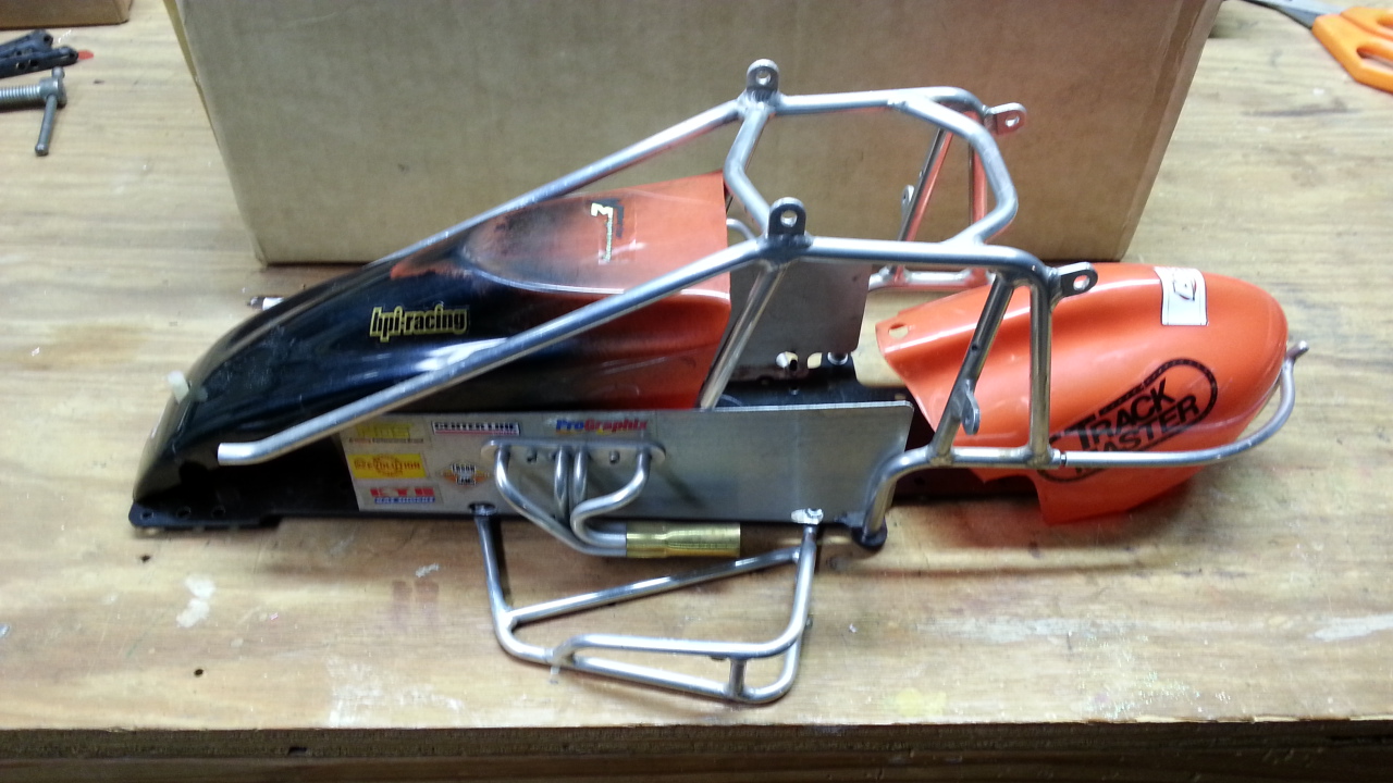

i got this from reggie sometime last year. overall it's in decent condition, though it looks like there has been more drill bits run through it than battery packs. :roll: :lol: i do hope to run this so i don't really care, if it was perfect it would never leave the house. and since i plan on using it, i'm not too worried about being all period correct with original parts.... some rere stuff is gonna be fine with me. even though i do have plenty of original stuff i could probably use.

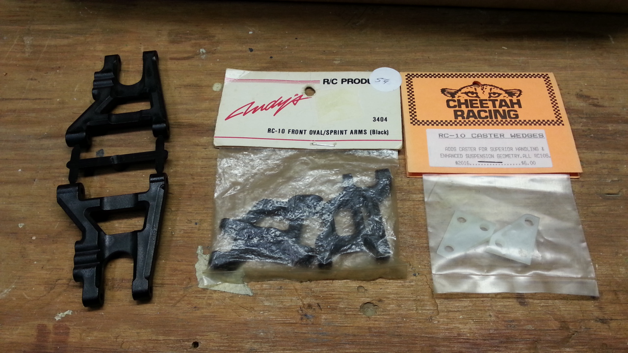

i do have some new andy's arms i may or may not use, but the cheetah castor wedges i pretty much have to use since the down tubes look to be shortened slightly because someone already had them on it.
just getting the thread started for now....... :wink:

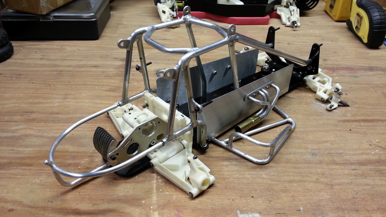

I started to spend some time getting this thing going. Not quite a roller but it's getting there.
I got some white 30 degree castor blocks from a parts truck, so i'm at 10 degrees with the wedges. We'll see how that works. I also got the holes drilled for a stealth, next thing on the list will be finishing the diff rebuild. I have a nice pair of uni's for it too. Gotta dig up some shocks as well.

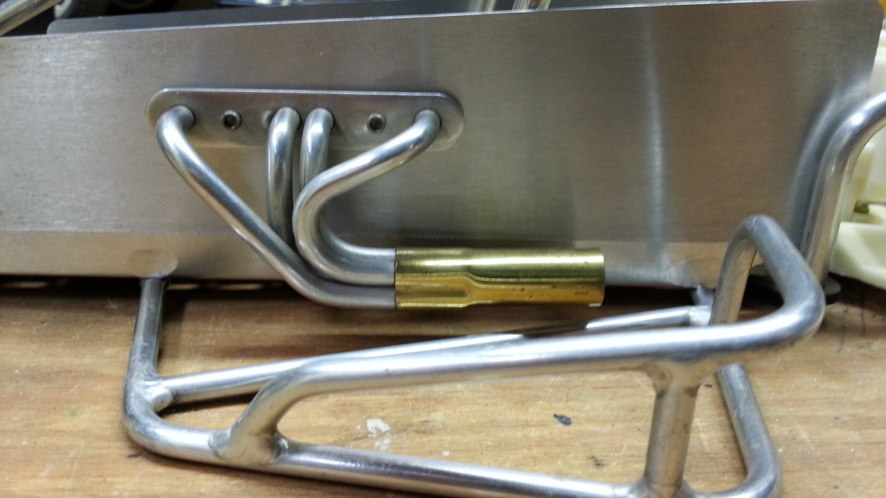

The original owner of this, I assume in an attempt to gain more track clearance, opened up holes in the side panels and ran the bars through it. He also mounted the side panels to the top of the chassis and they should be on the bottom. I thought about making new ones, but I just covered them with a strip of metal tape. It disguises them good enough for now. :wink:

this is a cool project. I like the welds on the chassis

the chassis on these are flat, so it will obviously have zero degrees of castor built in. the cheetah castor wedges gives it 10 degrees of kick-up, so using a 30 degree block i'll have 10 degrees of castor. if i want more than that, i must swap the castor blocks left to right and open them up to regain full steering. with a 25 degree block i will have 15 degrees of castor, 20 will give me 20, 15 will give me 25, 10 would be 30.
i'm not going to really know anything until the turnbuckles are all on and i can get an idea of how flat the tires will going through the turns.

How come you didn't go with the short andy's arms?
