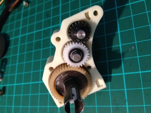

Hi everyone, this is my first post. i most actively in RCtech. I found this site after getting a rere worlds car and ran into the stealth meshing problem like most. after reading all the post, i realised i wasnt the only one and my top shaft is also too short. luckily i didnt have any cvd issues.
The meshing issue was driving me nuts, as there is no way it could be run in. I spoked to a few of my mate who is actively racing in Aust to see if i could find someone to make me a new idler gear. And one of them refered me to a fella in UK.
after describing the issues of the stealth gear box and giving the specs, he was able to make me a new idler gear. and the result was a miracle! the new idler fitted perfectly and i dont even have to change ratios.
i am so excited i wanted to share this with you all. i know this is the solution we all been waiting for.
His contact details will be posted as saon as i have his approval in the next day or so.
and here is the pic of the idler gear.

only one thing comes to mind.....$$$RichieRich wrote:Nice. This makes me wonder why AE is not replacing the idler.
