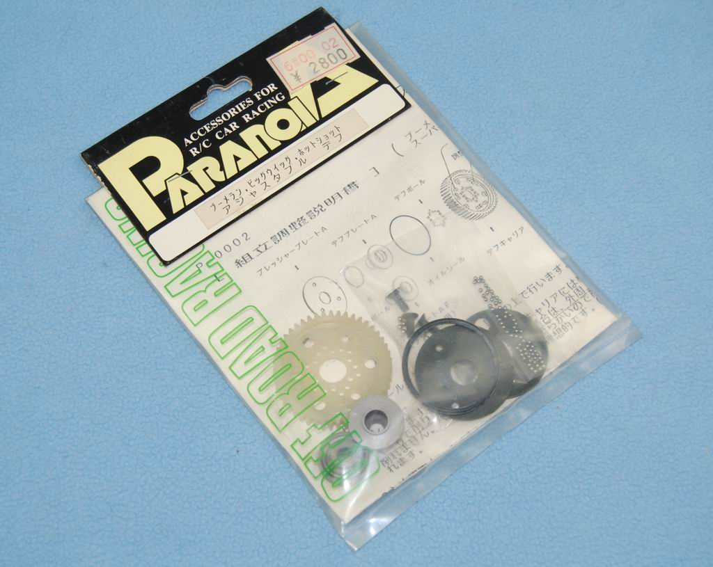

I ever have the thorp hotshot ball diff , yes the out drive is slot to keep the swing shaft.
another special diff I still keep new in pack. PARANOIA super ball diff, can you count how many balls it have?
