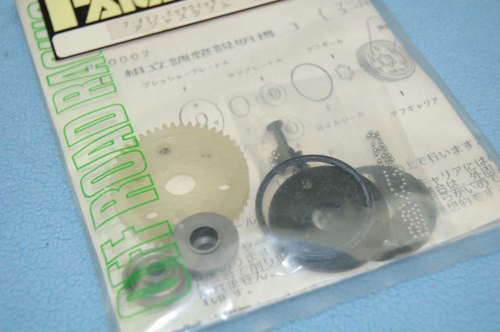

I ever have the thorp hotshot ball diff , yes the out drive is slot to keep the swing shaft.
throp tamiya hotshot supershot boomerang bigwig ball diff excellent condition 01.JPG
another special diff I still keep new in pack. PARANOIA super ball diff, can you count how many balls it have?
PARANOIA thorp rear super ball diff for tamiya hotshot supershot boomerang bigwig 01.JPG
PARANOIA thorp rear super ball diff for tamiya hotshot supershot boomerang bigwig 02.JPG
