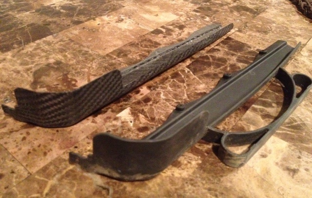

I made a vacuum mold to make carbon sides to my losi scte. 2 layers of carbon sandwiching a layer of Kevlar. Holding up very well.

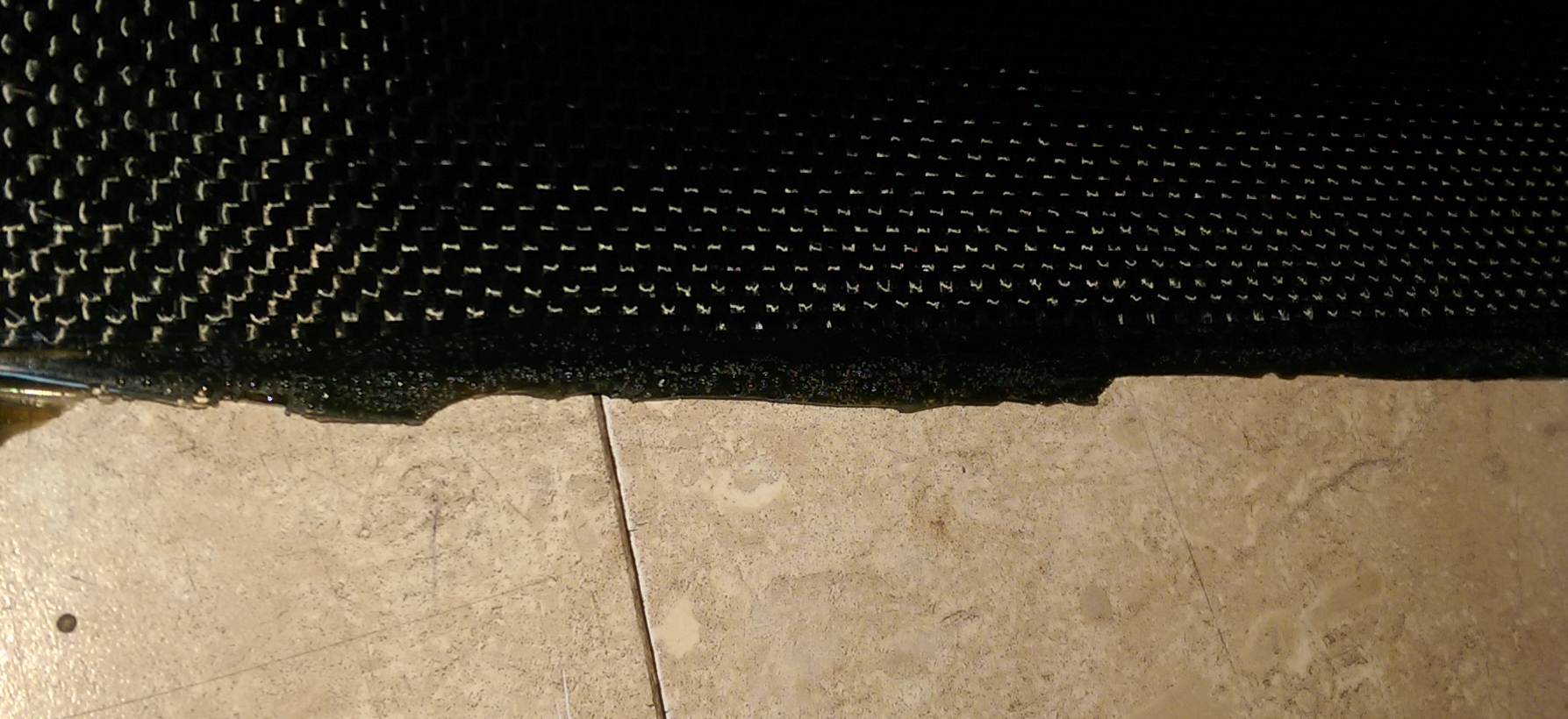

The widest pan car I could find in my stash is 7" wide, an inch wider than any off-road I have seen. So at 7", how much area would you need around that for a buffer? I know my DA material has about 1/2" of unusable material on the outside. The carbon is wavy and sometimes it's just epoxy. Maybe that's not normal tho? Anyway, I think at 10" wide you would be wasting material. I would go 6" usable like composite craft or 12" so you can get two or a pan car. For length, I think 16 would cover most any 1/10 pan or off road
