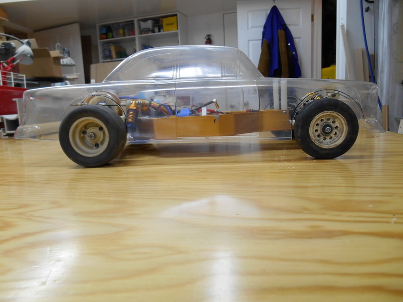

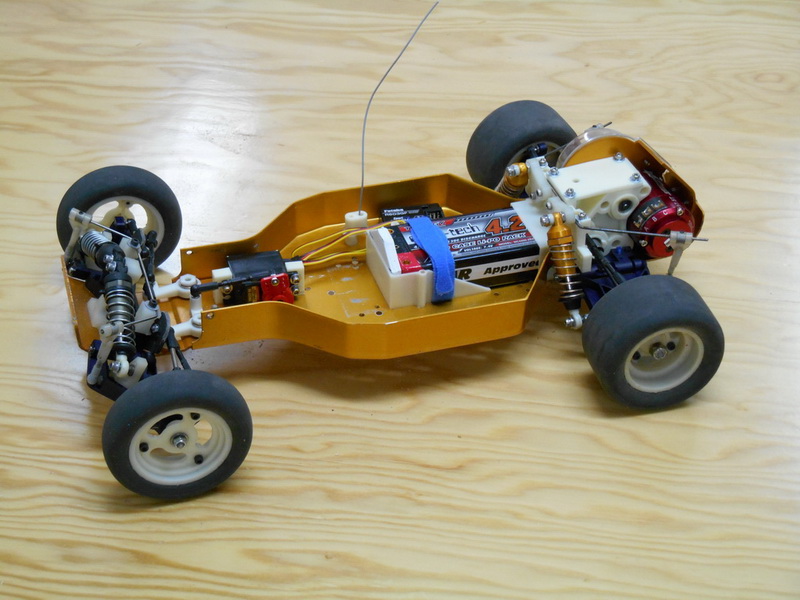

Here is a pic of my build so far. The original RC10 had the spiked tires that made them about the same size as the fronts, but without the spikes the rears are smaller than the fronts.

I think it looks awesome as is. What tires are they?

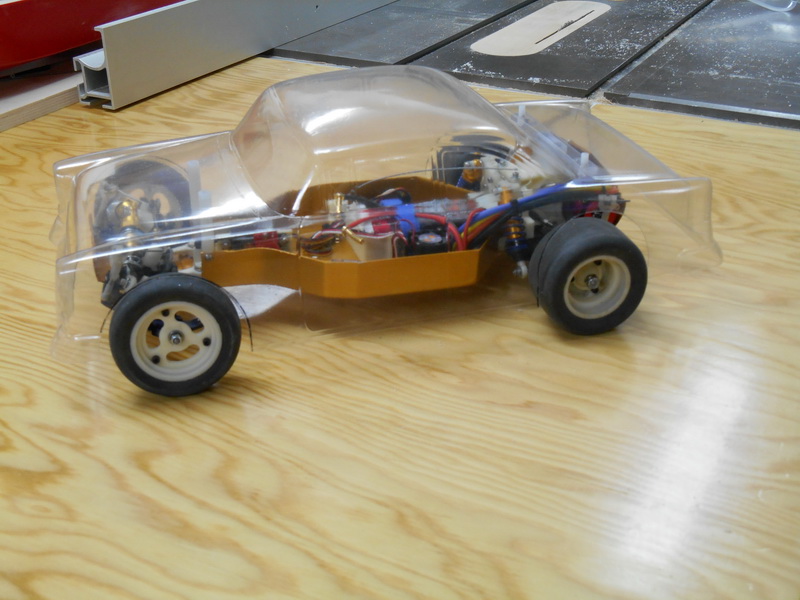

Those are tires from Duratrax back in the 80's. You can tell from the picture that the wheels are original. Perhaps this photo can give a better view as to why I would like to go with smaller fronts. They don't have to be imperial measure as I have a lathe and can turn adapters for the bearings if need be.
