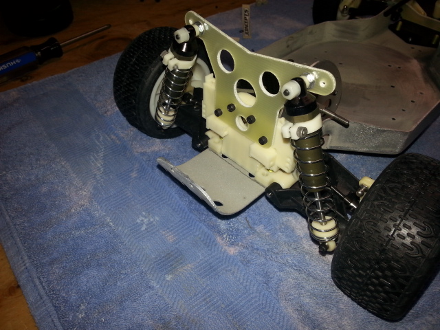

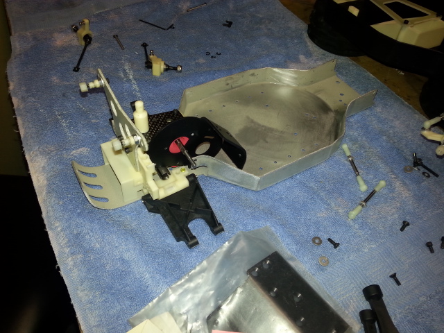

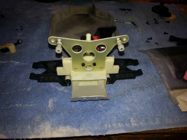

Since its going to be awhile until I can get electronics for my team car I'm going to mock up a mid motor car on a spare chassis. :D

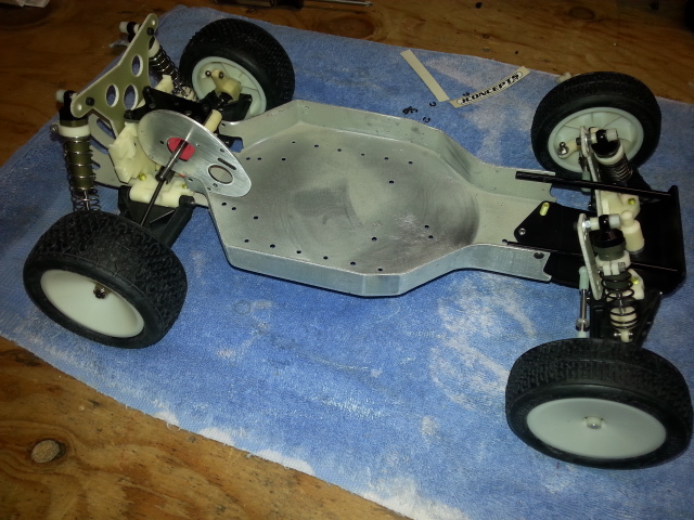

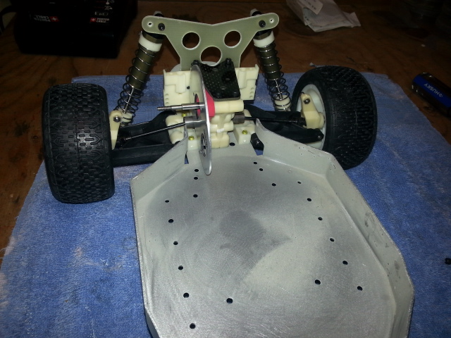

Got a little more done today! Still deciding on what i want to do with the back of the chassis and bracing the chassis.
