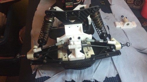

Building Brian’s B1M conversion kit. Which arrived superfast from the States :D maybe be the 1st in the Uk ?. first thing I will say it’s not a shelf Queen . So its not spotless it gets raced . I mess about and change set ups a fair bit . Car for the conversion is a worlds rere , and now has a carbon works chassis .
How the car looked to start .

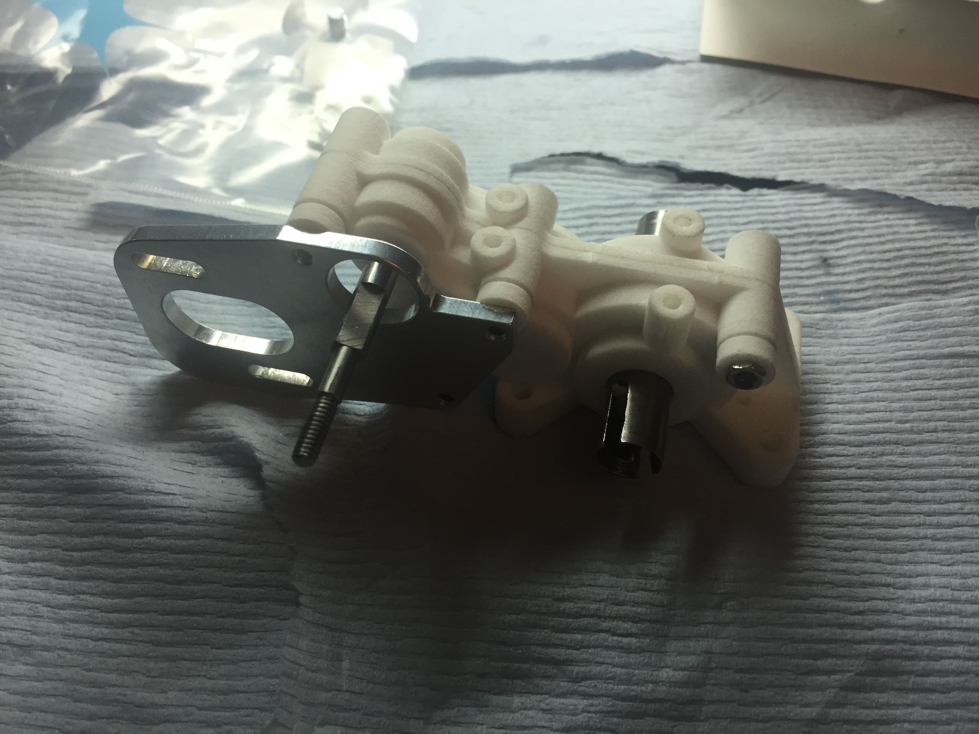

Going together great .can see the tool I used to help push in the bearings on the right . That bottle of tri flow oil is 30 years old ! Still great stuff . Each bearing had a drop

Next gearbox half’s come together , there’s a small gap when you screw the two half’s down the Center . But once the motor plate is fitted that was gone .Made sure not to go to tight on the 4 gearbox screws

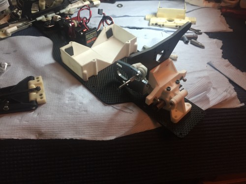

Bit more done,test fit of shock tower kit fits together really nicely .

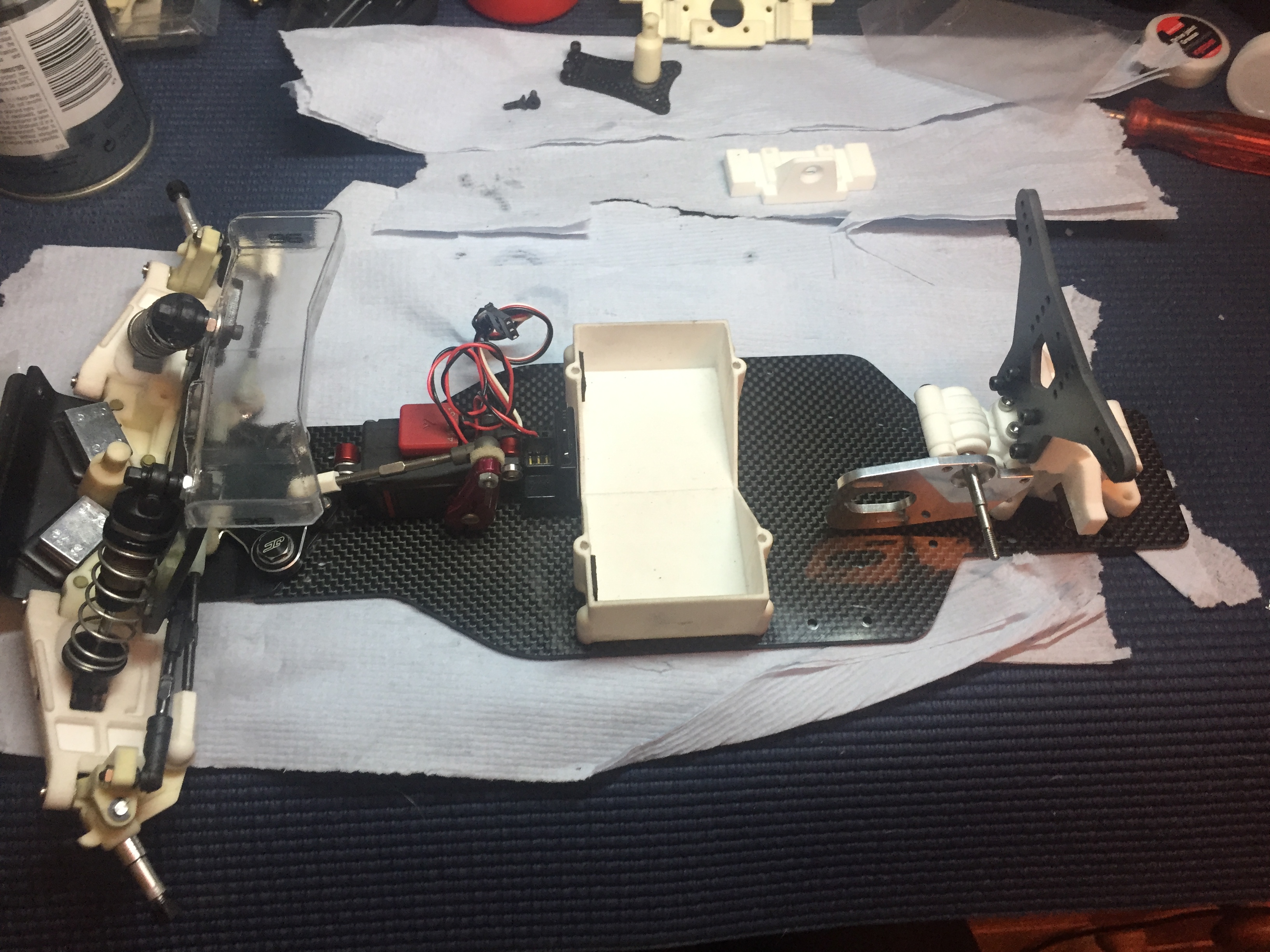

And there’s more :D

Front arms are shapways , which increase the car length 5mm .going to put the rear Arms for long wheelbase to start and see how it goes .

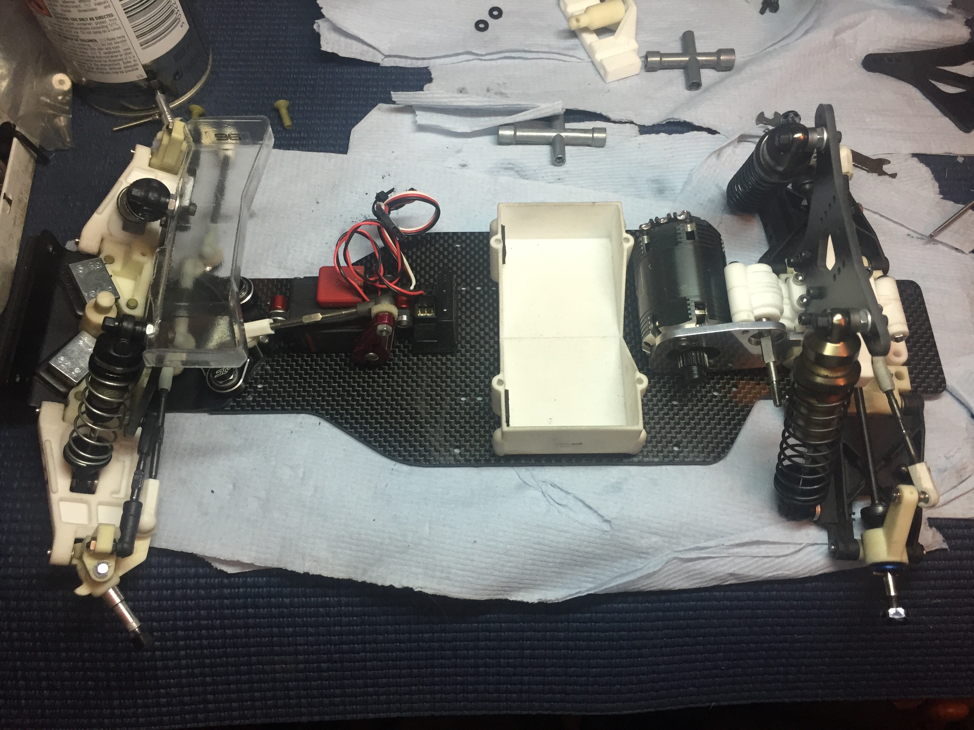

Rear dampers are Kyosho RB6 big bore 30w oil .front Standerd Worlds dampers 32w . Esc is going to be a hobbywing 120A . Steering jconcepts , futaba bls551 mini servo . Motor LRP 7 .5 x20 which is great as long as you can keep the front wheels on the deck :mrgreen: lipo team orian 110c 5000 .

Rear end .
