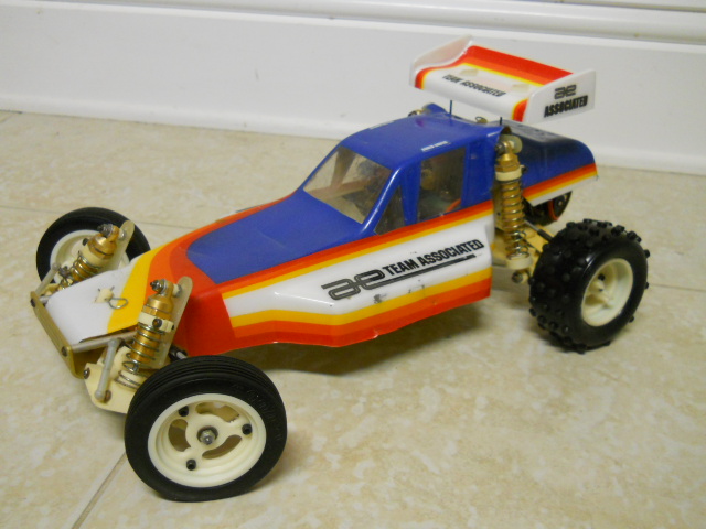

Re: edinger early no stamp light resto
Post by hugger19 »
got it back today very happy. since the chassis was in bad shape since some else srtipped off the anno already don said they didnt do a great job so he spent some time getting it right, but wasnt as perfect as he would have liked. if he would have stripped it, it would have come out a lot better. i have to say iam happy with it the light gold looks close to orginal.

all put back together. very happy to own/restore this early no stamp.

Very well done, I also love the body!

its a curtis husting painted orginal thick lexan body :D

hugger19 wrote:its a curtis husting painted orginal thick lexan body :D
Lucky! 8)
If those are rub marks on the inside white paint, you could just gently clean the inside rub section with a Q-Tip and lacquer thinner. You may end up removing a tiny bit of paint as well as the grime. Then touch up with Parma Faskolor white. An airbrush would look more original but a paint brush for small touchups looks fine. It will look good as new on the outside either way.
