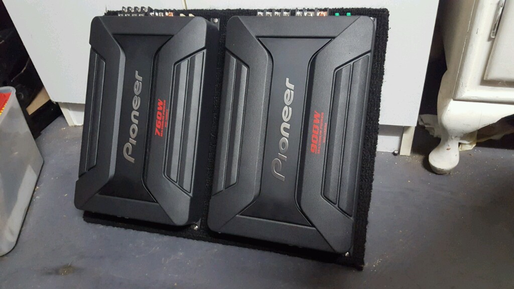

I figured out what to do for amps
4 channel amp (760w Max)
Channel "A" to front speakers (60w RMS each)
Channel "B" to rear speakers (60w RMS each)
2 channel amp (900w Max)
RCA split off "B" to power sub (450w RMS bridged)
Both amps will match each other and I'll make a nice board to mount them to.
The sub is rated at 1300w max and 350w nominal. By keeping the gain low will this be safe for the sub? Will the sub overpower the rest of the system?

I made up a board to mount the amps which came out pretty good. I'll get my sub monday so all that's left is cabin speakers.

Well, today I ran all of the cables neatly under the sill panels in a cavity. Unfortunately the RCA cables and speaker wire were too short, so I'll probably have to make my own RCA's and splitter extensions to get the right lengths. I'll also have to buy more speaker wire
I was hoping to put the back seat and carpet in but that will have to wait.
Wrestling and feeding the 4 gauge power wire under the dash was a bit of a challenge, it's some pretty thick cable. I like the fact the wires are hidden as it looks pretty factory.
