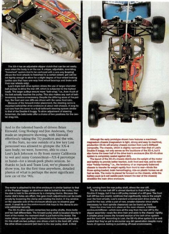

Mostly the ground clearance (due to the small size of the diff pulley), long suspension travel, and weight distribution with the saddle packs batteries at the back of the chassis and the motor mounted center line in the front of the chassis are the two main reasons the car ran well.

Some interesting pics on Oople XX4 vs some other 4wd cars: http://www.oople.com/rc/photos/reviewxx4/page9.html

Post by FasterLouder »
Yep,suspension geometry.
It uses the XX CR rear geometry that was well proven and had all the bugs worked out by the time the XX4 arrived.
And,yeah-Gil Jr. designed it!
Ever seen the magnesium chassis prototype?
It's wild!
