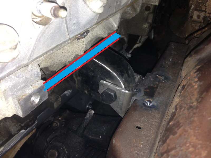

Waiting on material for the floors so I thought I'd kill some time on what I could. What a pain this exhaust is going to be.... I'm starting here cause the 1.75" pipe are still on back order. And I kinda need to know where I'm going before I start. So here is the start of the 3" that the headers will exit into. I'm going big because this engine will get an overhaul someday.
Its going to be a tight squeeze.
Here is my crude photobucket drawing to explain what's going on. Ill start on the drivers side.
Blue is the header, red is the crossover pipe to the passenger side. 1.75" primaries exit into 2.5" header, 2.5" crossover pipe.
Crossover will go under the crank pulley and tie into the 3" pipe I made tonight.
The passenger side is a little harder to show what's going on. Especially in my junky drawing. The header will exit down right behind the rear of the engine mount into a flange I will be putting into the top of the 3" piece.
I would have liked to gone traditional headers or cast manifolds. But there is no chance that's happening on this car. Once its all finished up ill Paint them, maybe wrap them, and wrap the starter to keep the heat in check. Unfortunately I'm now on hold again until I get the rest of my order.
