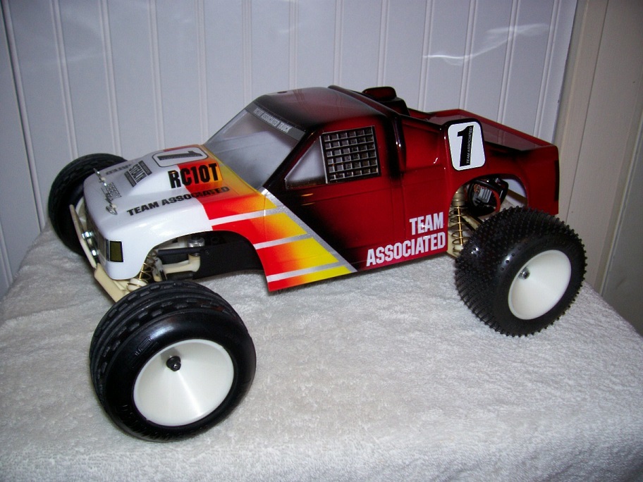

Anyone have a pic of the rc10t team truck from the catalog that came with kit. Looking to paint that body but can't find the pic. The back of the body is maroon and the front is white with orange to yellow shaded strips if my thinking is correct . Thanks dave

Thank you scr8p for the fast reply . That is what I needed. Dust off one of my Mr Lexan 10t bodies and I am good to go.

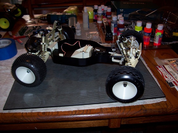

Finished up the chassis and trimmed the body just have to paint it. Restored the chassis using the team manual via the " The History Of The RC10T. I used a rerelease pan and rear bulkhead to run lipo and back ordered from tower the white 30 degree caster blocks. Also went with MIP T4 cv shafts and added the 1/4" axles to run the stock one pieces rims. Still looking for the correct narrow body . The hard part #6372 for me where the spacers under the trans brace . #6372 shows up as the spring and spacer for the rc10 dog bones. Ditched the spring and used the white spacer for the trans brace.

Re: RC10T Team truck
Hi Dave,
Team Associated had a bad habit of recycling parts numbers and also changing white parts to black
without changing part numbers.
You can use these washers as spacers under the trans brace,
http://www3.towerhobbies.com/cgi-bin/wti0001p?&I=LX2847&P=7
How is the plunge of the T4 cvds when the suspension is compressed?
Cheers, Dave.

I have to correct myself. The MIP CV's are the ones for the T2 #1082 just added the RC10 1/4" axles.
I believe it's sliver that fades to white.
With Losi wheels:
With Losi wheels:
Nice paint . Hope mine turns out like that. Hard to see the silver to white shading in the add pic. Thanks for the info.
