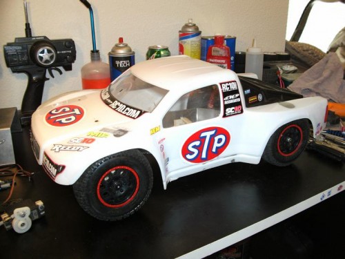

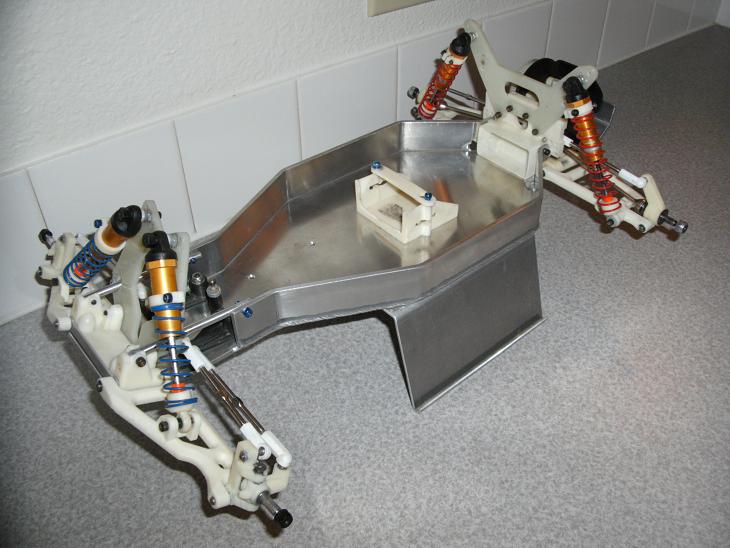

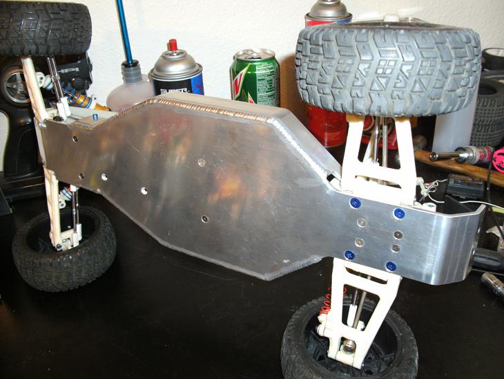

almost done converting my rc10t to a short course truck. i made an aluminum chassis from scratch, a little thicker than stock, and as long as an sc10. its a little heavier but that should work out good my sc10 seems too light anyways. im planning on making it possible to move battery location forward and back like the sc10 for weight placement. everything matches up great with my sc10 stuff. now all i have to make to finish it is body posts and bumpers. i tried to keep it old school style but custom with the tub chassis status. i cant wait to go out and beat new trucks with something almost 20 years old lol.

First off that thing is AWESOME. Second nice welds. You gotta post videos of it beating other trucks. That would be funny.

That looks Sick!!! Nice fabrication work

Very nice work. I'd say someone has a bit of welding experience.
BTW, what is the wheelbase of that truck?

Roll-o-nickels, penatration? Too hard to tell from the pics.aeiou wrote:I'd say someone has a bit of welding experience.![]()

wheelbase is about 12 7/8'' with the suspension topped out. i added 3/4 inch over the stock chassis. also ide like to point out it is one piece vs. stock 2 piece. this will also help rigidity and screws cant come loose thus making the chassis loose.
