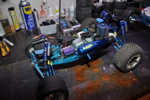

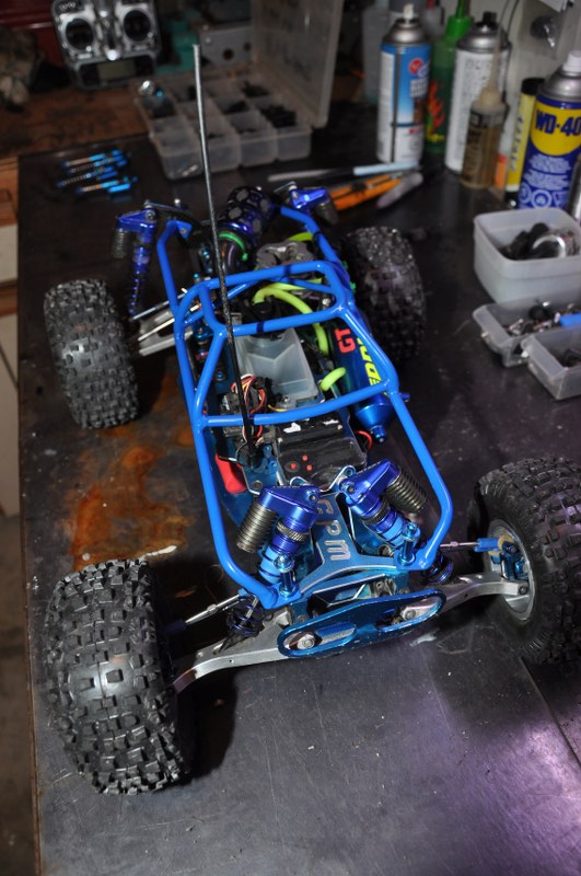

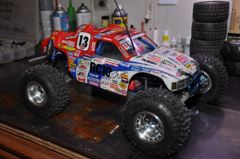

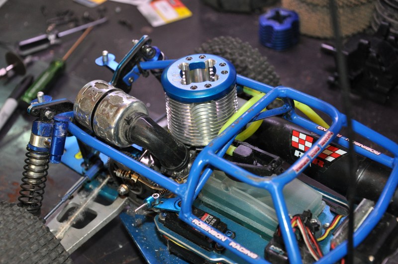

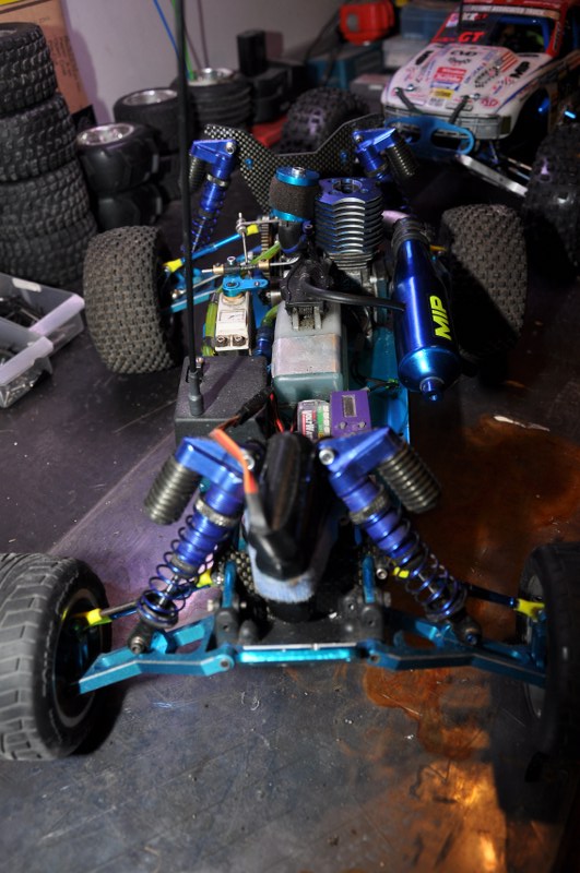

Hi there guys,
im just poking around here, looking at other guys RC10GT's, and thought id chime in.... First a little bout myself. Im mostly an RC heli guy, with all kinds of high end 450/500/550 and 600 sized brushless heli's, and starting to do the multirotor thing. I have a killer catamaran brushless boat I run on 8s as well.
I havnt been into the buggy/truck thing too much, but have a couple RC10GT's, and a couple OFNA Ulta buggy's. Now my Son is bugging me to convert my RC10GT's to brushless. I have a nitro one that i ran myself years ago, and was starting to build one up for my son. Its just a bugger to keep the nitro units running, and a real pain IMO. My son is 12, and it would be nice if he could just plug a pack in and run his truck.
Im looking for some advice here as to what size motor and ESC would be the best for us to use, and with that in mind. I have a dozen or so 2200 mah 3s lipo packs I want to use up with these trucks, so, they need to be able to use 3s as their power source. I have a spare motor here from my boat, that I was considering using, but on second thought, it would be WAYYY too much power for the RC10... its a 2075 kv brushless... more for the 1:8 Ofna 4x4... thats for another day.
I would like some idea's on the motor specs I should be looking at running. I dont understand the whole (T) rating thing... ie:17.5T etc.... Im prolly going to be ordering from hobbyking, so maybe someone can pont me out to an esc/motor right from there? I have bins and bins full of spare parts, and pinions, and will prolly order a bunch more gears. I plan on running the stock main gear, and slipper clutch. I bought a couple cnc made RC10GT brushless conversion plates, so the motor will attach right to the transmission, proper like, to avoid frame flex/mesh issues ive heard about from using DIY mounts.
so, with that all said, here is a couple pics of my truck, just the way it sits with the nitro motor still in it.... Ill start tearing it down shortly, and get ready to do the conversion. Ill take some pics of my Sons shortly, and add them in here soon. for now, here is mine. lmk what yall think! and any suggestions/info is greatly appreciated! and BTW, winter is just about upon us now, so I have all winter to do the conversions. theyll be ready for next spring/summer!
TIA,
Doug (ginnz)

Re: My RC10GT to go brushless
so no one had any suggestions as to what motor and esc I should go with??

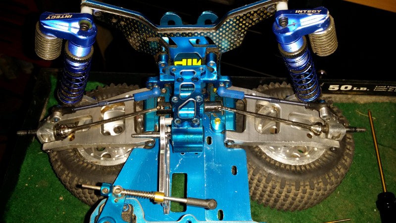

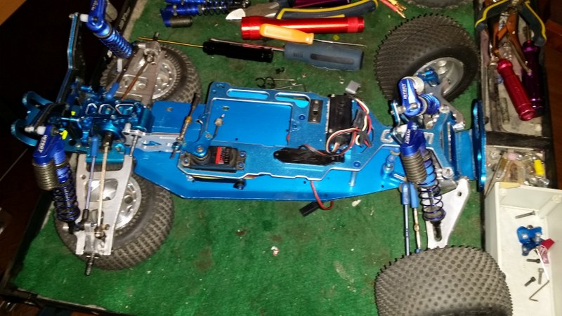

thanks for the reply. i'll add, money won't be an object... and ive been looking around at my options on flea-bay,and i just cant figure out what ill get. I mean, there are 6090 kv 5.5T, 7323 kv 4.5T, 3254kv 10.5T, 4370 kv 9T (you get the point)..... there are just too many choices. And I do NOT understand the whole (T) rating?? I get the KV thing, but whats with the T rating, and what should I be looking for in this in a motor for offroad bashing in the RC10GT?? My Sons truck will be quit a bit lighter than mine, so I may look for something thats not quit as extreme power wise for him, and it may be a good idea that i get something tamer for him, as he is quite young and doesnt have much experience... I want to build him a controllable rig, to learn and build confidence on.
My truck is quite a bit heavier, with the cnc aluminum wheels, and roll cage. I may also figure out a way to keep (part) of the second level deck, for battery retention, and to add stiffness to the whole rig, I dunno, it may just go though. So im prolly gonna put the sickest motor/esc combo in mine.
im also looking at ditching the dog bone drive shafts and looking for a better rear axle alternative to our rigs. I remember having issues with the dog bones popping out. I think there is an axle swap available? Im looking for the best, strongest, toughest alternative!
So, with all this in mind, if anyone out there has any more suggestions, and if someone out there could please explain the whole KV to T rating thing, id appreciate that as well! And oh... yeah, I received my aluminum brushless motor mounts today! and they are the typr that attaches directly to the transmission, perfect! Im running the aluminum transmissions in both rigs as well, so it will be tough enough to handle alll the power i can through them!

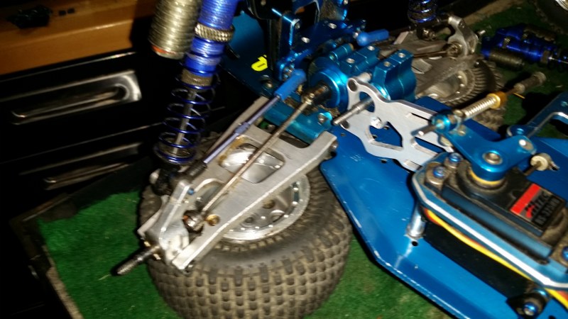

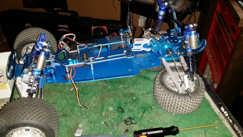

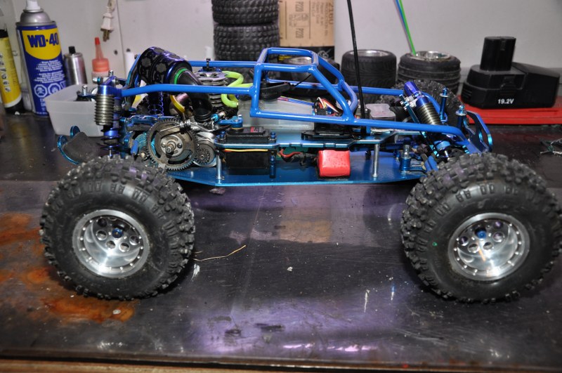

here are a few more pics of my rig..... as is, now.

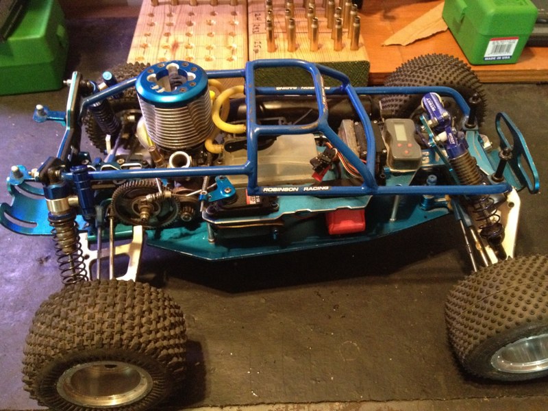

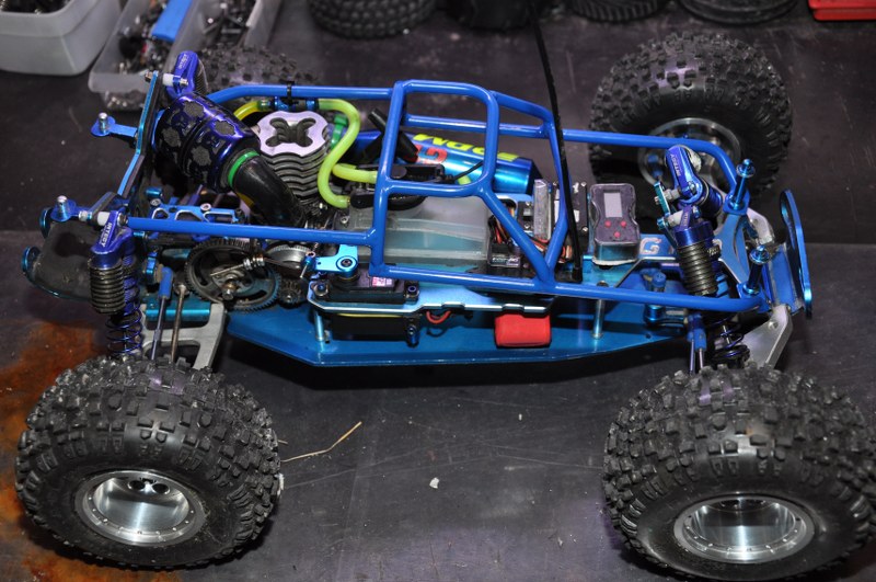

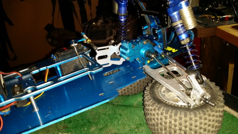

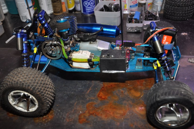

And, here are a couple of my Son's frame, this is what i have to work with, very similar to mine, minus the second frame deck, and roll cage. He has different swing arms, and shock towers as well.... Otherwise, basically all the aluminum upgrades are there too. When i'm done, these rigs should be real head turners, and a blast to bash around with!
Yeah, there should be some info in the tech section I posted about the brushless stuff. The T (turn) rating and the kv was always a confusing point to me too. Why not just keep it all the same to make it easier but thats just my whine.
As far as getting rid of the dog bones thats an easy one. Get some MIP CVD kits for your gt's Depending on what you have for axle sizes anyway between 3/16" or 1/4" drives. Not sure what you have in yours. Willing to say you have 1/4" in yours yet which wouldn't be too much of an issue but since you have alloy wheels and pry want to keep them you'll have to figure out what you have. Otherwise you can pick the CVD kits up off ebay and some online hobby shops pretty affordably yet.
Do some reading in the tech section and you might find some stuff you are needing for info. Good luck and hope you figure it out.

Well, i'll be. I just dragged then trucks inside my office and got them on the bench, i thought id start tearing them down, and low and behold, ive upgraded the driveline from the dogbone's to the CVD setup already! And going the the multiple bin's of parts, I have two complete new bearing sets, new tranny gear sets and another couplebags of MIP CVD rebuild kits. man, I have parts. Im looking Integy shock rebuild kits, as a couple shocks seem blown, as the damping is non existent. They just spring. i replaced the oil, and it didnt help. Maybe ill just source out some new big bore shocks. The ones I had on my Xray 808 sure were nice!
well, andyways, thats enough for one day. Now I guess ill break the bank and get the power systems. I wanna build the sickest, most rippin' truck! Me and my boy have a great place to build a small track right off our yard too! Its got natural terrain for some nice jumps, and some nice straights. Gonna be a blast!

Heres a little update. Ive stripped all nitro stuff from the chassis and started to fit the brushless motor adapter plate to the transmission, because im using the aluminum transmission case, one of the stand offs used to attach the plate needs a little modification, no big deal, i just need to do it. And im thinking of keeping the top frame plate that houses the steering servo. Im just going to cut it down a bit, and reshape it as needed. The ESC should dit under the front, kinda protecting it, and the battery's may be held in some how with it, im not sure yet. Im starting the conversion on my truck first, and my Son will do his this winter. Im going to get him to do it himself, with my help. If he wants to "play" with this hobby he needs to learn how it all works, and be able to fix some stuff himself. Itll be a good little project for him to learn on! Anyways, here are the pics...
