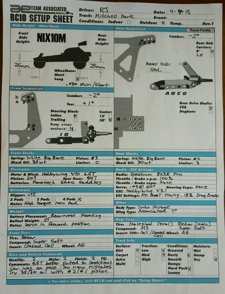

The inline servo free's up a bit of chassis room, but the main reason is to keep more weight over the front of the car to better distribute the weight front to back.
The reason I asked if you noticed it jacking a rear inside tire in a turn is that in testing it was apparant that off power the car transfered too much weight on the outside front causing the inside rear to lift off the ground with stock arms. Moving the shock in on the rear arm allowed a better balance of weight transfer keeping more more weight back. Niki's ROAR 250mm width front arms have an added third shock hole (one more out from stock) for added tunability.
The car was dynamite on med grip dirt with 2mm carbon chassis, I think being slightly narrower then the modern buggies ultimately gave it more grip overall. I'm keen to hear what set up you end up with.

Ran the car on an outdoor dirt track yesterday :) - oh how I miss nice outdoor tracks.
First test run, I thought I had the wrong tires, rear shocks in outer lower holes, car would snap/spin, no warning. Back to the pits, rebuilt the shocks, putting a limiter inside so the CVDs dont pop out, changed tires (that I had just ran on my re-re Worlds, worked perfect), moved the shocks in one hole on the rear. Droop looked perfect, but on track, exact same problem. Coming out of a corner (180s, low speed) start getting on the throttle (yes, slipper set correctly) sometimes perfect, other times it would swap ends like no tomorrow. No slight slide, just bam and I was pointing the wrong way.
So tuning is needed. Rear pack needs adjusting, I have #1 pistons, 30 wgt, green springs. Feels light. Outside of the snap spin, the car jumps fantastic and turns pretty good.

Post by RC10th »
Interesting, I haven't run the alloy chassis yet so I can't comment on its performance, but with carbon chassis med-grip it would not spin out.
Do you have saddle packs to try?
Here was my set up (carbon) Oil or piston were too stiff but otherwise car was great....
