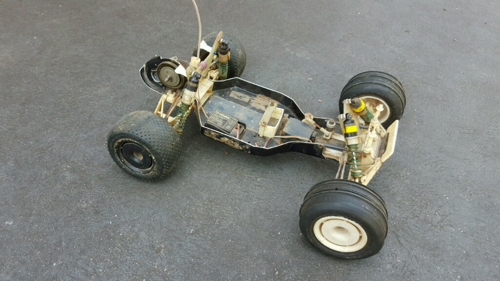

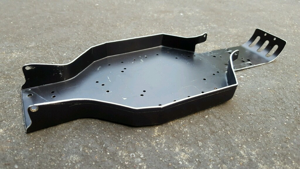

My friend is doin a rc10 build and the chassis is a bit bent. were debating how to unbend it. bit pushed up in the front,bit in back dent on the motor guard. ya know basic used rc10 issues(got a few rc10 chassis that can use some help too).think people posted about this in the past but i could not find . please post any ideas,pics, past pics, or past topics. thanks

I sandwiched the nose between two pieces of 2x4 and while standing on the wood using my other foot to gently bend the chassis back by standing on it. I didn't just reef on it in one go but sort of bounced up and down on it varying the pressure and checking progress as I went. It looked scary the way the chassis was bending but you'd never know when it was done. I also checked for straightness by rocking it front to back and corner to corner on a piece of glass.
I've posted these before in another thread but this is the same chassis before and after, it was bent similarly to yours. After about 30-45 mins is was dead straight.
You can really see how bent it was....

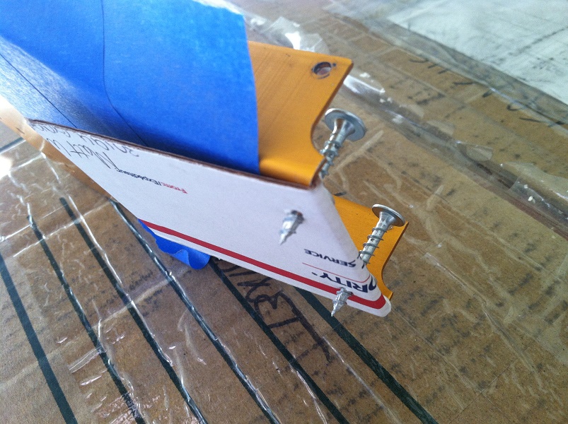

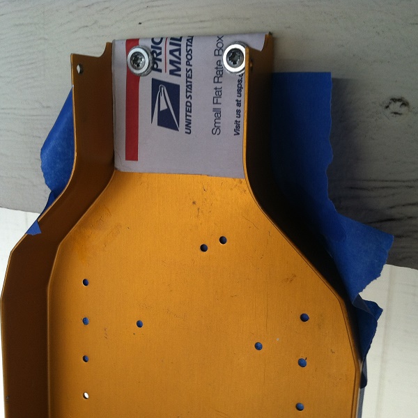

This worked for my re-re chassis, There is a perfectly fitting block in the front, bolted in place with the nose tube holes and nose plate holes to keep the sides from opening.

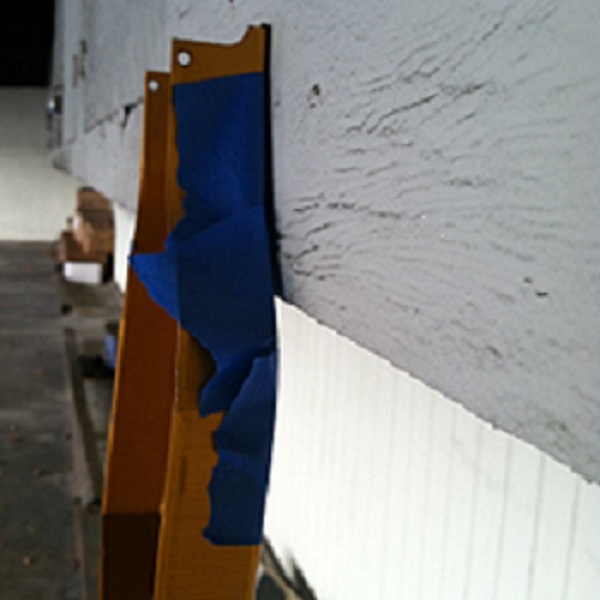

Re: How to fix bent rc10 chassis????????????

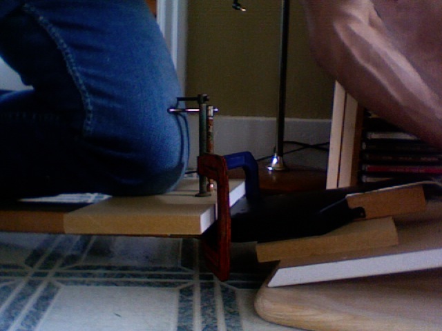

Simple method I use that allows you to apply smooth even pressure. I use two sets of mounting holes to even out the pressure and I don't worry about the sides. Nothing was holding the sides when the chassis got bent. Don't be in a hurry and have a straight edge to constantly check your progress.

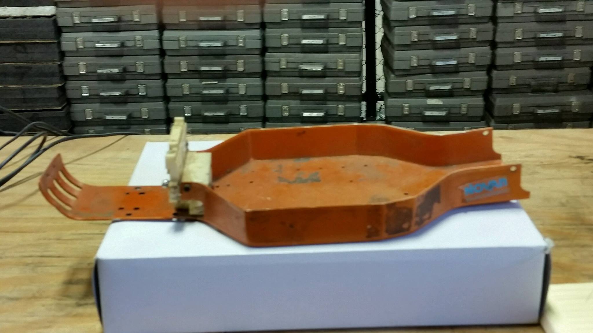

I do it just like rc10resto, on the edge of my work bench.
