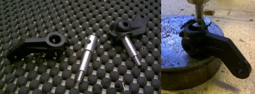

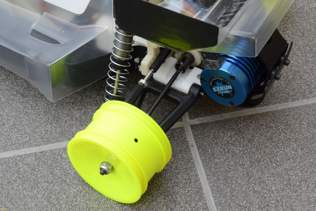

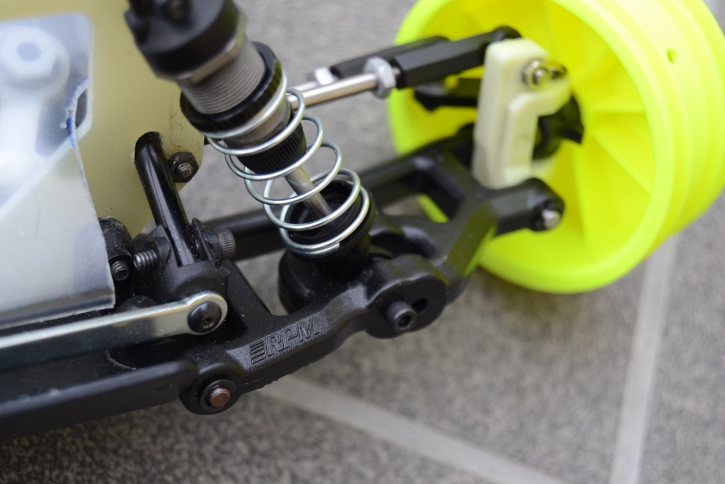

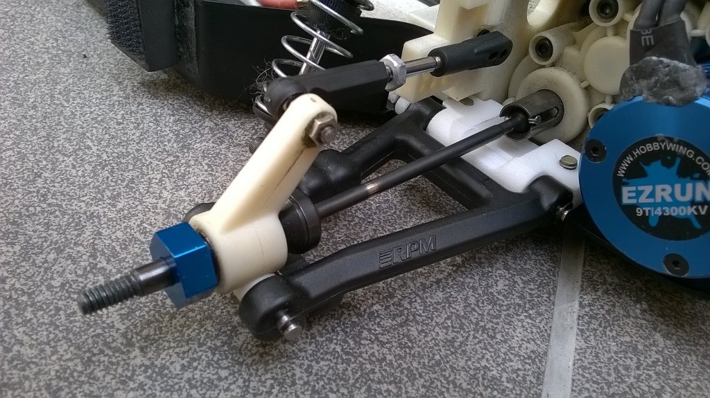

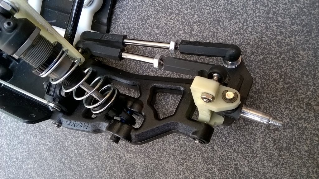

PARTS:
Front end:
-10T kickup ASC7305 and bulkhead ASC7207
-Inner hinge pin ASC7209
-Front arm RPM80492
-Outer hinge pin ASC8423 or ASC7357
-Caster and steering block ASC6210 + ASC6225
-T3/B3 front axle ASC7221
-B4 Front wheel ASC9588 or ASC9688
Rear end:
-Inner arm mount "RPM73282 Arm Mounts 0-1" or "RPM73282 Arm Mounts 0-2" by NIXconcepts
-Inner hinge pin ASC6380
-Rear arm RPM73282 (inbuilt 3deg toe-in)
-Outer hinge pin ASC6381
-Rear hub ASC7364 for 3deg/side toe-in
-Rear hub ASC7367 for 1.5deg/side toe-in
-B4 CVA/CVD bone ASC9672/ASC9597
-B4 pin or hex wheel
Front end:
-Front arm RPM80492
Rear end:

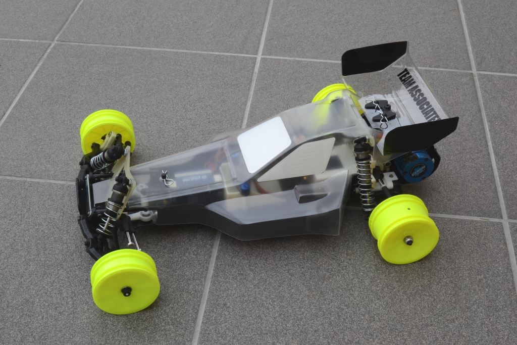

Re: RC10 buggy with long RPM arms
RC10T? If so, get a taller front shock tower, and longer front shocks.
You can see he already has the RC10T front end.

Looks good. Nice repurposing of RPM stuff

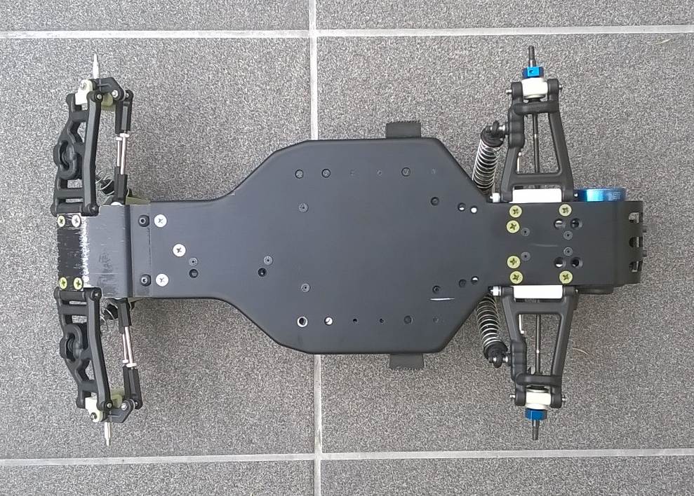

The car looks great! The front shock tower I'm using would be perfect for your car.
This may be a dumb question but what is different about the inner arm mounts that you made VS. the stock Associated parts?
Could you post a pic of the bottom of the car, a pic with the body off, and also perhaps a pic with the wheels off?
- Niki
- Posts: 524
- Location: Finland
- Has thanked: 3 times
- Been thanked: 45 times

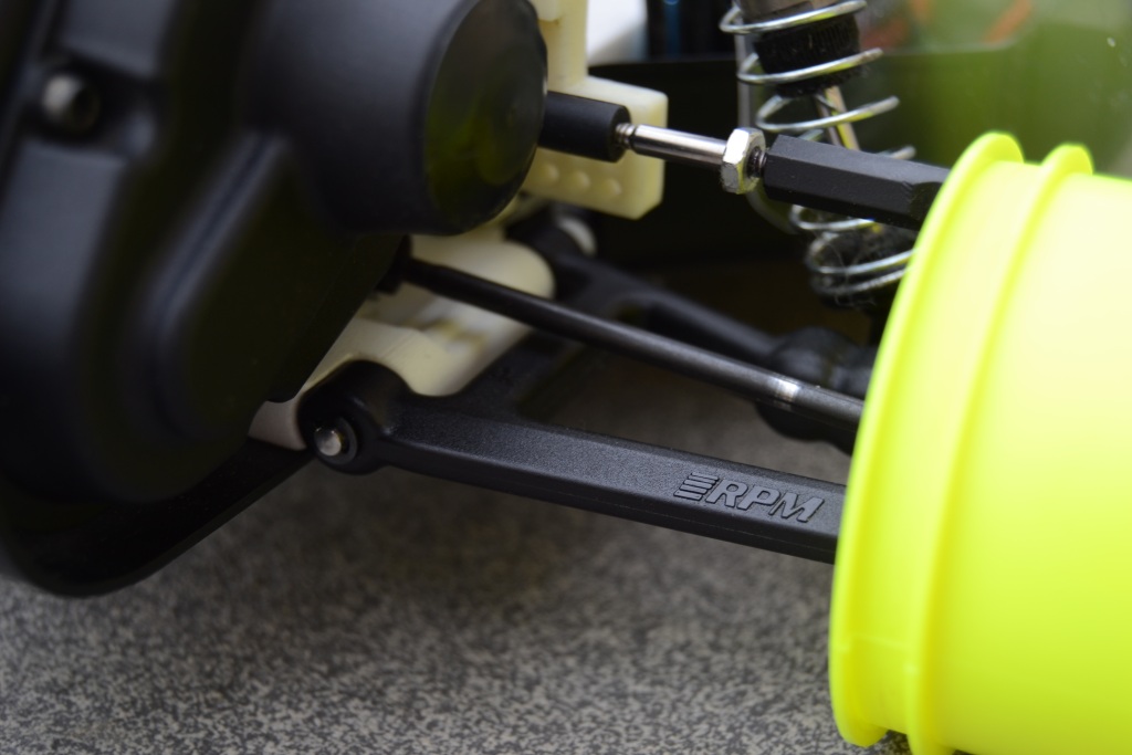

Biggest difference in arm mount is zero degree toe-in. Arm itself has 3 deg.
Arm mount location is also fine-tuned for B4 bone lenght. As you can see from the picture (with stock inner hinge pins) RPM arm should use shorter pins. This also affects arm mount design.
-N-
-N-

10T nose is needed.

At least wheel nuts are outside 250mm. When I measured it with B4 front rims alone it was 250mm sharp on ground level. With wide tyres it's outside 250 for sure but maybe with ribs it's ok.
