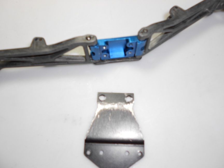

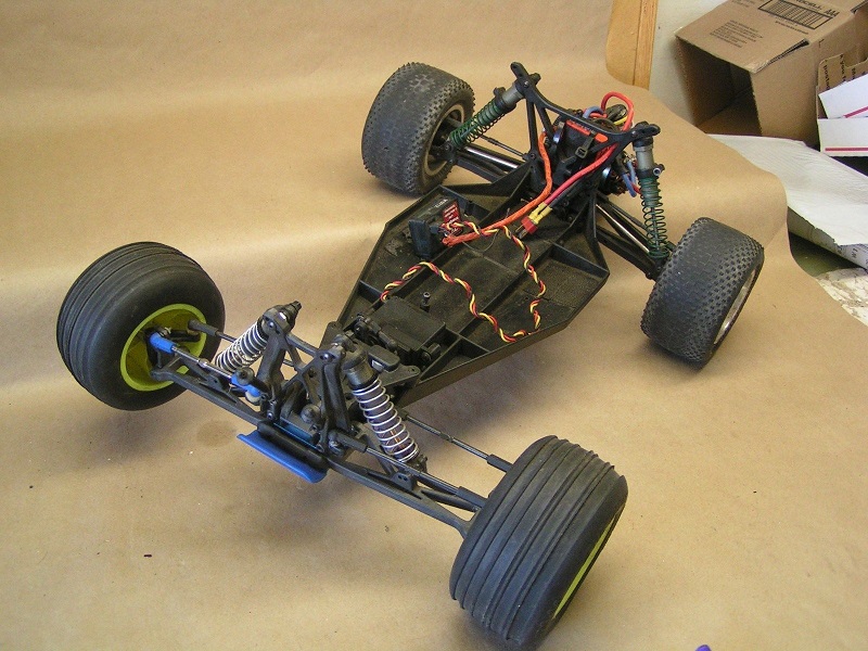

I've finally decided to do a stadium truck after all these years. So I'm looking over Ebay and found a few of the newer associated trucks. I didn't want a first gen 10T, simply because it's too much like the RC10, and I don't want another one. Anyway, I find a T3 dirt cheap with servo, an Epic 19 turn brushed motor, Novak GT7 ESC, and a Losi 2.4 Ghz receiver. The photos online looked a little strange (remember, I don't know trucks), but I threw in the minimum bid and won it.
Now I get the thing and find why it looked strange: the owner must have wrecked it, and replaced the ENTIRE front end (shocks and all) with T4 parts. Needless to say, the T4 won't fit a T3 nose plate, but this guy tried....badly. It's the worst hack job I've ever seen on any RC car. (If he's a member here...SHAME, man. :evil: )
At least the gearbox, CVDs, shocks, suspension arms, servo and motor are in good shape (worth the price paid).
So now my clean up/tighten up/new body and bash is going to become a full-blown rebuild. Time to break out the dremel and calipers...updates as they happen.

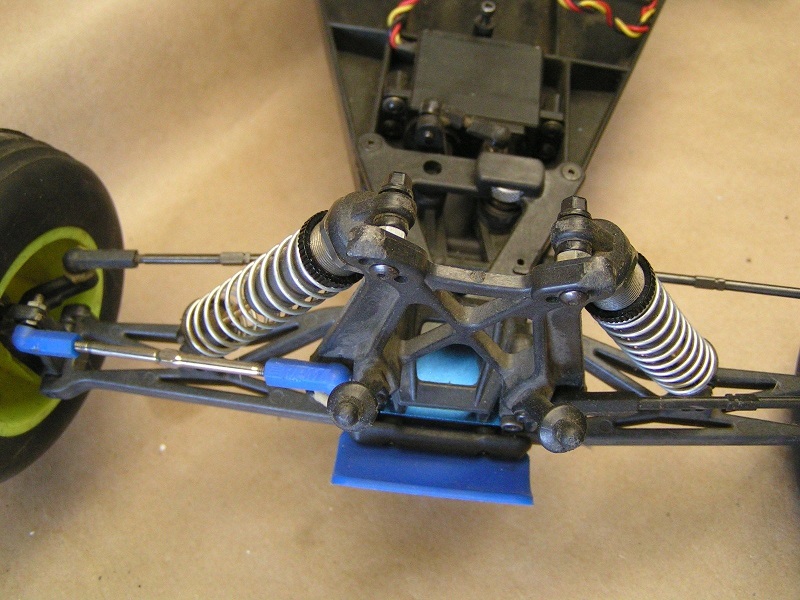

How's this for hack job? Got this in a 10t carcass a few years back lol
Will be watching the rebuild!

I stand corrected...THAT'S the worst hack job I've seen. :lol:

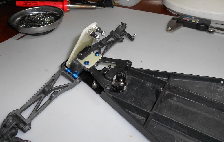

Here's the first attempt at a chassis mod to get the T4 front on properly. I may rework the G10 piece to extend to the rear mounting screws on the top plate holding the steering linkage. I also had to make a new shock tower to have a place to bolt the top support plate.

Why don't you use a stock t3 front? Those parts are available... If you really want you can still use your t4 hubs with small modifications. That would be much easier wouldn't it?

The first thing I started doing when I got the truck was look for T3 parts.... I found they were few and far between most everywhere I've looked (mainly, the front bulkhead). Besides, I'm now determined to make this work out. So far, so good.

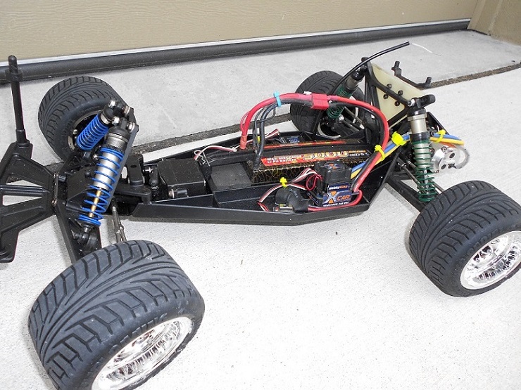

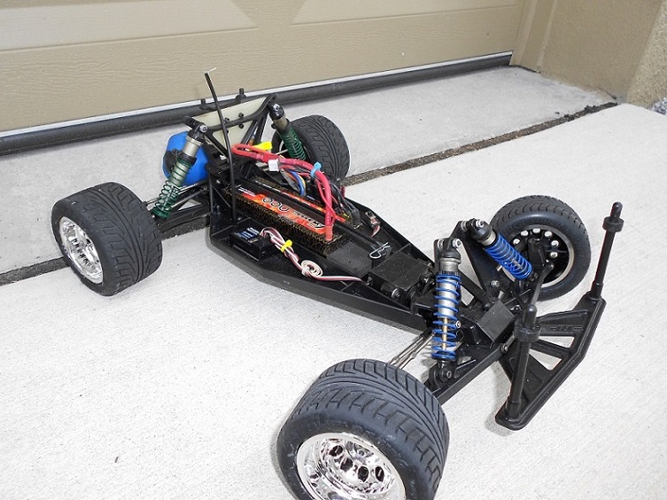

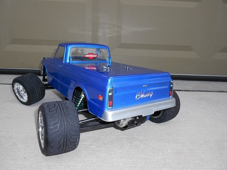

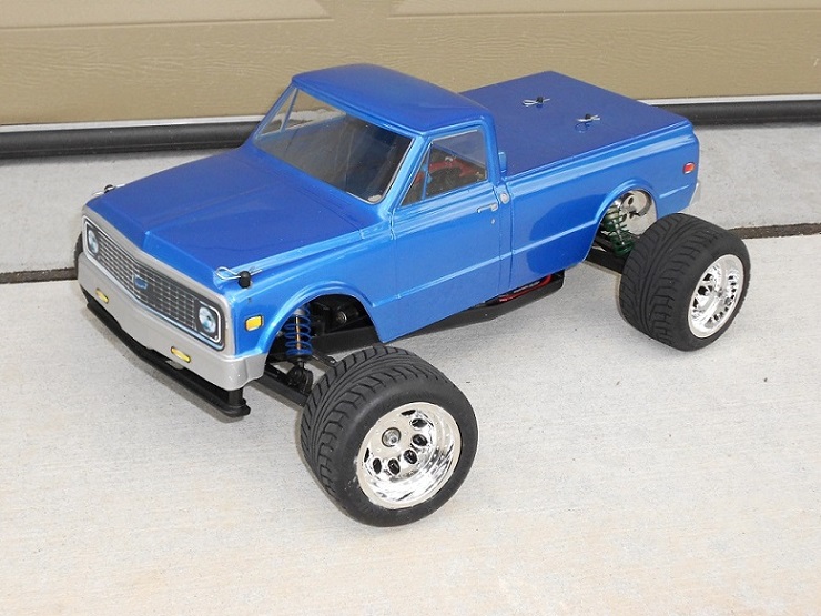

So while Frankenstein is still in the lab, I managed a few goodies for the proper truck. I'm using RPM revolver rims with HPI street treads, and a Parma 72 Chevy truck body. The truck is very stable and pretty quick off the line, but I think I'll swap out the 13.5 motor for the 10.5 I have in the TC4. Enjoy 8)

Looks great Russ 8) Good to see her back on the road again! FYI I ran a 6700kv motor :shock:
