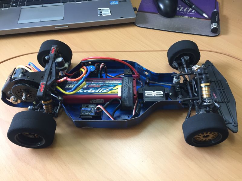

I added a DS to my collection a few years ago now, but as parts for it are scarce in New Zealand I wasn't too keen to actually use it. A few weeks ago I bought a load of new old stock parts including some DS stuff. So now I've got spares I'm going to take it to the next race meeting and see how it goes on the track. When I first got it, I pretty much stripped it down, gave the parts a clean then quickly put it back together before I forgot what went where. Now I have a manual which is great and I can tell that it is a conversion car for a start, and it also has a few things that are not right for a DS: The rear axles are standard RC10 units which don't really mate up with the new wheels very well, so I have replaced them with the 3/16 units. It also had the steering block / axle type that you are not supposed to use. So they have been replaced with aluminium inline axles and steering blocks.
I decided to go with a 21.5 blinky setup and I have no idea what gearing to run, so any suggestions would be appreciated. The other thing I need to decide is whether to run the treaded tires or some foams. I have a set of NIP 8898 rear foams and 8888 front foams, or the standard rubber that comes with the kit. Any tips on general setup would also be nice.

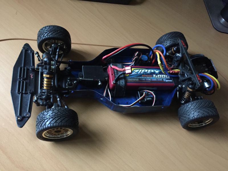

Very nice and extremely fun car to own, cant help you on gearing but the tires I can.
Take the original treaded rubbers off and save them you will not find another set unless you have spares, foams are good also but will wear quick on asphalt. If you go to my DS mid mount build you can see the rubber tires I use which are plentiful and fit great on the original wheels................... Rear body mounts are still available but fronts your gonna have to get creative or adapt some other tall mount.

Thanks for the tip on F104 tyres Jake they look like the business for outdoors racing. The first race meeting I will take it to is indoors on artificial turf, do you think they will work there, or I should stick with foam? Also the taping on the inside of the tire, is that becuase they are distorting on your low turn motor setup? I don't know if it will have the same problem with a 21.5 motor.

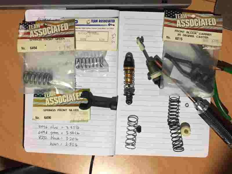

Thanks also for your tips on setup LoboNYC. I will start by making the front a bit stiffer, so I rummaged through my springs and found some silver 3.85lb ones to replace the standard black 3.2lb on the front. I also have some gold springs that came with my East Edinger RC10 that feel even harder that I might try if it needs more. I found some 25 degree front blocks that I will install which should dial down the steering a little too.

Yes I taped the tires with the 4.5T motor cause they were ready to blow off but work great on my 21.5T without tape.
Tire choice can’t help bud but I know the f104 tires work on my street with jacked up asphalt.

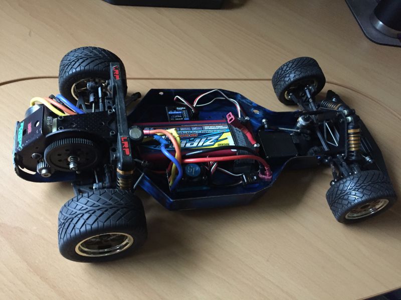

I think I have it setup as well as I can with testing it in the street. I'm sure it will go nowhere near as good on the track, but we'll see I suppose. All I need to do now is find a body for it, that will prove to be a mission i'm sure.
Here it is in nearly race trim:

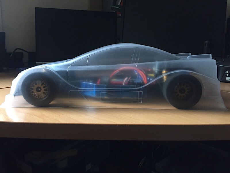

I found this old 200mm touring car body at my local hobby shop. The wheelbase looks right and the width is perfect. It’s an Opel Astra, and looks like a German touring car. I’m thinking of painting it in a gulf colour scheme.

Re: Old DS lives again
O man that is awesome very aerodynamic, please post a part number for that body...........................................I want one
