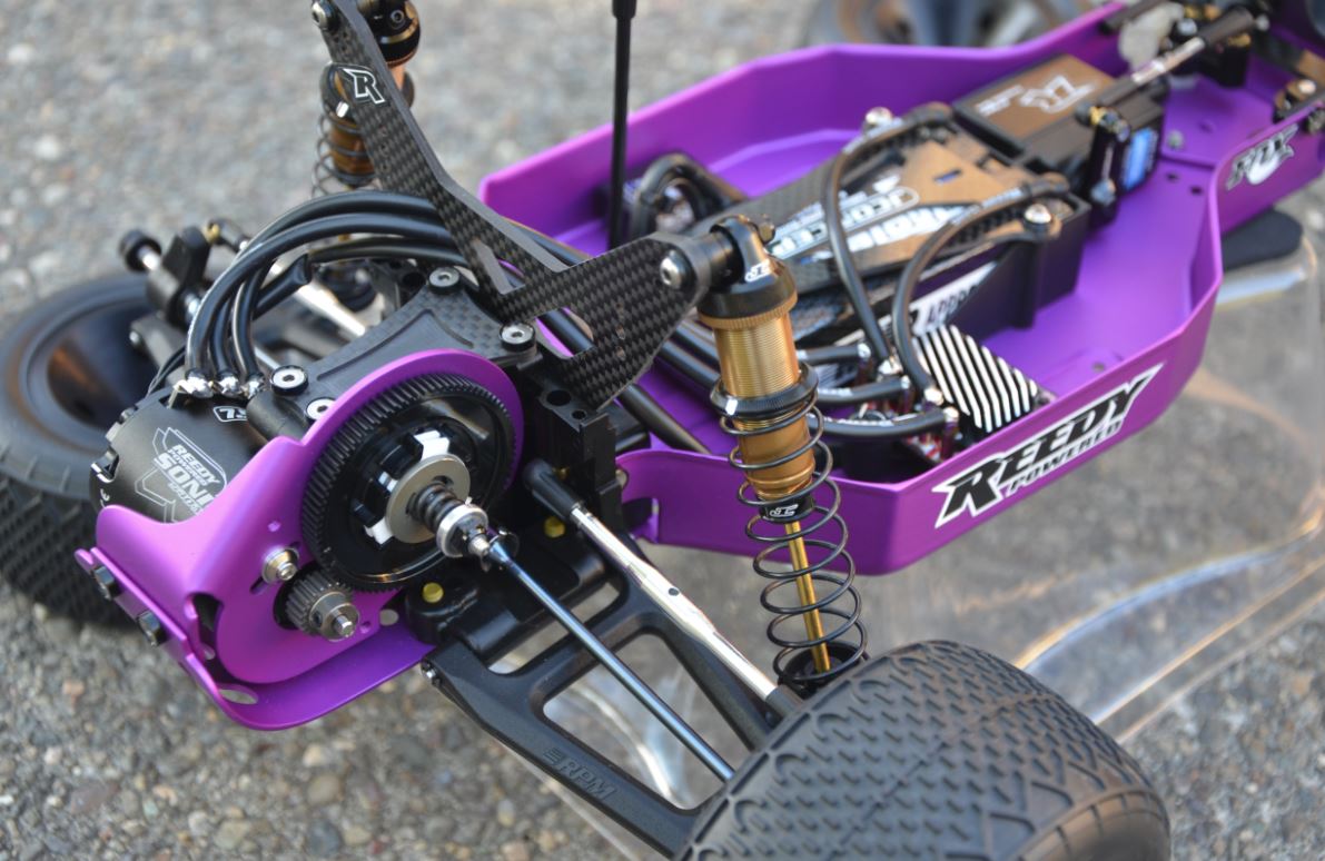

A few small changes. I wanted the option to run modern slippers, but you cannot simply swap a new B4 shaft into the RPM transmission, because the gear ratio is different from the Stealth. I removed the gear ring from the RPM shaft, did the same with a new B4 shaft, and pressed the B4 gear ring onto the RPM shaft. Now I can use the RPM transmission and still have a shaft that accepts new style slipper setups. I went with a Avid slipper setup.

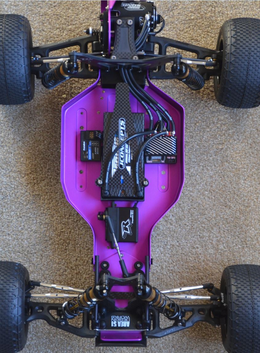

I rearranged the electronics layout in a bid to clean it up. I was able to shorten the motor leads by switching the the esc, and re-routing the wires.

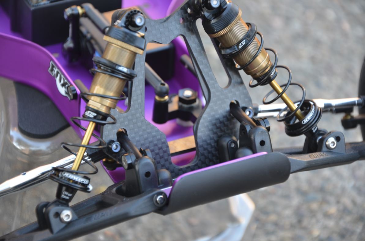

Charlesmtb wrote: Tue Aug 16, 2016 4:43 pm What CVD are you running on your rear?
I went back and read the entire thread and I don't think this was ever answered. They look like MIP aluminum bones to me, quite rare as far as I can tell and not terribly strong, but good for stock racing though.
Some good parts went into his truck.

RC10th wrote: Sat Jan 21, 2017 3:52 am
Aluminum MIP CVD's. Quite rare. This truck will likely never be driven for real, so they are doing their job by looking good.
