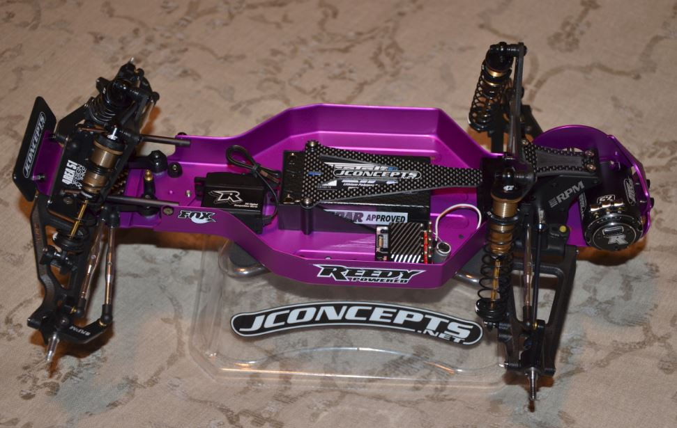

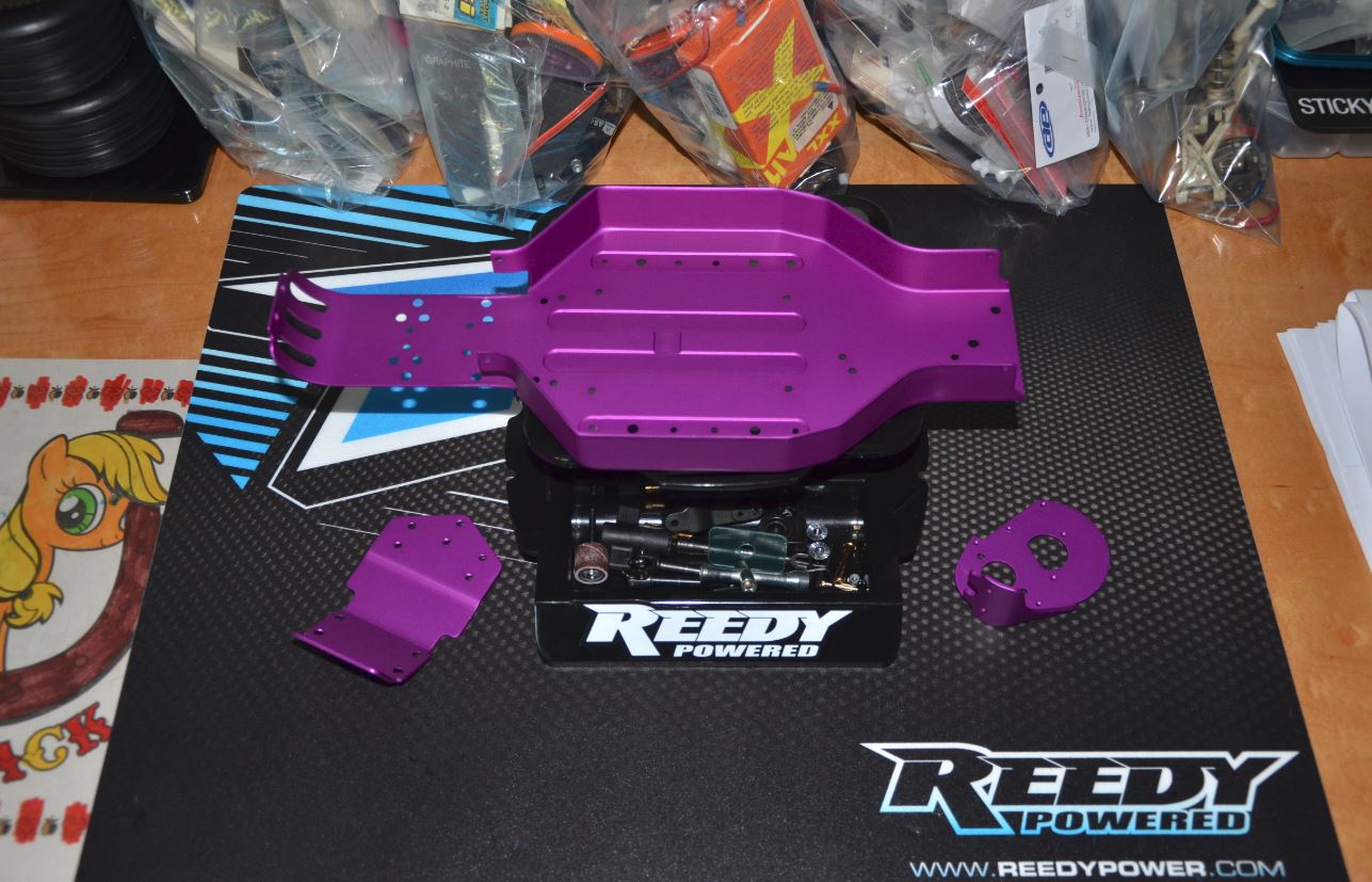

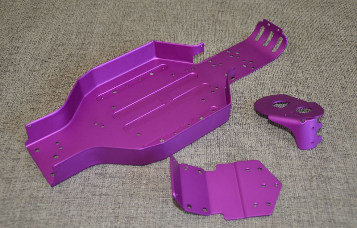

Here is the start of a modern take on the RC10T. I just had the chassis anodized. I did some rounding and sanding work to it prior to anodizing. I will be installing modern electronics, as well as new vintage upgrades. It will be a bit of a mash up of pieces, but I hope it turns out as nice as I have envisioned it. My plan is to build it as a high end runner, that will be too nice to run, lol.

That chassis is mint! Love how it's eye catching. Looking forward to watching this build.

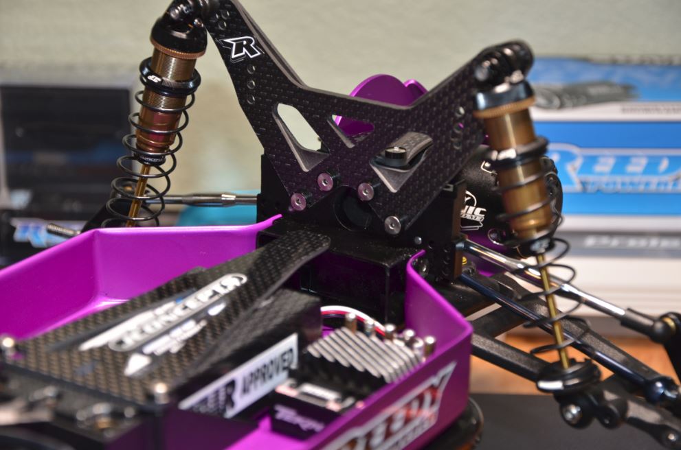

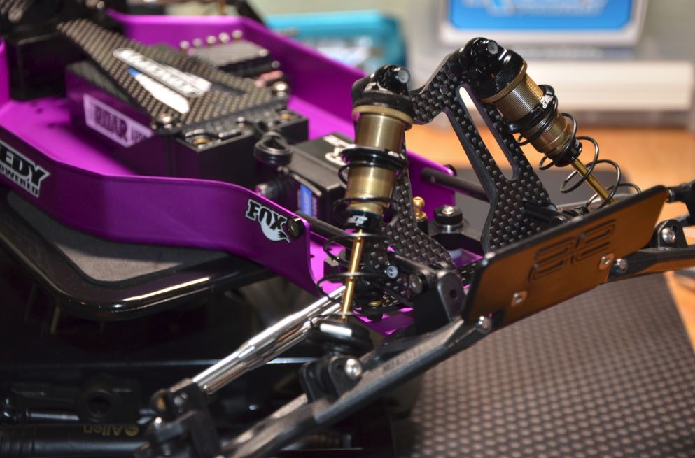

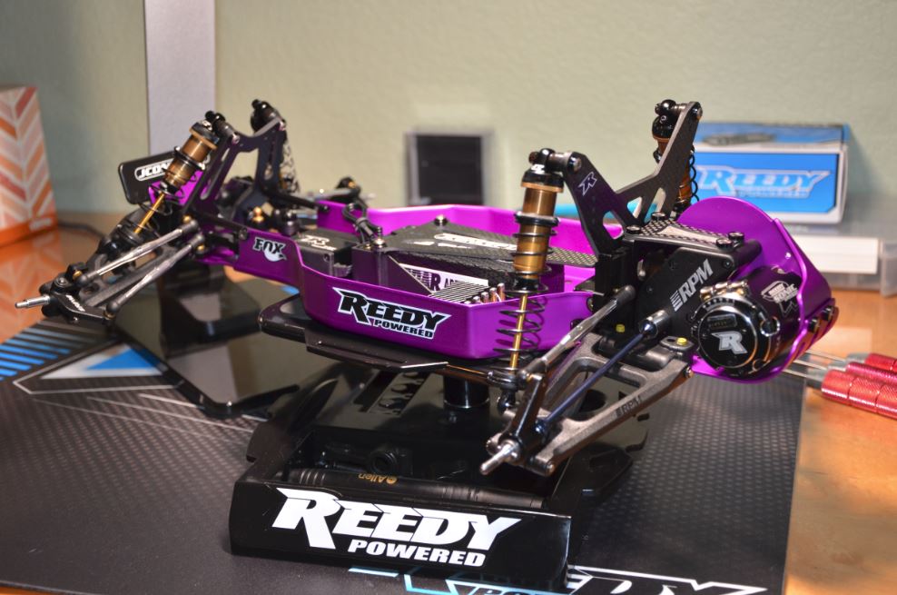

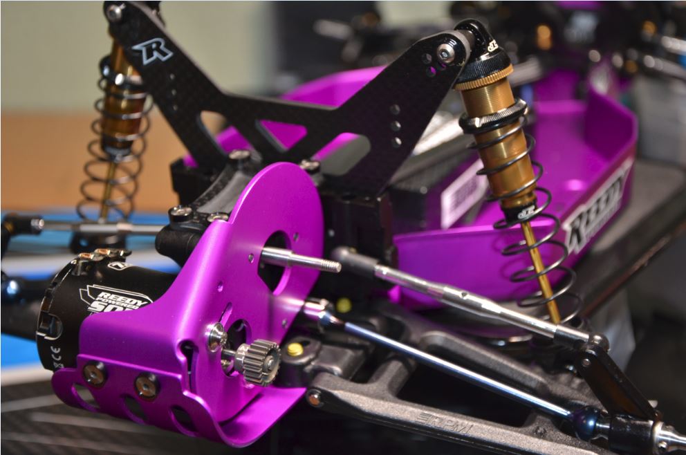

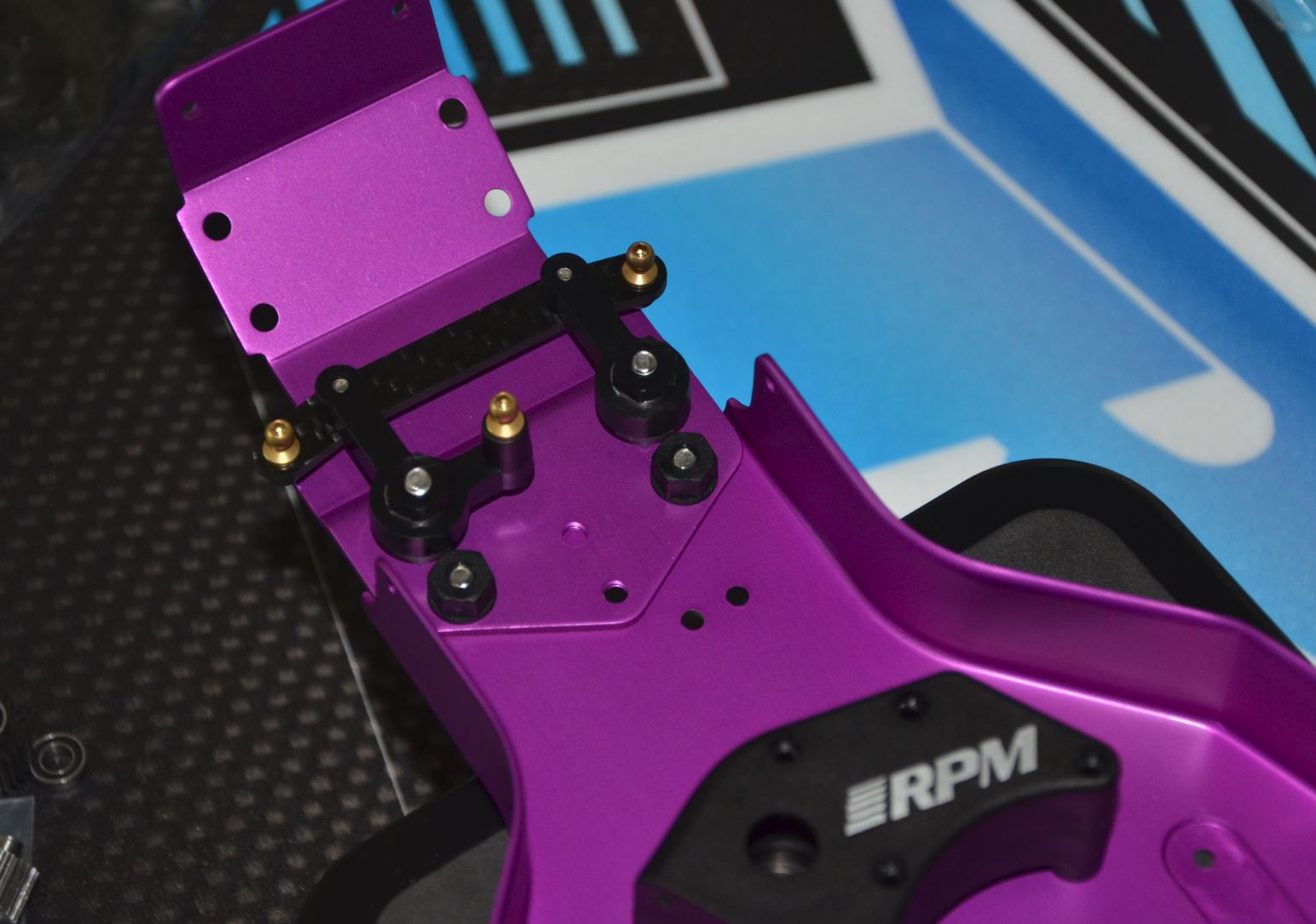

Progress pictures. Getting close now. Sorry for the crappy pictures in bad lighting. I installed A&L steering with the CF cross. I dyed the yellow plastic black.

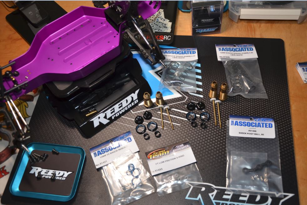

I build the shocks from new AE Kashima bodies, Ti shafts, and Jconcepts o-rings and finishing pieces. The shock towers and transmission brace are also Jconcepts pieces.

with the exceptions of the electronics that truck is so 90's with that gorgeous black and purple scheme :)

Looks great Adam. Just a heads up on the RPM arms- if you are on a high traction surface, they kill the handling. Seriously, they will flex, twist, deflect and then rebound in corners and you will chase a setup forever. The T2 type arms solve all of it though.

Charlie don't surf wrote:Looks great Adam. Just a heads up on the RPM arms- if you are on a high traction surface, they kill the handling. Seriously, they will flex, twist, deflect and then rebound in corners and you will chase a setup forever. The T2 type arms solve all of it though.
Good to know. I love the look of the RPM arms for this truck, but the flexing is a known issue. Thanks.
