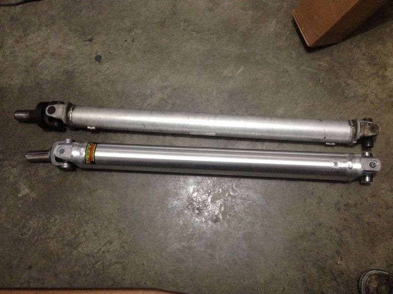

Small update: new driveshaft arrived today. And searching out someone to do the wiring.
Here's the stock Camaro shaft next to the much stronger chevette shaft.

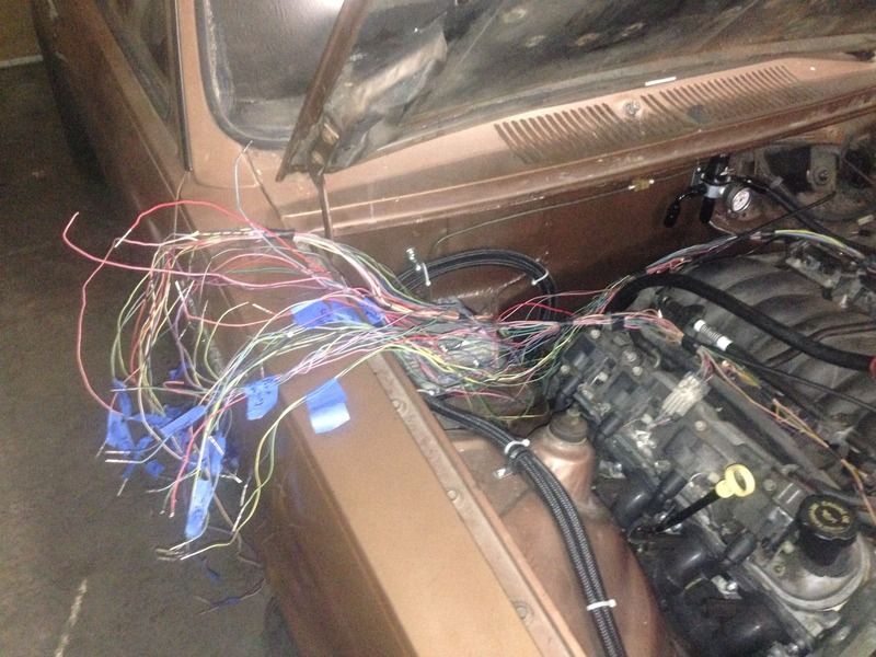

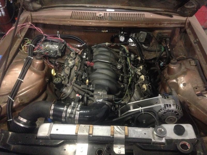

Well I can't say I still wouldn't rather someone else be doing this. But I made a post on an LS forum looking for help. A local guy is helping me through text every step of the way. So far I have separated the injector, coil portion of the harness and have it in place. Along with 4 other sensors in place. We've also pulled some of the extra stuff I won't be using like AC, egr, and extra 02 sensors from the main harness. As we go it's making sense but it's still all very complicated to me. Just glad I have someone willing to coach me through it.

Nice work!
I can see you have everything laid out nicely.
Definitely a bonus having someone to guide you.

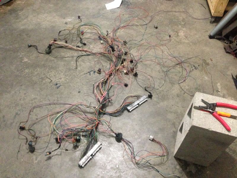

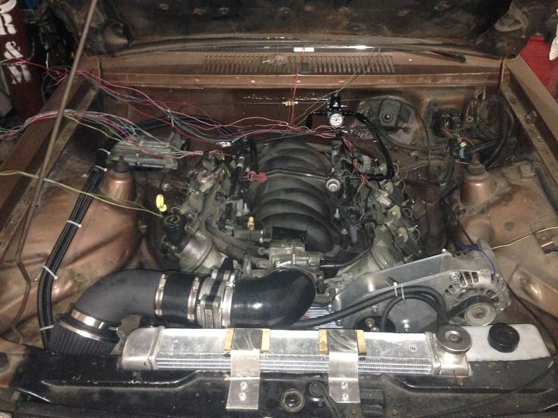

Well another day of wiring and a huge part of the wiring job now done. The basic part of the engine harness is now done. Once I know the car runs it will be shortened to the correct length and taped up.
There's no way I would have ever considered doing this on my own. And no way I could have. I would have so much rather just dropped my car off and paid someone to wire it. I have no problems paying for something I don't want to do. But this guy has done so much and asked for nothing. I've tried many times to paying him to do it. There's still a little bit left to do. But it's looking like I may have this on the road in the next couple-few weeks.
Here's another shot of the almost finished harness
How it looked a couple hours ago.

are you reprogramming the PCM before you fire it up?
I usually try and get as much of the donor harness as possible, and use all of the sensors, and fuse blocks. Even more so if there is not much 'upgrades' going on. I hate spliced wires but once I get to the fuse block, it's all 12v or IGN or GND.
The only reason I bring it up is that for sure you will need to have some error codes disabled with removing some of the feedback. It can be quite intrusive, ie, without certain functions, the ECM goes into a limp home mode reducing timing and fueling.
I can answer lots of questions regarding the general operation. I don't know the full function mapping of the LS PCM but it's not too far off from the older TPI and LT1 functionality.
