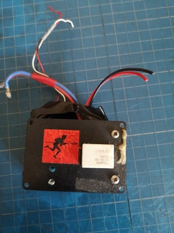

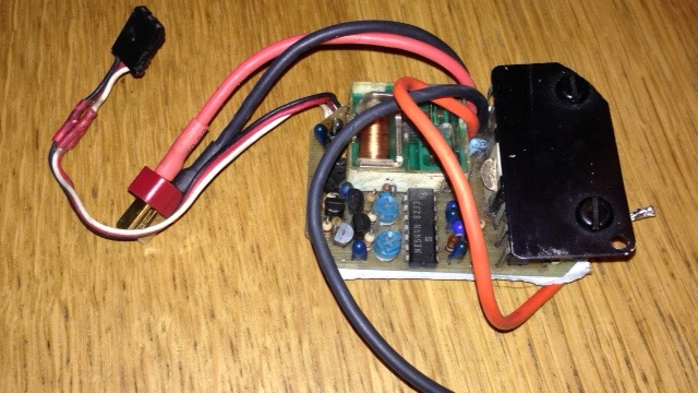

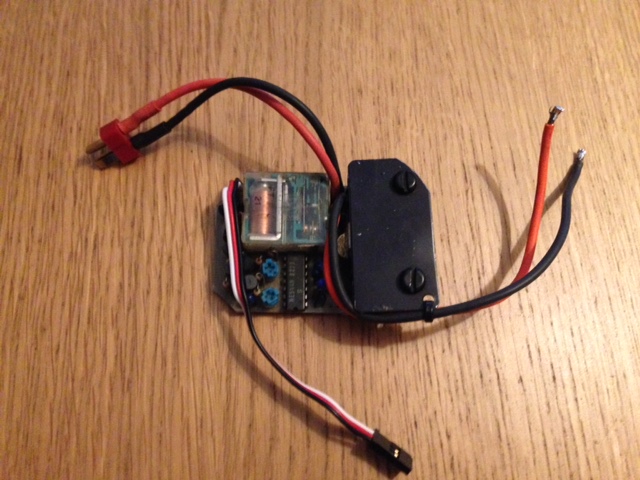

I just picked up a Schumacher C-car, and it came with this beauty from 1981.
Before my time I started racing in 1985, My first speed control was a Demon king 6x BUZ11 fets although I recall upgrading it to proking spec by installing the other 2 fets.
I had a buddy whom had the older Demon 2DH which was probably the buggy version of the 2C because it had at least 2 relays if not 3.
I re wired the power cables in the last photo. I did slso change the servo wire this morning. Still waiting on some heatshrink to wrap it with as they where back in the day.
It works great! :D

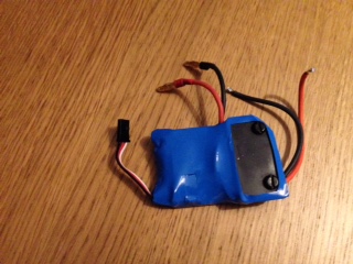

Post by bluewormx »
Here with the power cables changed.

Post by bluewormx »
Here with new servo wire, ready for Heat shrink. :D

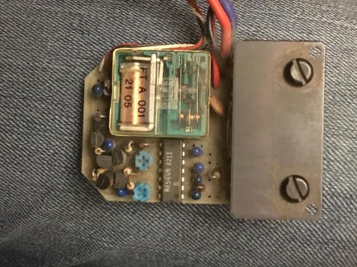

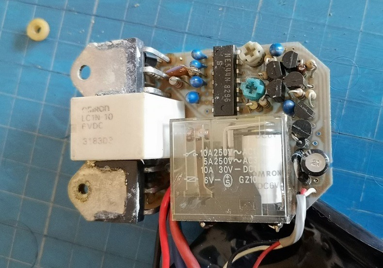

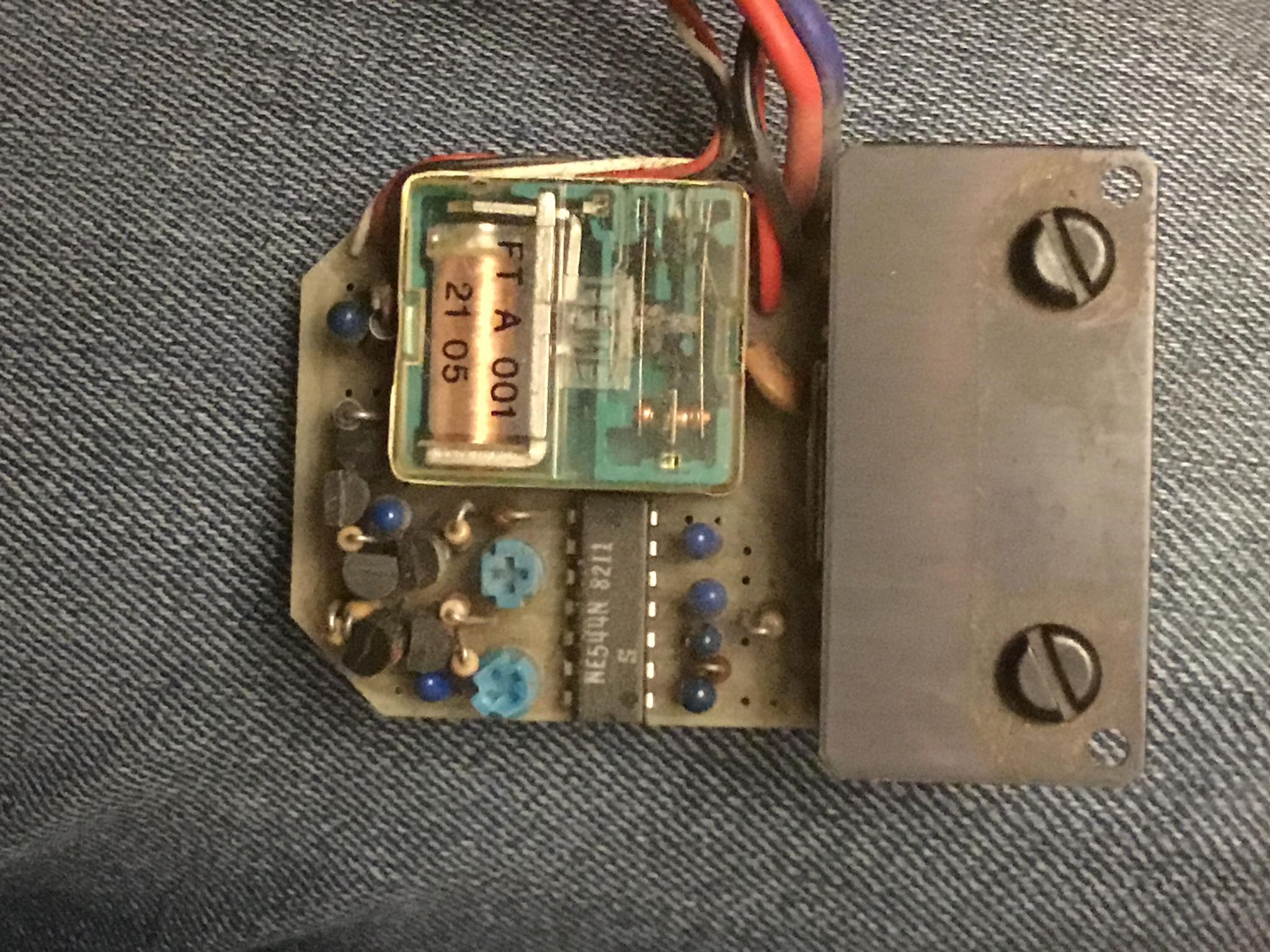

The Demon 2C was Nick´s second generation ESC. There were several variations where the main difference was size of relays and size of heatsink plate. I think all of these ESCs were based on the 2C PCB and using one relay for bypassing the transistor at full throttle for lower voltage drop. If you got a Reverse version of this ESC there will be another relay. I´m not sure if there was another version using three relays but I could ask a friend who maybe knows more than me.
The 2DH was the buggy version and I think the name maybe means double height as the relays were much larger. The 2DH was quite a sturdy ESC and very popular in offroad cars, even when the FET ESCs were available.
The Demon 1 and 2 were Nick´s first generation ESC which came without the bypass relay as ESCs of other manufacturers. The bypass relay circuitry was introduced later as a addon, known also as turbo relay.
If you´re interested in early ESC you can find several at https://classicrc.wordpress.com/

This 2C has the bypass relay underneath the heatsink between the power transistors.
The Proking in my opinion was crippled by the reverse relay and the weak braking power transistor TIP 36A, I blew more tha one.
The reverse relay used the NC (normally closed) contact for forwards so having x8 BUZ 11 rated 240A continous current passing through a 25A contact was not ideal. The easy fix was to remove the relay, hardwire it on the PCB and go forwards only.
Later prokings had a second power transistor shoe horned on top which mitigated that problem.
Non the less they where very good speed controls.
In fact I like them so much that I'm trying to hunt one down...

The TIP 36A is a Darlington and not really a powerful transistor, my early ESCs used BD250 which were much better.
The problem with relays is, there is none which really could handle the power of the FET transistors when using a 4WD car or a very hot motor, at least not at that size. You sure could find matching relays but they would be as large as the car. :lol:
I think none of the reverse ESC was intended for racing. The relay contacts will go worse through use and will affect the voltage drop across the ESC badly anyway. Most of the relays are not dustproof what is another problem, at some point I found airtight relays (made by SDS) which could handle the amp draw of 1/12 scale cars and my early RC10. This was for my pre-FET ESC where we used 19T motors as a max.

This Demon 2C has BD249 as the forward transitor snd a BD250 for brake. Why would nick switch to TIP 36A? was it simply cheaper? He charged me 5 quid each and I'd change them myself.

Post by bluewormx »

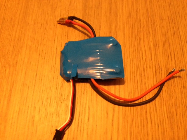

The heatshrink finally got here. Slow boat "from" China ;)
I put Corally style connectos on the battery wires, these really aren't period correct since they did not appear until about 1987.
I guess its done now. :D
Done is never done...
I re-applied the heatshrink in the other direction
seems like a better fit.

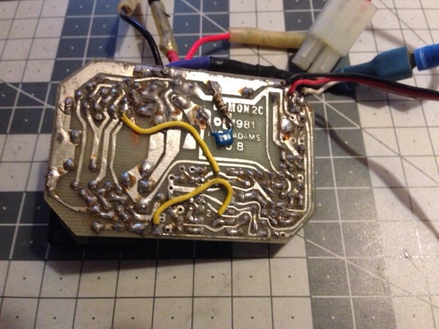

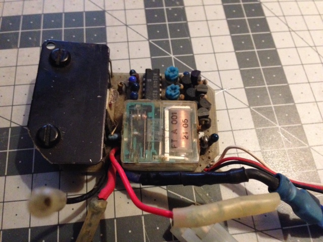

Post by dinglem »

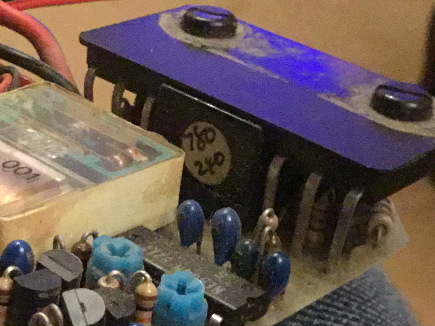

Hi Francis, just throwing mine up for comparison... although it looks to be identical apart from mine having a slightly larger plate.
1981 dated Demon 2C 'ISS B', which is in surprisingly good condition. I also have an 'ISS C' dated 1982 which differs only by having a full width upper plate - not sure what the B to C difference indicates? The small round sticker has 780 240 hand-written on it, the latter part dating it as actually being made in week 40 of 1982.
Here's the other one (with the full sized upper plate present and removed) for reference.... it has a white pot too!

Post by bluewormx »

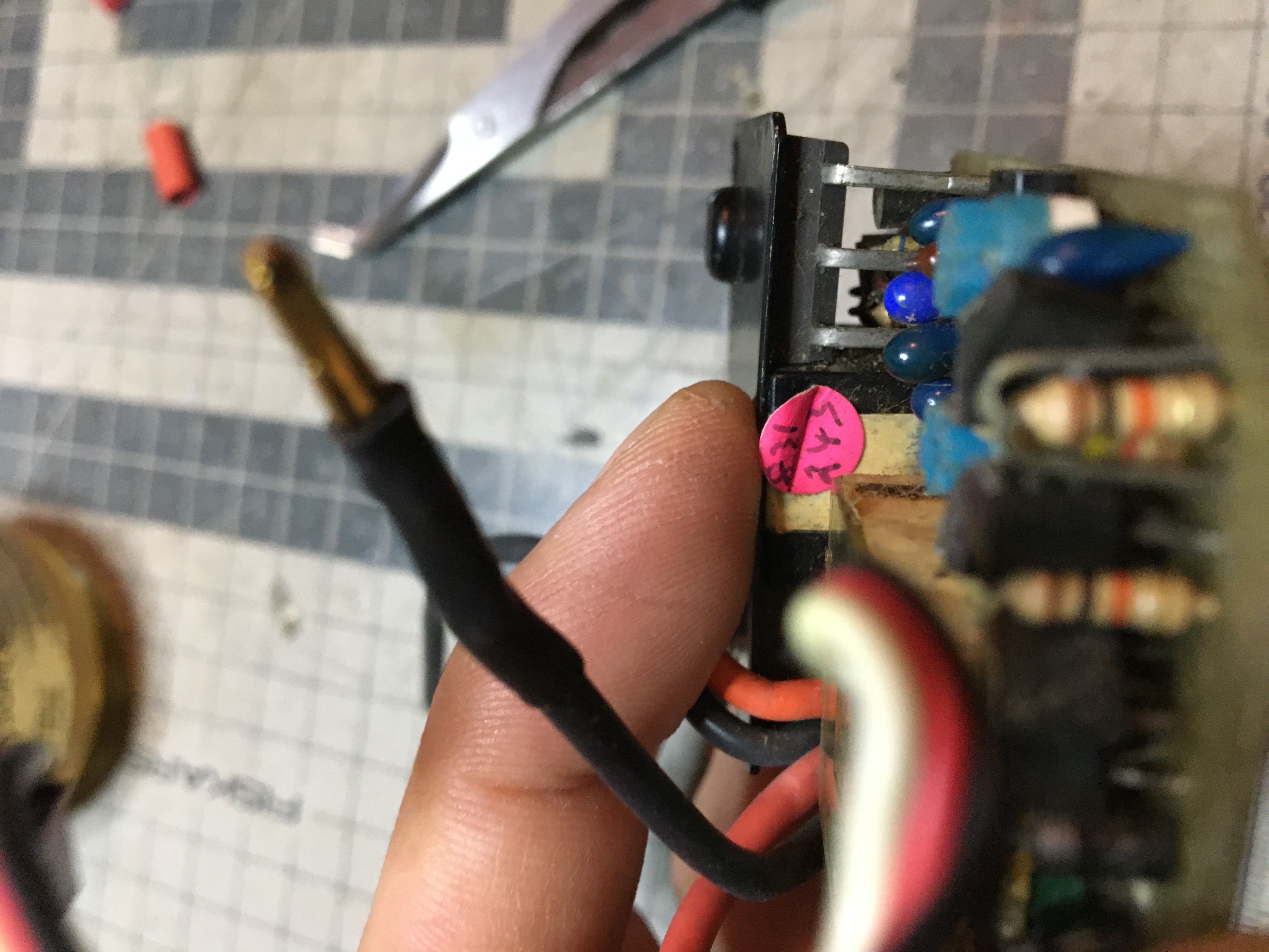

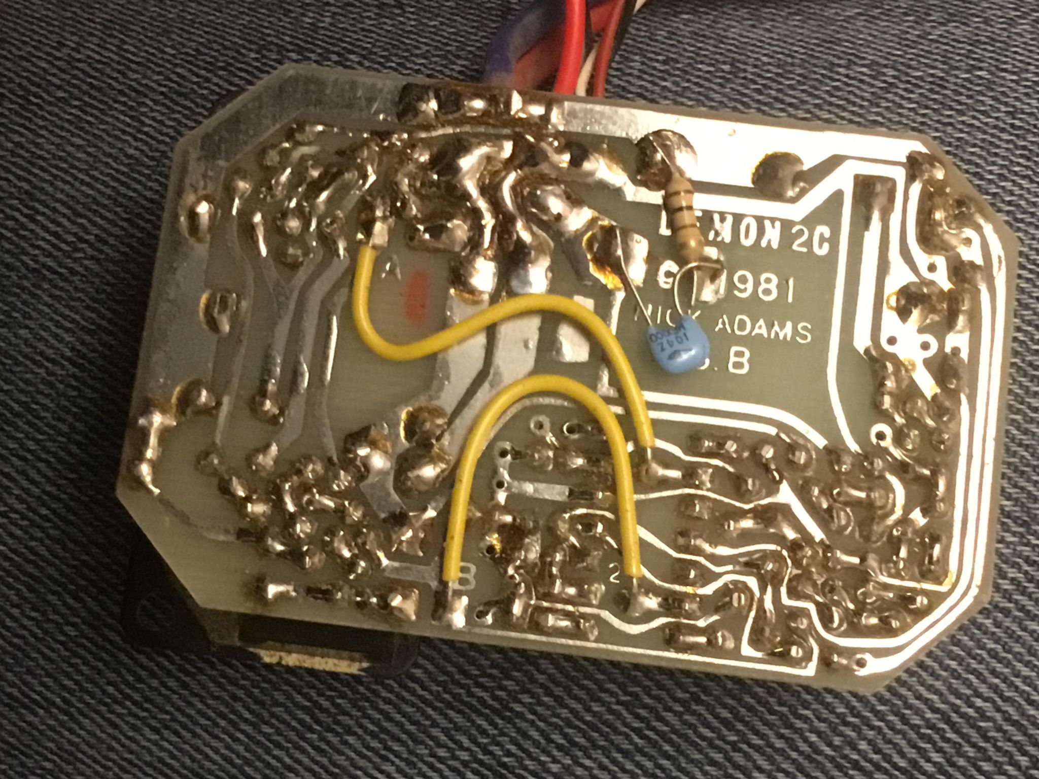

I finally re-heatshrinked mine again and had a peek at the date and serial number.
831 -243, Number 831 1982 week 43
I'm pretty sure the Demon 2C was probably the second most built after the proking which I have seen go into the low thousand. I wonder how many Novak 1's where made 10's of thousands at a guess... :D

Post by dinglem »
Interesting dating and unit number comparison there if you think about it.
Mine was unit number 780 from week 40, and just 3 weeks later yours was unit number 831. So 51 units between them. I am guessing Nick wasn't making various speedo models at this stage, but even if he was that is quite some number of units to churn out in a short period of time!!
it is quite cool that we have the code for the sticker dating 8)
