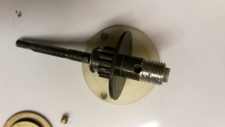

I've got a WASP yoke slipper and it doesn't look like this it's like the ones that came on the Cats but this could be another design, have you got pics of it apart to see if it's the same inside?
Re: Works 91 spur assembly - wasp racing??
I haven't but i'll strip it and post some tomorrow Justin
here it is...main body sits over the end of the layshaft incorporating a one way bearing, the the white plastic(?) disc doubles as the spur gear mount and slipper pad, then you've got the outer plate kept in place by a small plug inserted in the main shaft, 4 sprung washers and finally the outer round nut that acts as the slipper adjuster...that's it apart from what looks like they are going to be hard to source spurs!!....pics below
