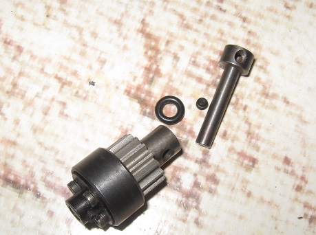

I've not tried this on a 6 Gear but Kyosho Option House used to offer a pinion gear with an integrated torque limiting slipper. It adds rotating mass, but is a cool option.
