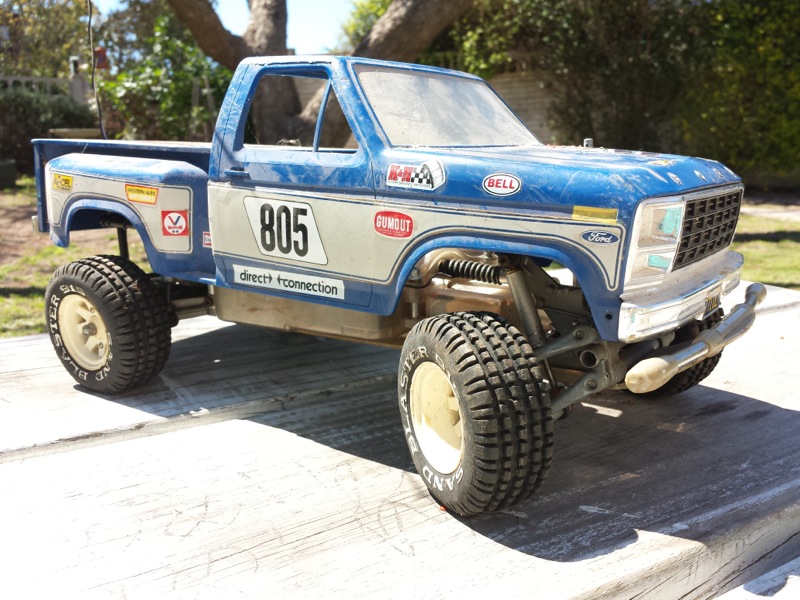

Tamiyamandan has covered quite a bit. If you plan to run this, get an aftermarket aluminum chassis. The stock fiberglass chassis is superflexible and on big hits you will eventually crack your body and Radiobox. To use that scorcher body you will need a scorcher roll bar as the ranger and scorcher are different.
Here are a couple of pics of my runner where I have addresed about every issue with the SRB. From front to back. Race prep steel front bumper, RCH Hardened suspension pins, thorp ball cups, super champ steering servo saver aluminum chassis coil overs for the stock dampers, super champ steel universals CRP aluminum rear bumper.

Thanks Shodog, Super setup you have there!!!
I have a lot of things to change, slowly I will get there. At least I can now show SWAMBO where I will be spending my money on
