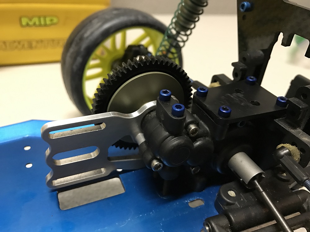

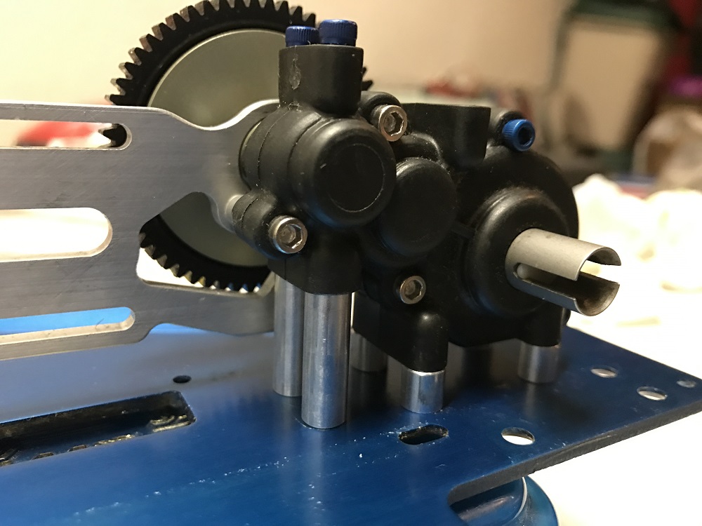

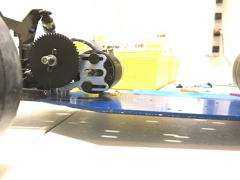

To get the 40mm T8 2650KV motor to fit with the DynoTech motor plate, I have used spacers to raise the Stealth transmission up .250”. I will also be installing the Damper Hobby / GPM trans brace. Another benefit of raising the trans slightly is to “straighten” out the CVD running angles when running In the lowered “squat” position.

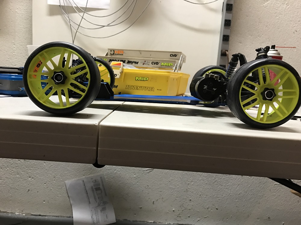

Here’s the stock RC10GT ride height with the GRP’s installed and correct F/R truck shocks

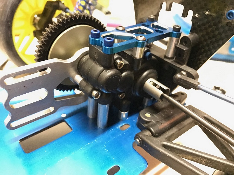

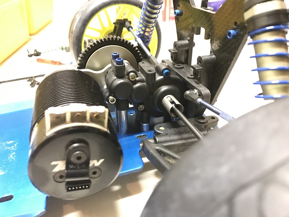

Trans and DynoTech plate in stock position. 40mm motor will not fit

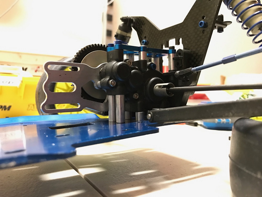

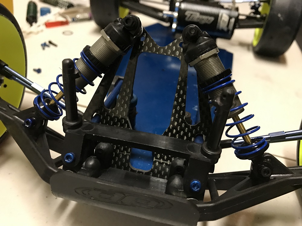

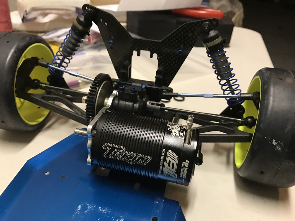

1.02” front shocks mounted in the rear. CVD’s head nearly straight into the raised trans, Turnbuckles relocated to upper hole on shock tower

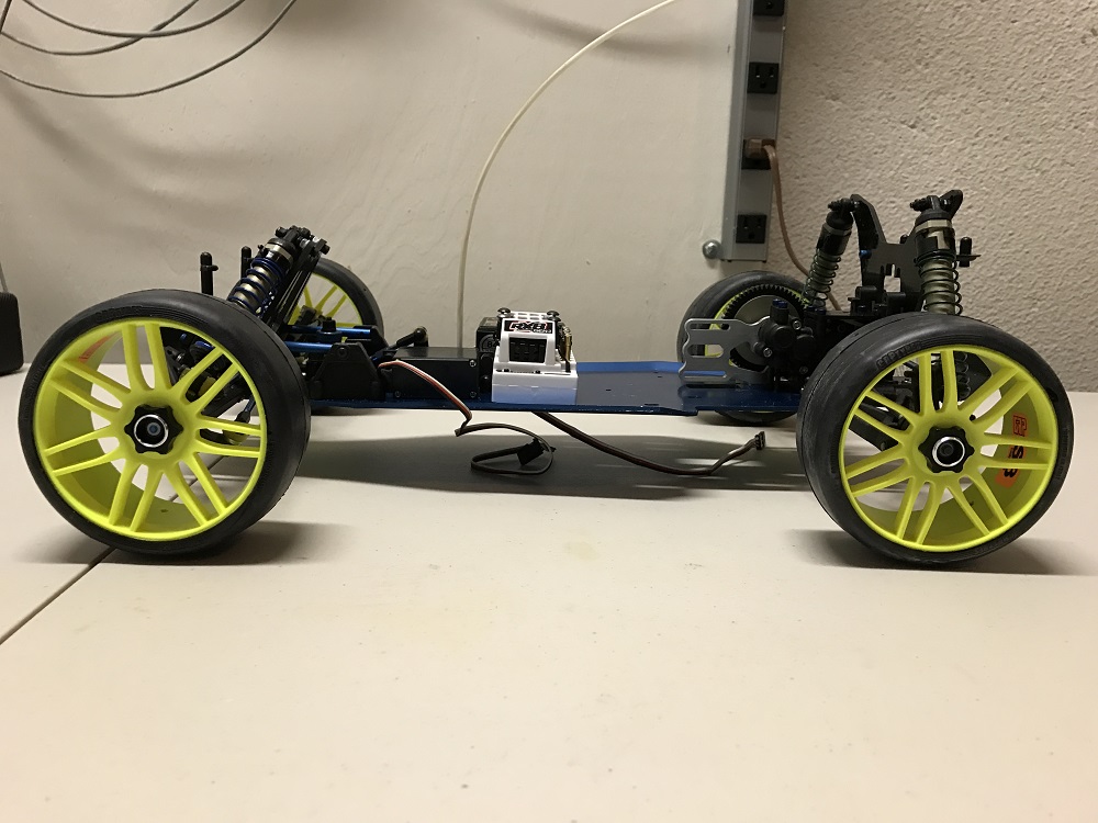

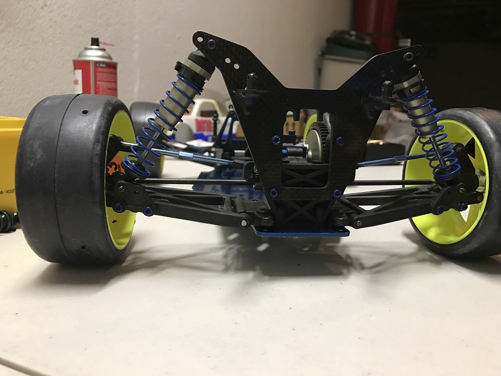

This is pretty close to the final ride height with the 1.02” front truck shocks mounted out back and .89” buggy shocks with limiters installed in the front. The nose is slightly lower than the rear at this point. Camber and toe adjustments still needed to straighten things out.

What is your target ride height?
Also, it might not hurt to look into 0 degree rear arm mounts
RC10 WC re-re / SC10.2 / RC10 CE / 2x RC10GT-E / Futaba FX10
Re: RC10GT Brushless Elec Speed Runner Build
Honestly, I'm not real sure on the ride height. Somewhere around 3/4" to 1" with a slight rake. I want it low, but I don't want it completely on the ground.

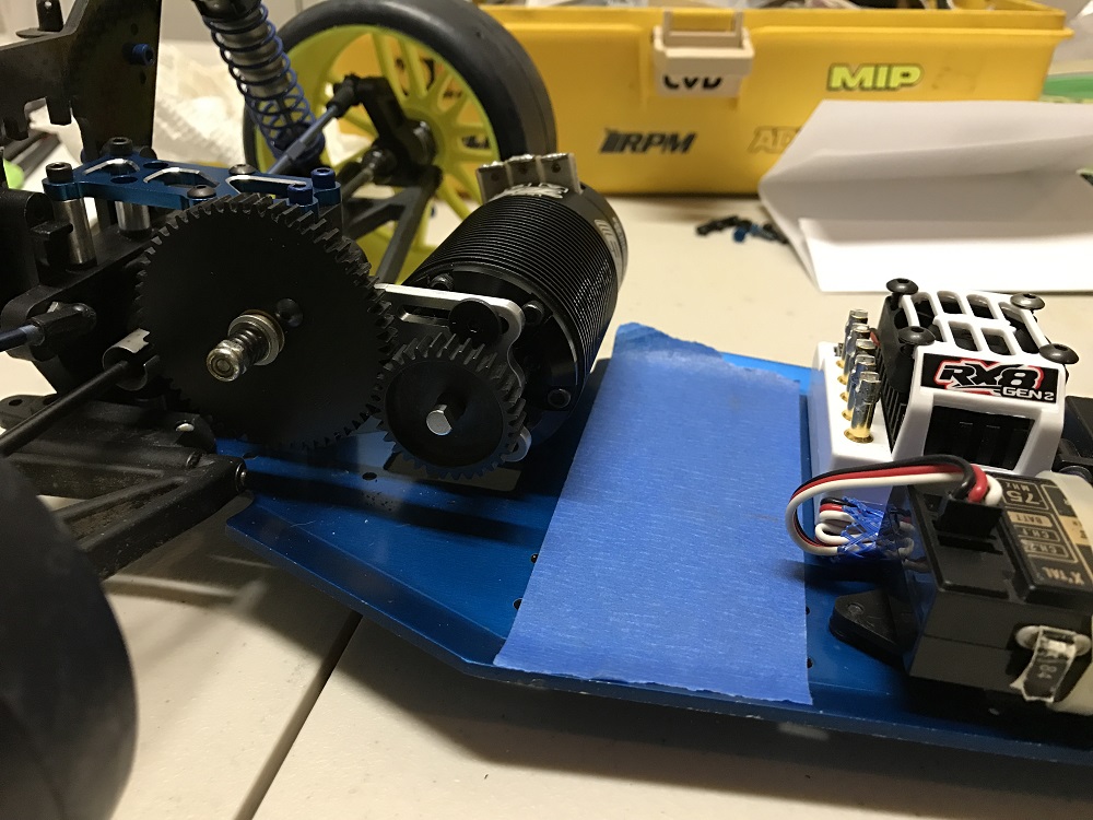

Quick update to the build. I have sourced a large pinion and installed it. Initial gearing will be 32/54. Was trying to get a 35t pinion, but could not locate one in stock anywhere.
I'm also beginning to layout the battery area. To keep things simple, I have a goal of retaining the main electronics (receiver and steering servo) in their original stock locations and still find room for the big ESC and a LiPo pack. With this, I basically have a 100mm x 48mm open area and if I space the battery up some can expand the 100mm to something wider. I have some ideas on how I'm going to setup a battery strapping system that will allow the use of varying LiPo sizes.
Once I get a battery hold down system in place, and source a battery pack, I should be all set to finish things up and get her running.
