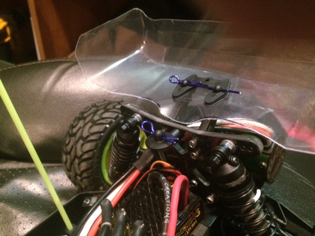

Associated 91433; B5 body mount.
I am using velcro up front, and I see alot of people using velcro on the sides and back as well, but the viper body doesn't hug the side of the pan very tight, so it looked distorted if I squeezed the sides in to use velcro.
The rear body mount on a B5 uses 1 bolt, and my rear shock tower already had one centered hole.

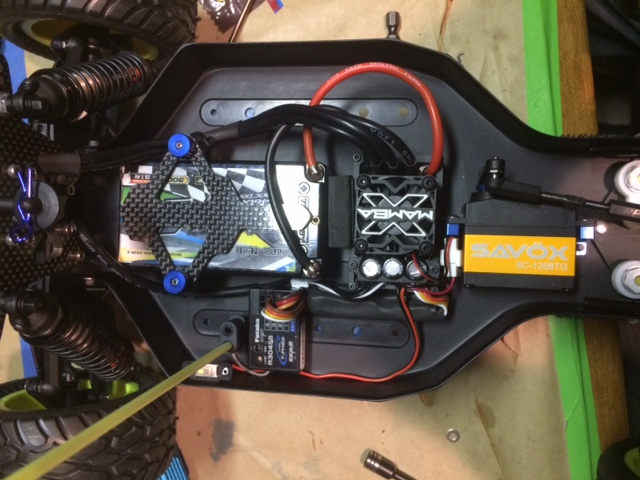

Small update some new hardware.
Slid the shorty back and mounted the ESC in front. Further hacked the B4 holdown to work, and used aluminum standoffs in pre-existing holes.
The wiring could be a little more tidy, but I am happy with it for the first can I've built from the ground up since I was 10...haha
Next steps, verify the gearing is good, and hit the track! The current layour has some enormous jumps, so I'll maybe take it easy...
