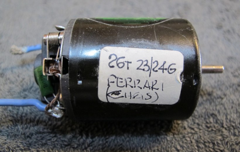

But in the end there will be at least a motor added. Not just any period correct one but a Parma Yokomo Ferrari provided by Chris Arnold, exactly the same type and winding as he used at the 1984 Worlds final.

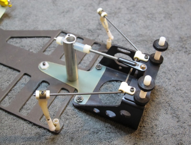

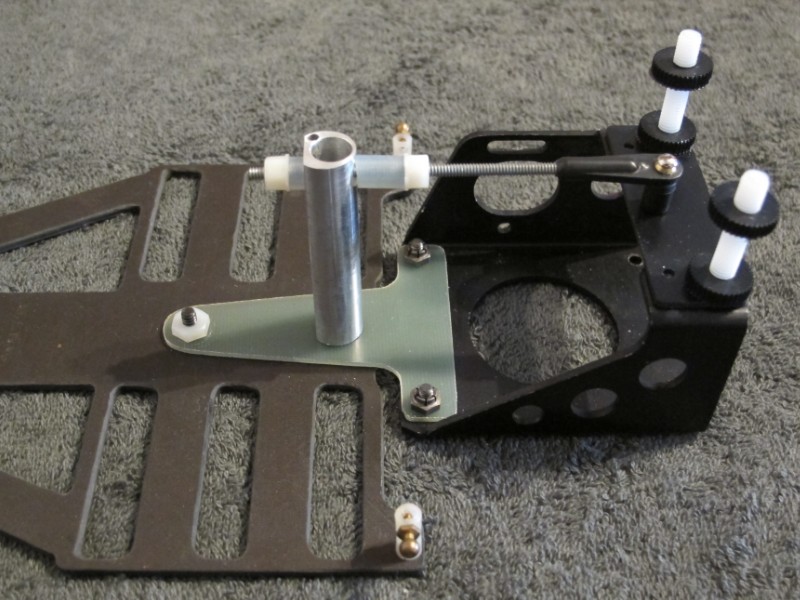

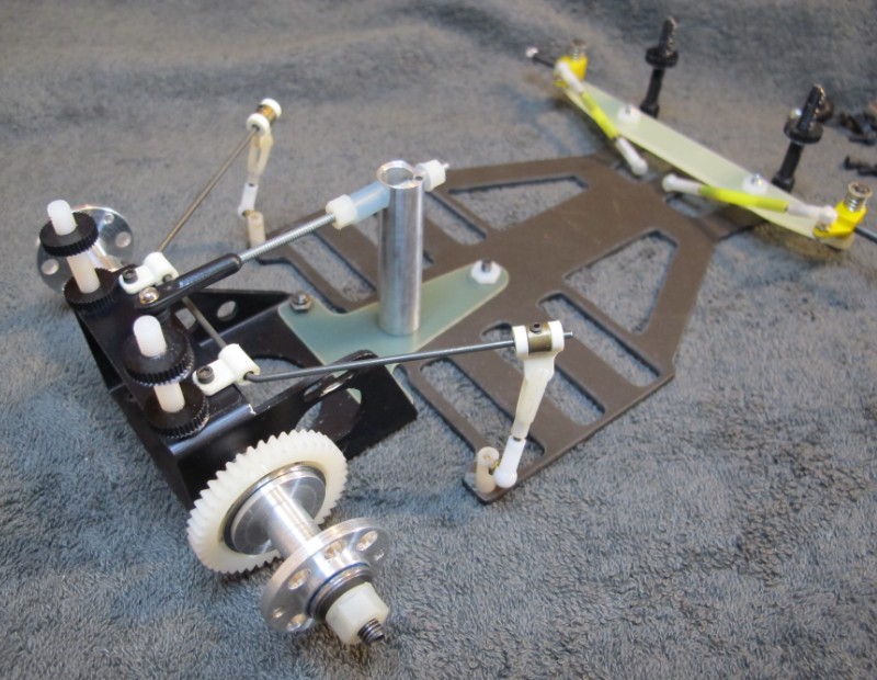

OK back on topic.
Center dampener was mounted and adjusted. Connecting posts for the roll bar mounted to chassis.

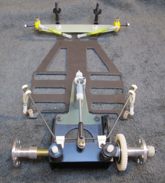

Roll bar cleaned and added. As mentioned before this is a handbuilt prototype roll bar. Roll bar provided additional stiffness to the rear end for high grip conditions, also tweak could be adjusted this way.
When watching several Euro Panther photos I found there were several choices for the lower roll bar mount. I went with the same outside position as Chris.

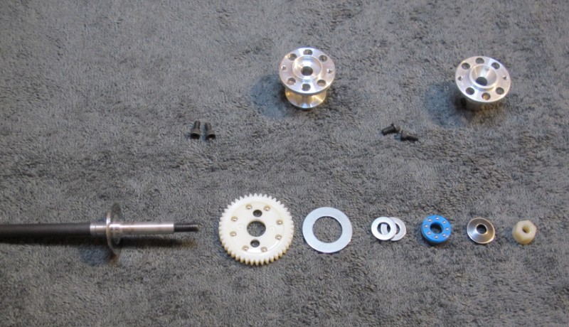

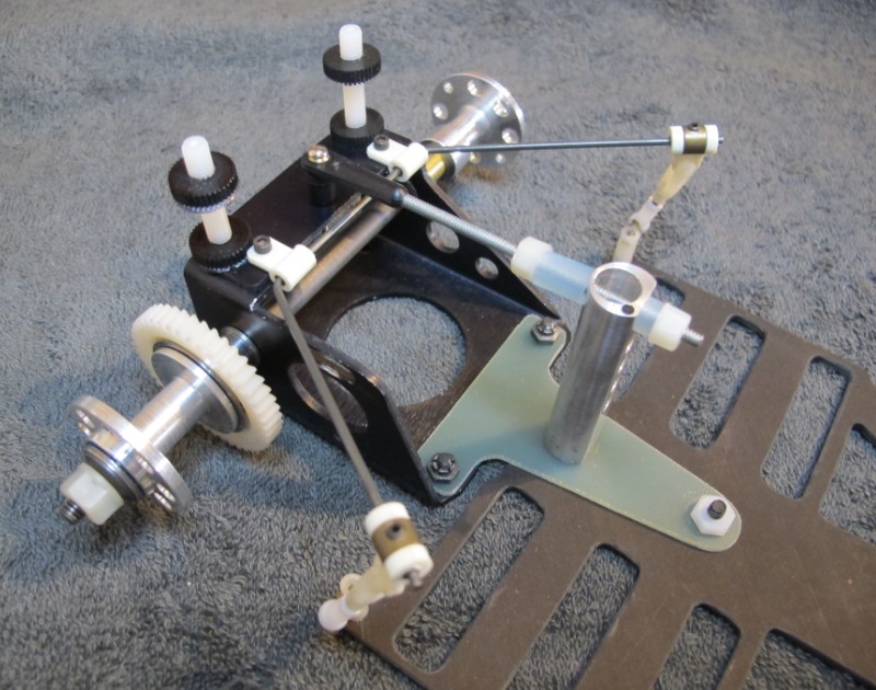

Rear axle diff was next step. Chris provided a Parma graphite axle where the diff ring was epoxy glued. New Parma Panther hubs and usual diff hardware were used also. The diff hub was a quite tight fit so a reamer was used for making this work.
This diff is old style and doesn´t use ball bearings at the diff.

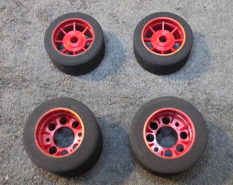

At some point I mentioned I will keep with white color scheme for most of the plastic parts but there will be red parts also.
OK this now where the special red parts will be added.
