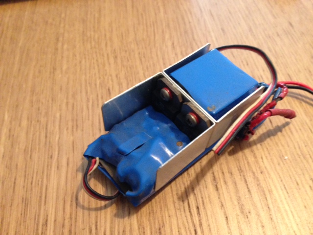

I got my paws on one of these rare beasts.
The last demon speed control before the FET's.
The poor thing suffered a reverse power up but luckily these and the later proking had power diodes to at least protect the transistors. I should have it up and running soon. :D
Specs: BD249C power transistor 25A forwards
TIP36A brake 25A
TIP42 BEC
2x 10A relays: Reverse & Bypass

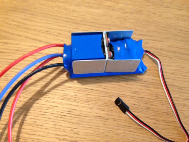

I replaced the burnt out protection diodes, and all the wires.
Tested... Works fine :D
New heatshrink and more or less done.

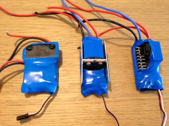

Can't resist the familiy photo ;)
These are all the Demon Speedos I have managed to find, from left to right: Demon 2C 1981; Demon 2DH 1984; Demon Proking 1986.

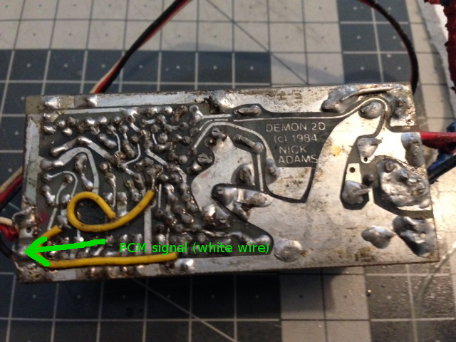

I have one of these, that I received with a sg coyote, the wires to the receiver and the motor have gone, do you have a wiring diagram or a close up shot of where I should solder them on? Hope that makes sense? What car would this have go on to? I will try to get a picture.

Hi,
These speed controls where still being used by club racers until about 1987. I think it would fit most cars of about that era.
The picture is the best I could do ;) I'm sorry I screwed up the arrow of the PCM signal wire it is meant to point a little further down to the pad in the middle. :oops:
If you need any more help just ask :D
BTW this is a reversing speed control so don’t mix up the two red wires! :?
