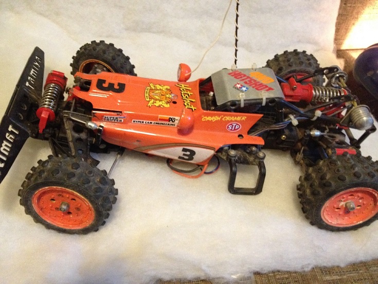

I have an original Hotshot, it was sooo much fun and really handled the hard stuff well. It been sitting for 30 years has a broken rear suspension part and needs to be sorted.

just looking for feedback. I've been out of it for years, is there a vintage class for racing these or do guys just restore them for fun?

The rerelease parts should be a direct fit and get you back into running condition. Is it the arm that is broken?

its the rear linkage part of the top a-arm that hooks to the rear monoshock

Not sure how shipping would be to Canada, but eBay has lots of em

Re: My Vintage Hotshot 4WD
Yes. Just completed a build of the re-release Hotshot (with a few custom parts) and comparing the manuals with the original most parts are pretty much identical and therefore interchangeable.
Have a look at the old and new manuals on line just to compare.

Got my hotshot apart yesterday. All in all, it looks pretty good for a 30 year old car that was really abused by a young and inexperienced kid!
Front arms and hubs will be replaced. Top chassis as well.
Ordered complete screw sets too.
Question--the old 4wd shaft is the "hexagonal" type. Newer version is the "dog bone" type. Worth upgrading? Everything looks okay for the time being, but just seeing what folks thought.

Nah, not unless hex ends are so wornout they're slipping. If they work just clean & regrease (I use molybdenum grease), no reason why they won't keep working. Even the Boomerang's bent wire driveshaft works well enough for bashing around.
