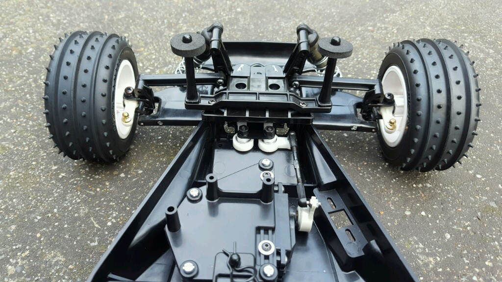

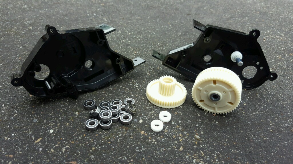

First thing is to swap out the plastic bushings with bearings. The bearings were cleaned out of grease and oiled with a light machine oil. This truck was obviously only assembled as there wasn't a trace of any grease or oil anywhere.

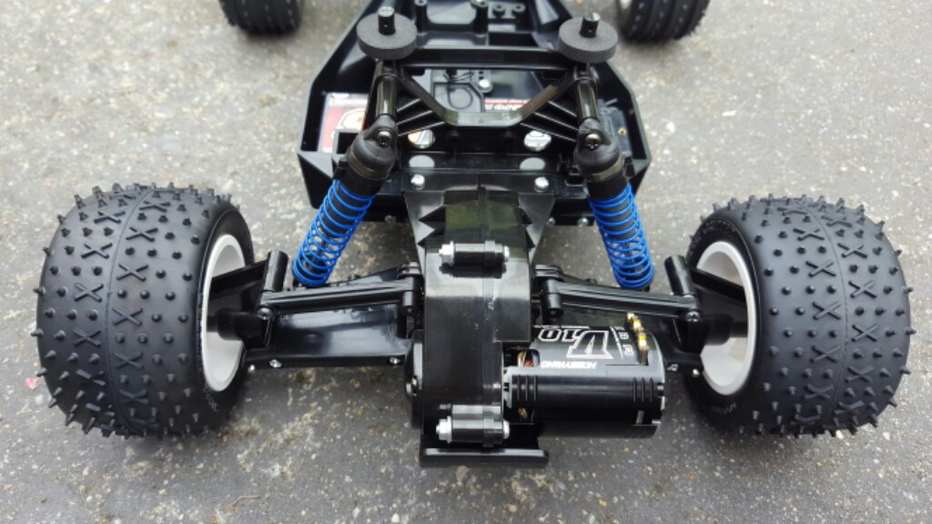

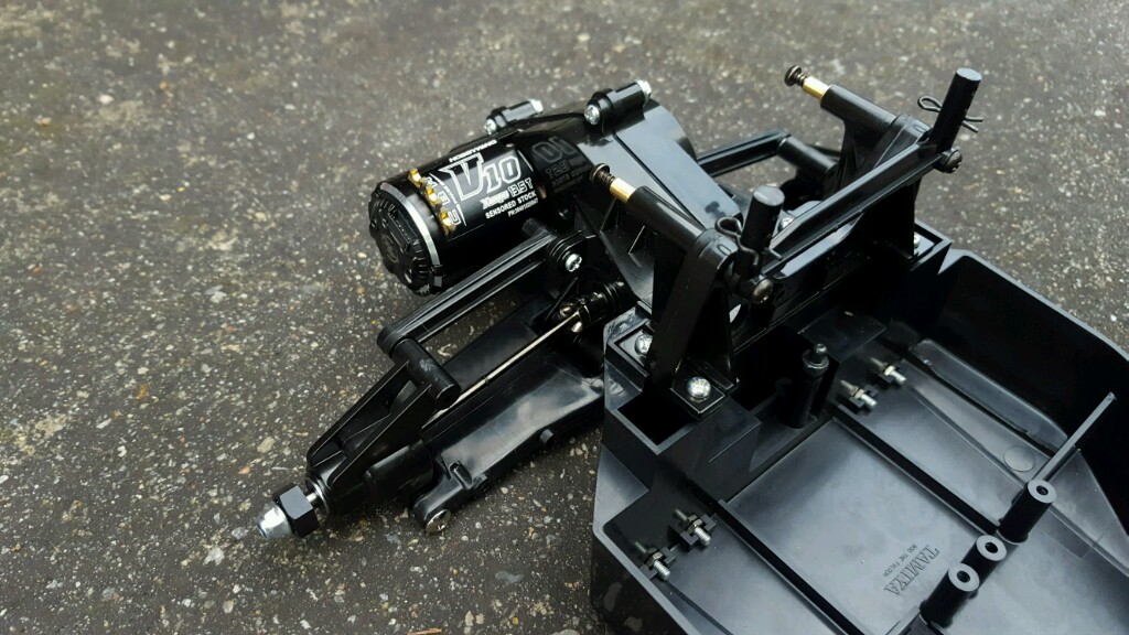

V10 mounted in car, these are pretty basic cars as there's not much to them. I will definately put lundsford turnbuckles and white RPM ball cups just to make it a little bit fancier.
Gotta work on shocks next...

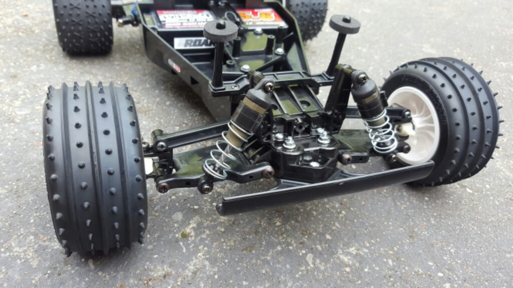

I couldn't leave it well enough alone so I modded the steering. I just need to purchase some turnbuckles for it now, I'm keen to run it so I will likely just use threaded 4-40 rod for the time being till they arrive.
All in all the steering turned out better then I had hoped for and looks pretty factory I think.
