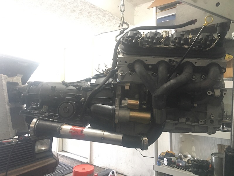

Here's a preview of the new exhaust before I pull it to finish welding. And a couple of the old setup.

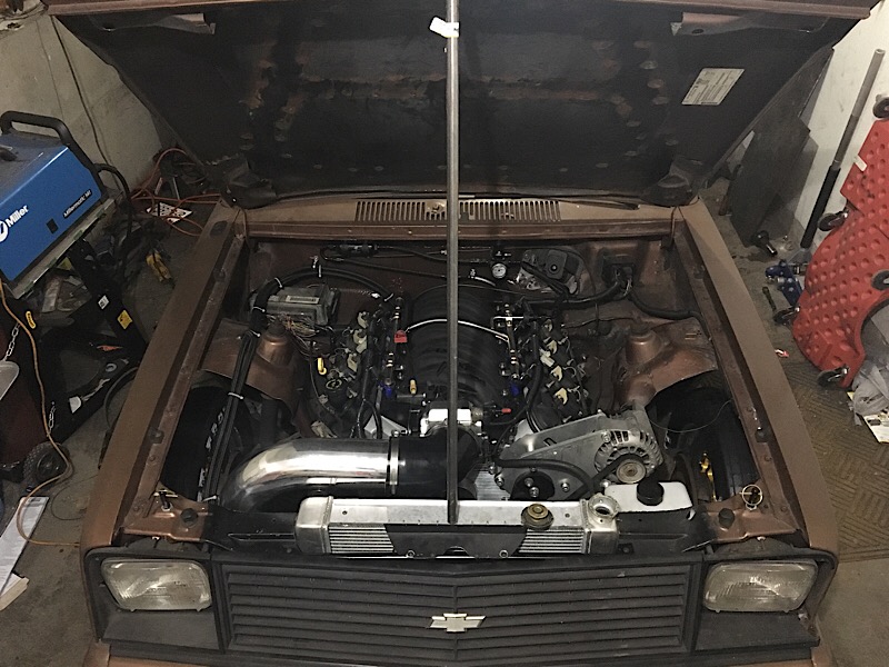

I've had things wrapped up for a few days. Just rolled the car out to do some cleaning. Just waiting for the tuner now. Here's the new look inside and out.

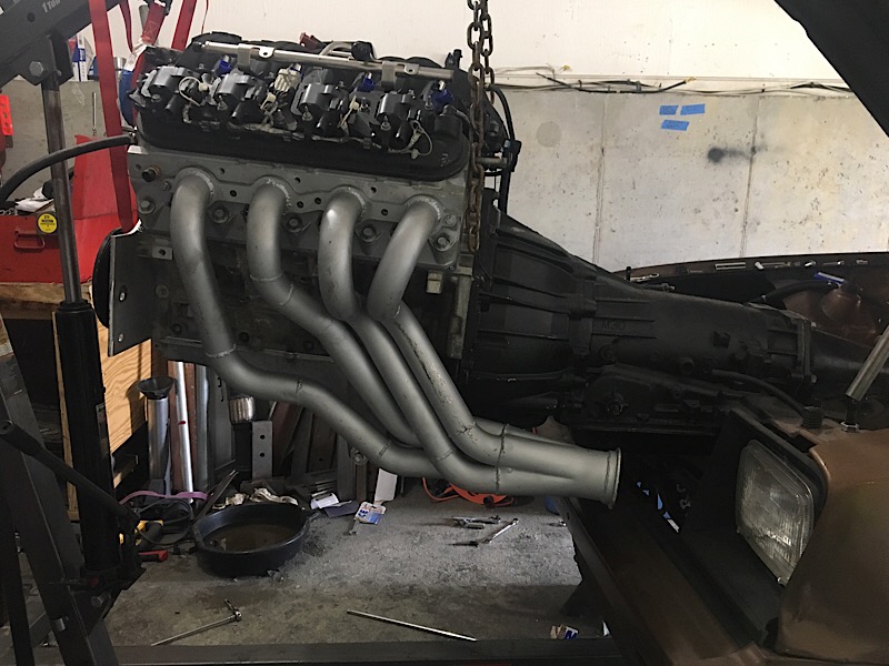

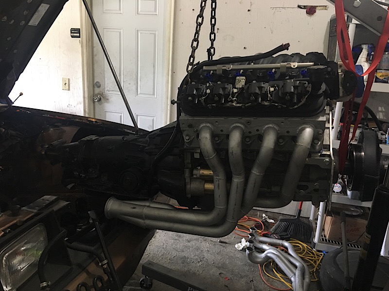

So during my tuning I found out that my camshaft does not like restrictive exhaust, at all!! So out came the old exhaust. After staring at what I had to work with there was just no way I was going to build a capable header that would fit, and be able to slide in after the engine was installed. Or not block the engine mount bolts by installing the engine and headers at the same time. So on went a set of engine plate mounts. After doing lots of reading I had to just go with the several testimonials that running just front plates and trans mounts is ok. Then I had to pull the engine to remove the old mounts I had added. And finally engine went back in and so did tubing. So after a weekends work I now have the drivers side primaries fully welded. I'm going to grind them and finish assembly of the header tomorrow. So far so good. Just hope the passenger side goes as well. These should definitely flow as good as an off the shelf full length header. They are now 1.875" into 3" collectors.
romulus22
Posts: 2546
Location: KY
Has thanked: 885 times
Been thanked: 773 times
Re: Project: LS1 Chevette
Post by romulus22 »
Well what a pain in the butt that was. In order to get the headers on the car. The engine/trans has to be pulled. Pretty much zero access to the starter now. And with the tubes as close as they are to the starter I'm not sure how long it will live. So when the time comes that the starter fails I'm going turbo and running forward facing headers and dumping the downpipe out the fender. I'm over this exhaust troubles. Now that it's all back together I'll have to get it re-tuned for some final numbers. Might take a few weeks to get it on the dyno though. Anyways here's some pictures and a new idle clip.
