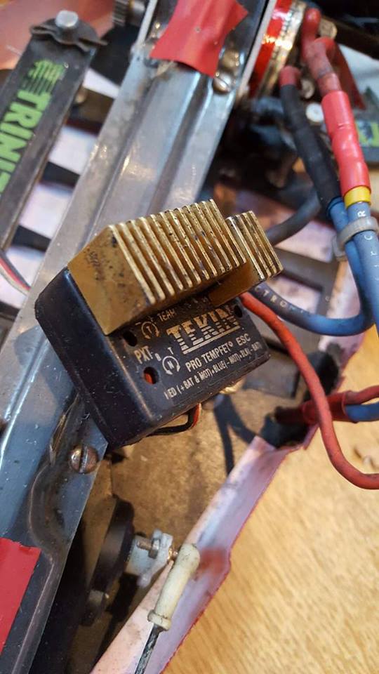

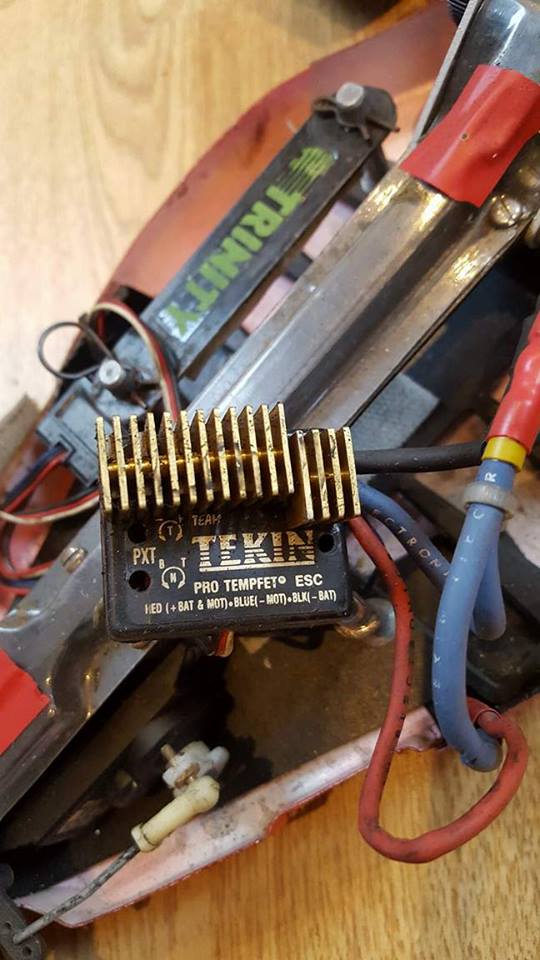

Hi guys, another ESC ID issue for you. I picked this up in a recent haul and tbh i never really used Tekin products bitd. I am trying to establish which model this is. There are spec differences between the 300 and 600, but how can they be identified from the labels?
I am hoping the 'PXT' lettering to the left of the label on my example means it is the higher spec Pro XT version. Would this be correct?
I was a Novak guy so am wondering how this might compare... Do any of you guys still use these old speedos with the more modern electronics of today?
Tekin ESC '300 Pro T'or '600 Pro XT'

Re: Tekin ESC '300 Pro T'or '600 Pro XT'
Great! Thanks for that. Looks like this is the higher spec 600 version then
- Posts: 1282
- Location: EU
- Been thanked: 100 times
It´s a PXT what actually means Pro XT. This is the competition version of that series. Tekin always used a 3 wire setup for their highest rated ESC which does confirm the Pro XT again. The 600 Pro actually use the same FET version and rating but a 4 wire setup.
https://classicrc.wordpress.com/esc-electronic-speed-control/tekin/tekin-pro-tempfet/
