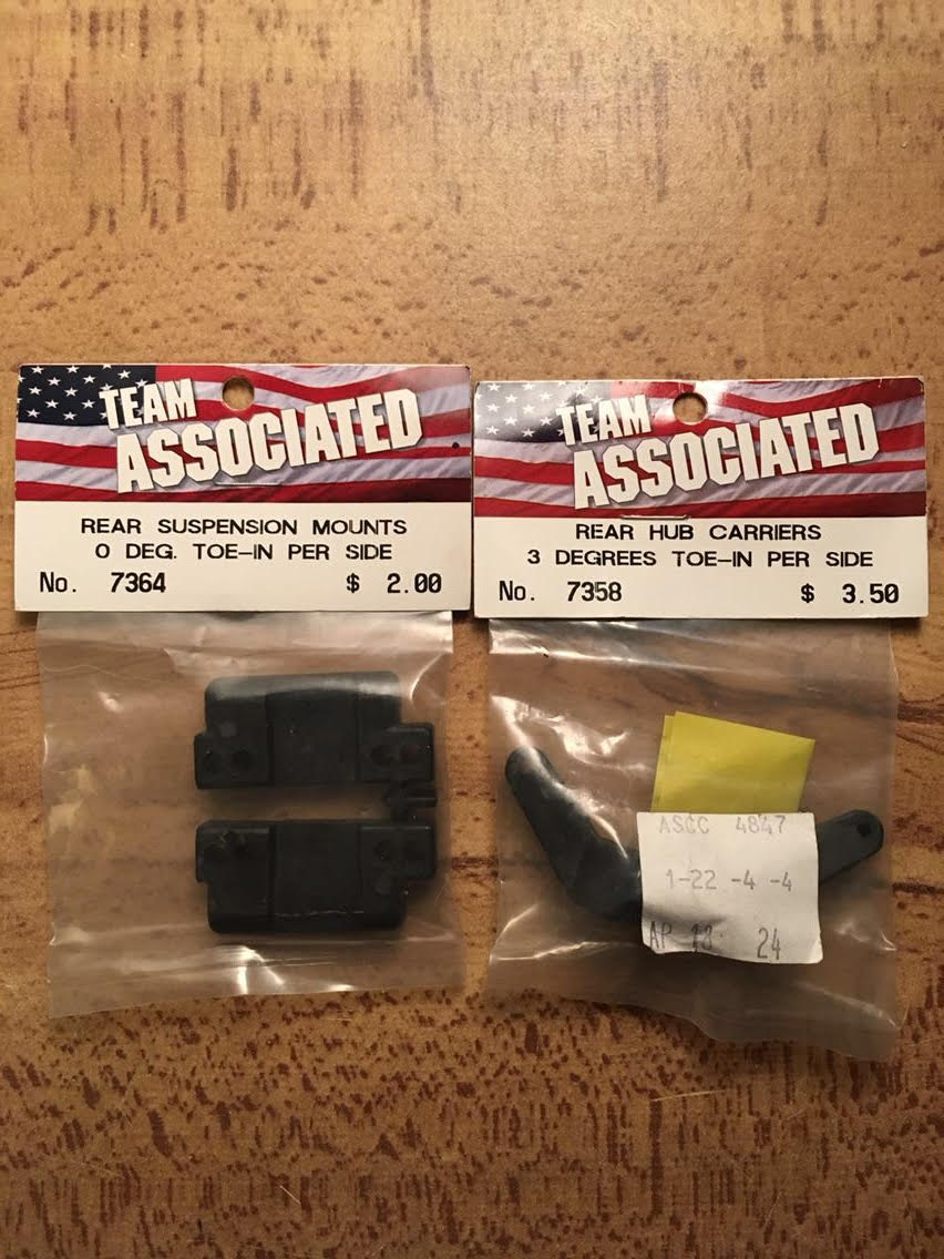

Re: Will rc10 3 degree rear arm mounts work on an rc10t?
Did Associated change part numbers and possibly the specs on some parts?
According to the original 10T manual:
rear mounts, part # 6360 (does not specify degree of toe in, but Google pictures shows 1.5 deg on older packaged parts)
rear hubs, part # 7358, 3 deg of toe in
On my 10T, I have 0 deg mounts and 3 deg hubs. Attached is a picture of the spares I have, notice the part number on the mounts. That is what is now the rear hubs.
