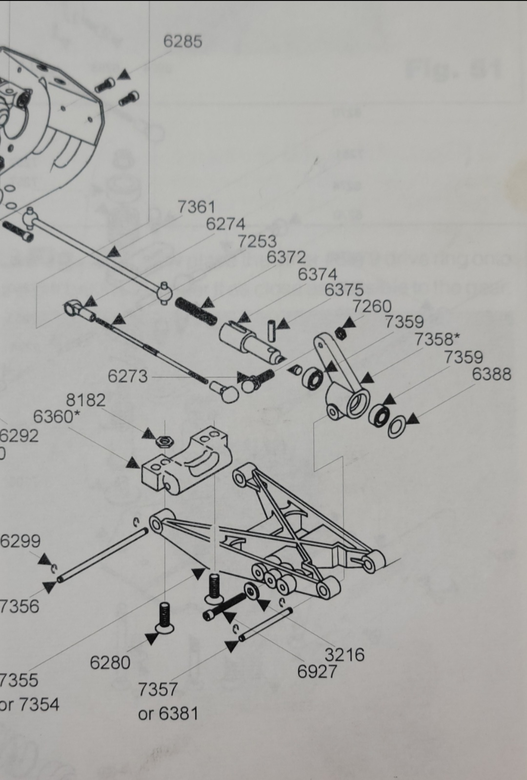

The sheet specifies 0degree hubs, but doesn't mention what mounts were used. Looking at the 7001 manual the truck shipped with 1 1/2 degree mounts and 1 1/2 degree hubs. Did they ever issue a webbed arm kit with 3 degree mounts?

This is what mine shows. I believe those are 1.5° mounts and 3° carriers, but that seems excessive.
I don't like using 3° mounts on a truck, due to the control arms length. To me, it looks odd.

RC10T standard kit parts are...
4.5 degrees total rear toe-in per side.
6360 1.5 degree rear arm mount
7358 3 degree rear hubs

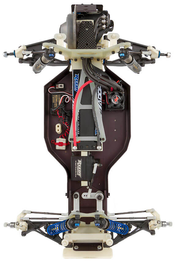

But...Pictures of the rear end and top view show 3 degree rear hubs, and 1.5 rear mounts, on long wheelbase. The pictures are definitely not whats written on the setup sheet.

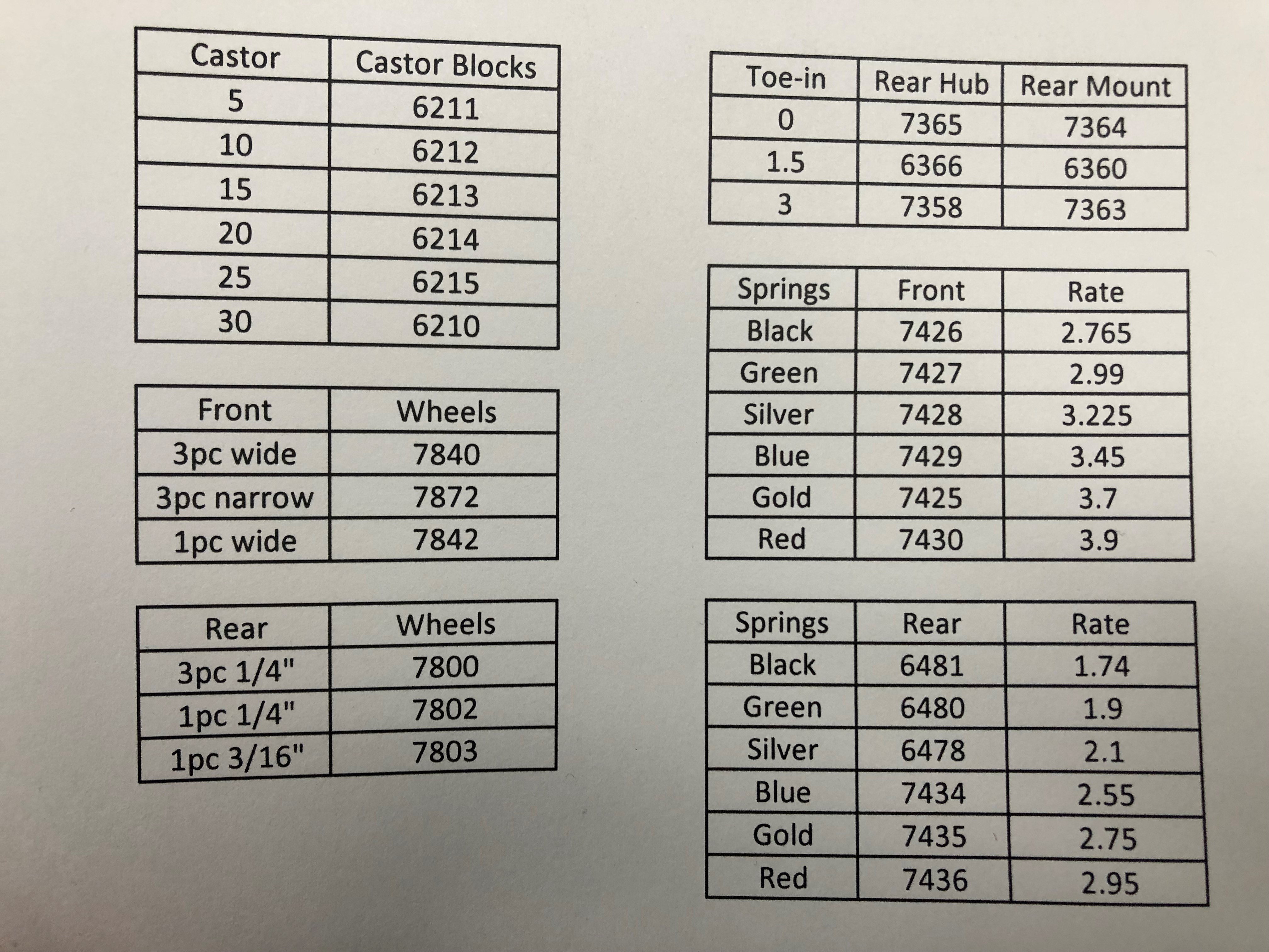

Post by Mark Westerfield »
RC10T setup option part list
https://www.reedyrace.com/ae/spotlight/pages/RC10T_Van/index.html
If you look really close, the car setup and hardware changes slightly in every picture... I assume that liberties were taken for the photo shoot. I'll assume that the suspension setup would have been left alone.
The setup sheet lists the toe in at 3 and the hub at 0. The car was using the mounts came with the kit. but given the rolling changes on associated sets I am not sure what that would even mean.
