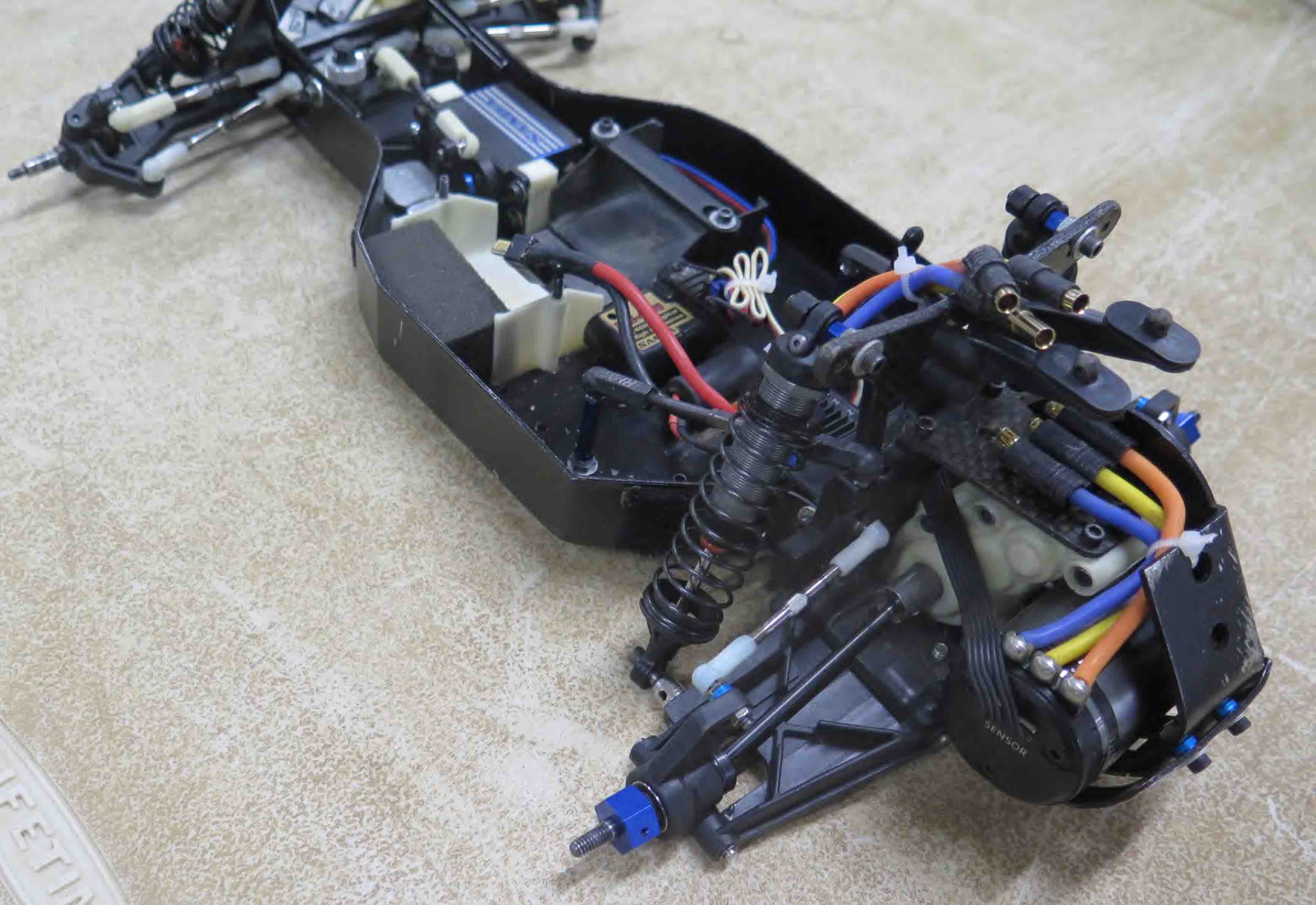

Hi, here is my RC10. This car is really fun to drive.
Please let me know if you have any comments or questions.

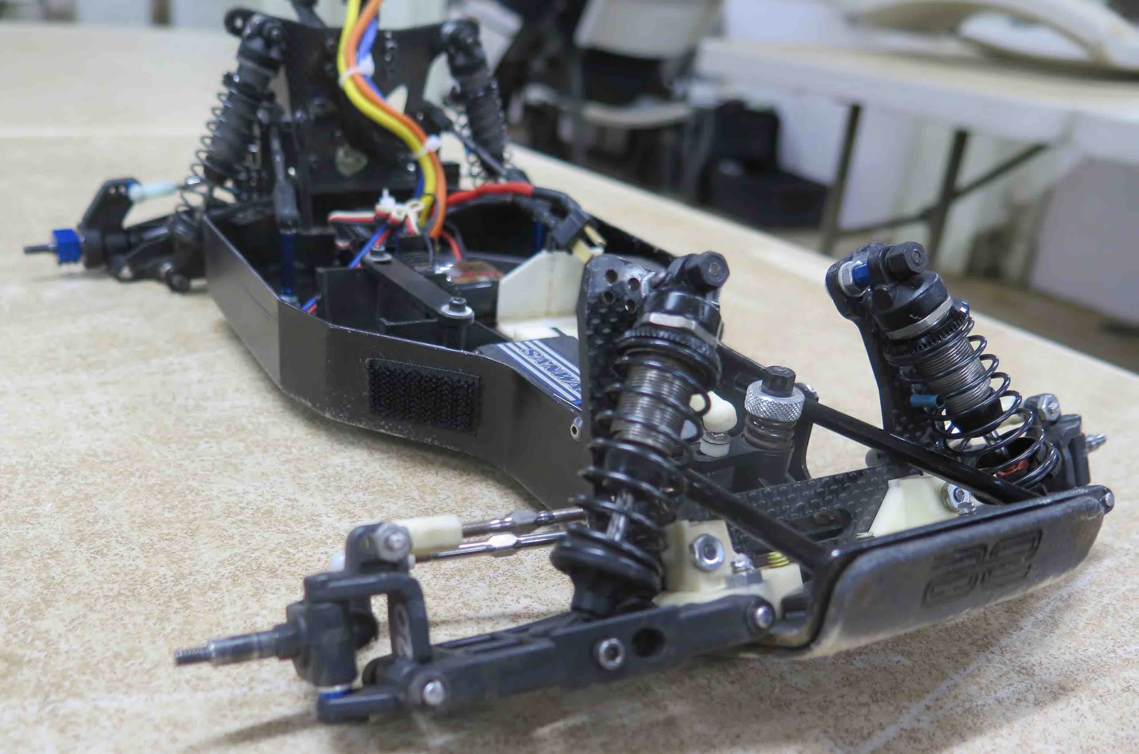

<Front>
・Add weight 10g on the nose plate and 20g right by the steering servo
・Front bumper from Shapeway (rapid_rc)
・Extended front shock tower from Carbon works (3mm)
・0.89 V2 shocks with big bore spring
・#35 oil and blue spring, outside hole on the arm and inside on the tower
・Shock tower and suspension mounts are tightened with hex nuts
・RC10GT steering bellcrank (easy to break though)
・B4 20deg caster block (shims in bottom)
・Trailing steering block with T4 axle (make the wheelbase short)
・Low profile ballstud without shim on the steering block (bump in)
<Middle>

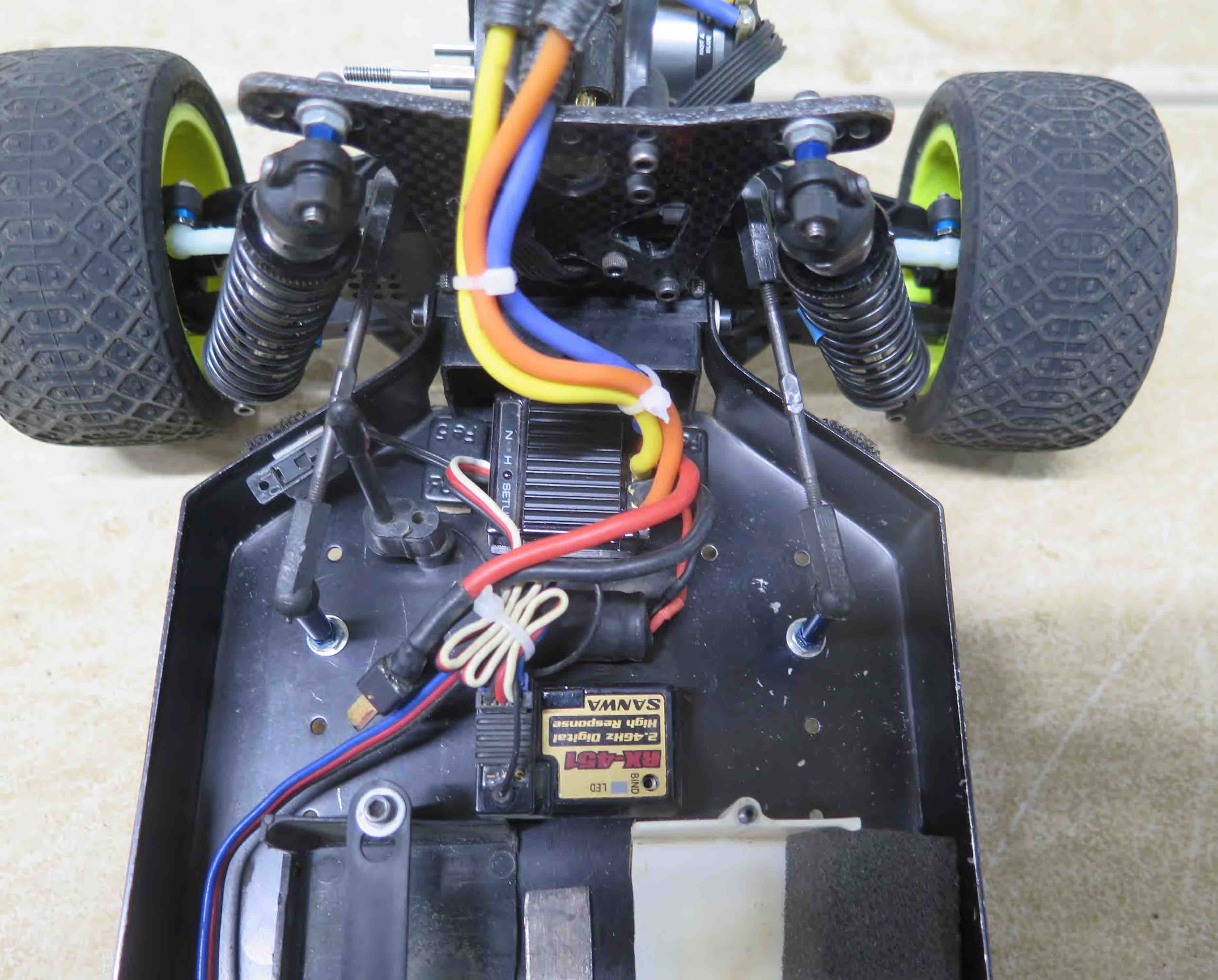

・Short lipo behind the steering servo
・ESC in front of the rear bulk head and add 5g weigh each side of ESC
・Add linkages from the rear bulk head to the chassis to reduce damages on the side holes, which connect the chassis and bulk head (B44 battery posts are used)
<Rear>
・Normal length shock tower with wing mount holes from Carbon works (3mm) and B5 wing mount
・V2 shocks from re-re RC10 worlds with big bore spring
・#30 oil and blue spring, outside hole on the arm and the second hole from the inside on the tower
・RC10T2 arm mounts (3 degree toe in) with long wheelbase holes
・Add a thick spacer between the shock rod end and rear arm
・B4 hub carriers, 0-degree toe in (I use the left hub for right, vice versa) with axle spacer crush tube
・Vintage stealth transmission case with B4 top shaft
・SC10 rear hex adapter to achieve the rear width close to 250mm with modern tires
・Yokomo B-MAX2 CVA shaft where holes are opened up to accommodate RC10 CVA coupler
・Add 2mm shim between the motor plate and chassis
<Other things>
・The front width is narrower than the rear
・B stamp chassis
・Lunsford turnbuckle
・I usually go to an indoor clay track

Re: My RC10 (runner)
Thank you very much for your comments.
Unfortunately, I only have one digital scale and have never measured the weight distribution.
I will update this information if I have a chance to measure it.
I came up with this setting after considering balances between yawing, pitching and rolling of RC10 (with the short wheelbase and rear motor position). Of course, I could be wrong but I really enjoy this whole process and driving this car.
The linkages are mainly for big jumps.
I found that the 4-40 x 5/8 screws' head, where screws hold the rear bulk head and chassis from both sides, shaved the chassis.
I added one shim below the screw head and installed linkages. The linkages stiffen the chassis and should disperse damages.
I swap rear hubs to make the upper camber link parallel to the rear arm (it looks better!).

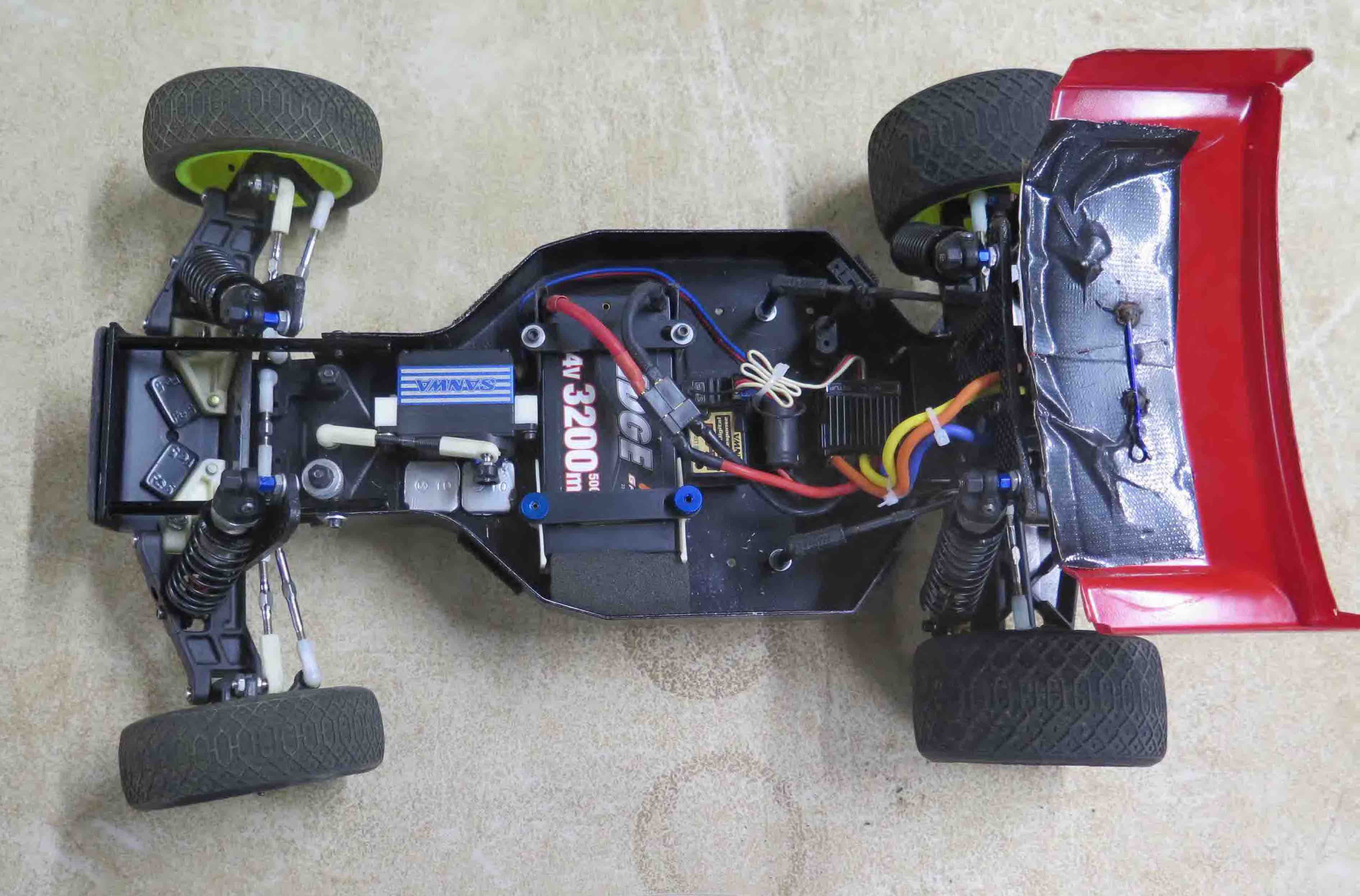

You've certainly put a lot of thought into your car and I can appreciate that.
Do you recall the part number for those Yokomo CVA shafts and if they are longer than the replaced Associated RC10 shafts?
Also, is that first image (top view) distorted or are you in fact running the front wheels toe-out?
- Posts: 77
- Joined: Thu Nov 23, 2017 11:34 am
- Location: Japan
- Been thanked: 43 times
Yokomo bone was introduced below topic.
http://www.rc10talk.com/viewtopic.php?f=35&t=34582&start=45
I simply used Associated CVD coupler (#7381).
Yokomo has discontinued B-MAX2 bone. The new one is Z2-010RB2 (for YZ-2CA) and length is 62mm.
I just received this bone from Yokomo as a substitute for B-MAX2 bone. I have not tried it yet.
I think that the toe-out must be due to distortion. I tried to set 0 degree.

- Lonestar
- Posts: 4270
- Has thanked: 623 times
- Been thanked: 171 times
The rear brace thingies are actually pretty smart... this car was not design for modern BIG jumps, and indeed that's a lot of stress on the rear B/H side holes...
- RC104ever
- Posts: 1506
- Joined: Sun May 22, 2011 11:34 am
- Location: Burlington, Ontario - Canada
- Been thanked: 8 times
I must be really slow lately - which rear bulkhead screws are we talking about here? I looked at my cars and can't figure out which ones you guys are talking about. But I like the idea of making it stiffer so I'm up for anything.
- Chris
Lots of cars...so many cars
- Lonestar
- Posts: 4270
those that hook up the chassis "sidewalls" to the B/H.

My next topic will be about my RC10B1.5, which has much longer wheelbase and more weight on the rear.
Even both cars have the rear motor position, my setting is very different. I hope that you will enjoy it.
I use front B4 caster blocks and B4 rear hub carriers to lower the ride height.
For the current setting of RC10, I try to maximize initial turn-in speed. With the wide rear width, I could have a good exit speed with less rear roll.
Once I design (or set) the car to fit a layout and surface, I make small adjustments during practices.
(I will test different front settings next time.)
