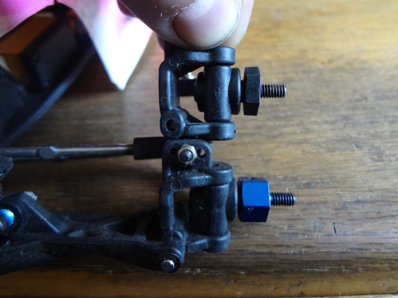

Yes the truck axles are longer and use the thicker 12 mm hex. It's a 4mm difference. So if you use the truck axles/hex, your total front width will be 8 mm wider. Depending on the backspacing of the wheels you want to use, this could be used to your advantage. I included this pic so you can see both side by side.

So, for the b4.2 parts, I would need the steering knuckle and carrier, and either the b4.2 or t4.2 axles, correct? Those would most or less fit into the current A-arms? Then just change the tie rod length to suit.
