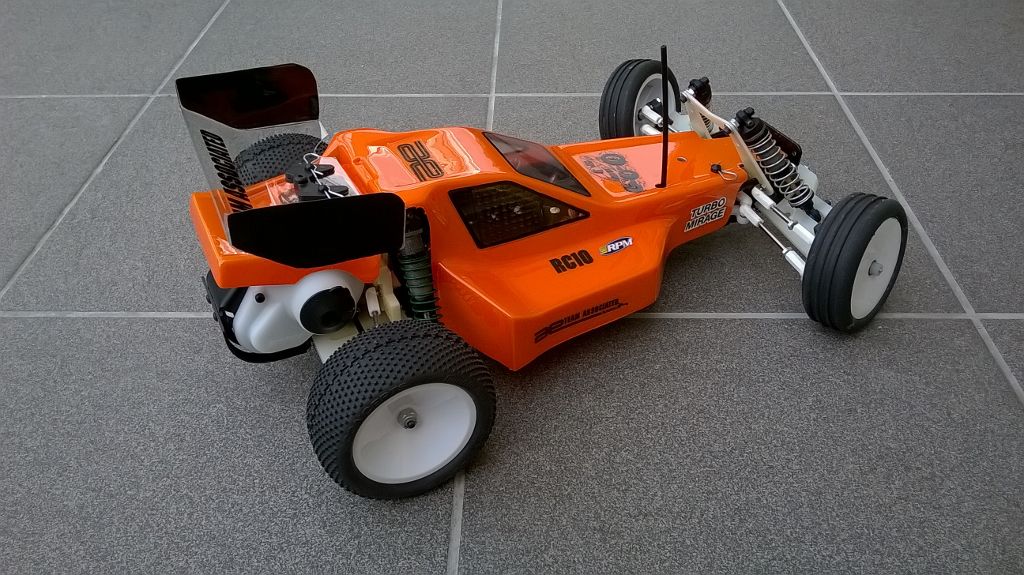

I found 5 old used 25deg blocks, hopefully parts can deal some racing action.
-Niki-
-Niki-

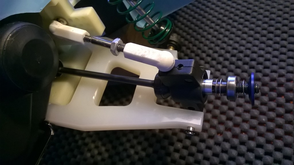

CustomWorks #3241 rear hub is working nicely with two shims between spacer and bearing.

OK, here it goes. With normal track conditions car felt rather good. Too bad that lasted only two practise rounds on Friday. I made the bestlap of vintage class in the first heat I ever drove that car. During the weekend we got more and more rain and my car just understeered more and more. With the struggle agains constantly changing track conditions in Modified class also, I just didn't have time to do anything for the RC10. I know now I should have used 4wd JC's DD fronts (or similar) to get bite on that muddy track.
SpeedPassion 10.5T with blinky ESC. Gearing 81/23.
Front shocks: Silver #7428 spring, piston #1, AE 35wt, limiter 0mm
Rear shocks: Silver #6478 spring, piston #2, AE 30wt, limiter 3.2mm
