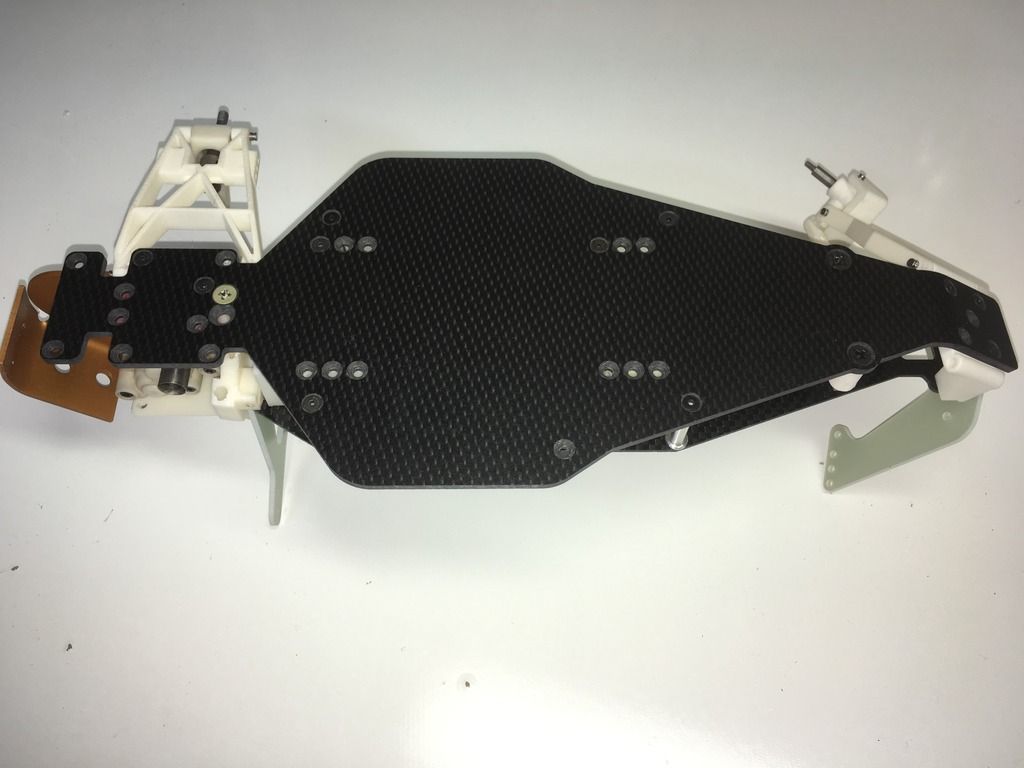

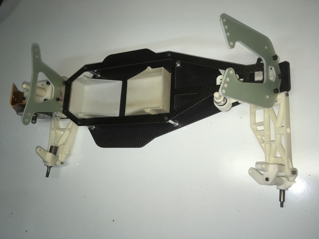

Somewhere around 4 years ago I started working on the 91 IFMAR car. As more pictures became available over the years it became easier to get a more accurate representation of various parts of the car which were impossible to tell from only the old pdf pictures available at the time. I've worked on this off and on since then but am now finally nearing the end. Overall I'm happy with it. It might not be exact to the originals but I'm confident that it's the most accurate representation yet. The only way to be completely accurate is to directly measure one. Making sure everything lines up properly has been extremely tough. Some parts of the originals were clearanced to fit anyways and other parts are just plain tight. Trying to replicate that has been tough. Anyways, here are a couple of pictures. I'm still working on the bellcranks and have a copy of tiny little cleanup tweaks to do in the models. I'm going to print one of these up. Justin is getting the other one as he's been a big part in getting many questions answered.

This has been an interesting project to say the least. When we started it 4-years ago I thought it would be a few months but it's been a much longer journey with periods of intense focus followed by long bouts of stagnation. I have a new found appreciation for the R&D process for scale R/C models.

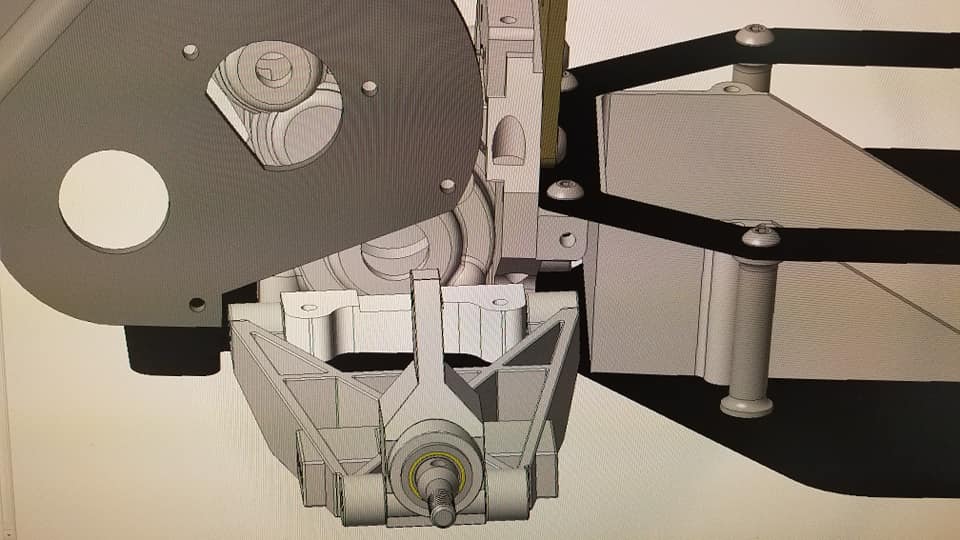

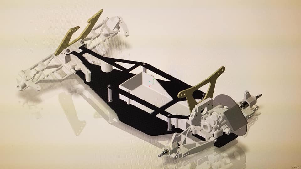

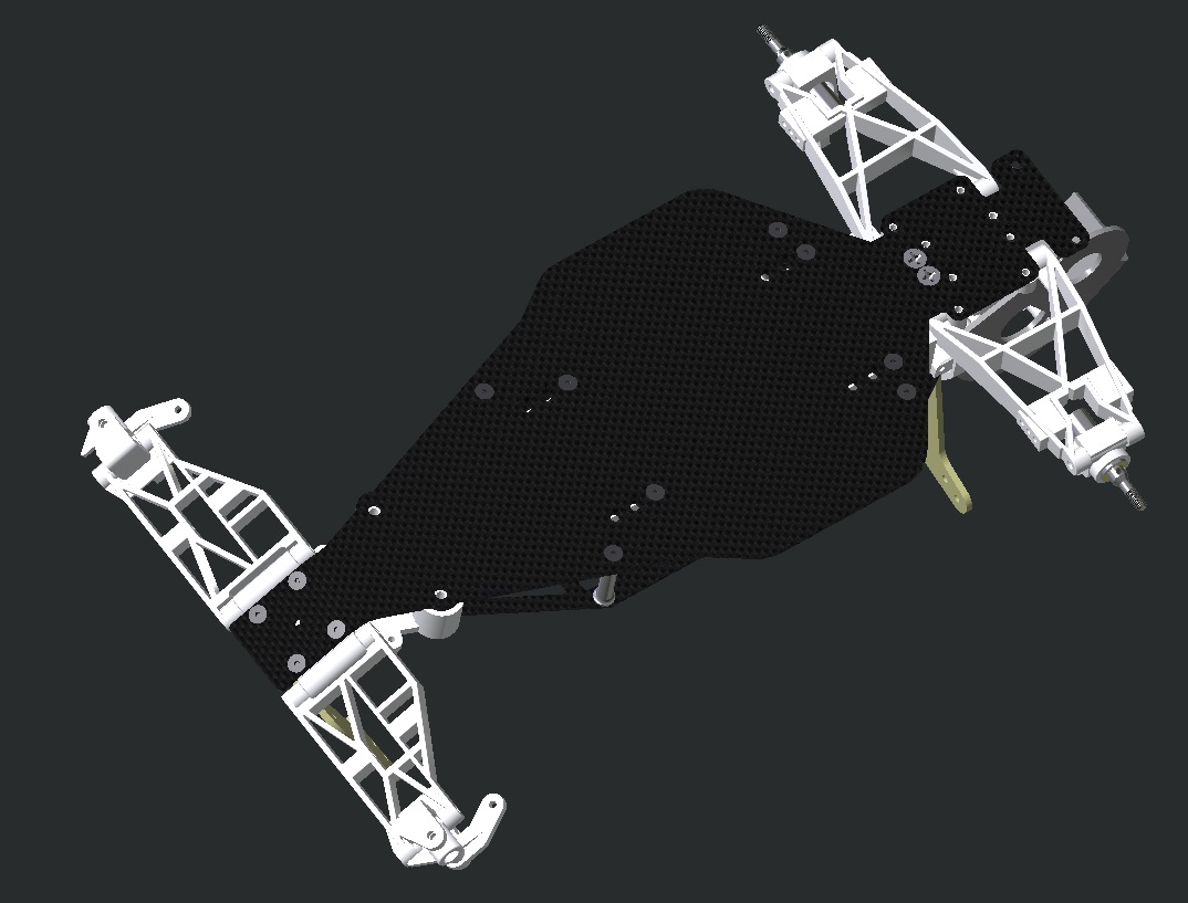

This project inspired me to start working with AutoCAD and that alone has been an incredible learning experience. Having drafted the chassis and shock towers (2-D) I have a tremendous amount of respect for Fred's skill in 3-D modeling the parts- his attention to detail and tireless efforts to get it just right simply can not be understated. The front bulkhead and front suspension/steering were massive time sucks that had seemingly countless iterations.
The process of having 30 degree carbon fiber panels fabricated with the right material and then precisely machined via a jig was both time consuming and expensive. To some degree I had taken these aspects of the process for granted early on but learned a lot as the project progressed.

Notice in this image that the axle centerline is ahead of the diff. Perhaps this will increase rear weight bias and if these cars had a tendency to understeer this might be partly to blame. While doing your research, did you find any options to alter the axle location as is the case with the production RC10?

Keep in mind that it's only ahead of the centerline of the outdrives because of the rear toe built into the arm mounts. If they were at 0° they'd be inline. The picture isn't quite dead on from the side either but yes the driveshafts do slightly angle forward.
As I only intend mine to be a shelf queen replica, I don't really care about reliability issues from printed parts. Yes, they are more fragile. That's just the current nature of the technology. The goal was to make as authetic of a replica as possible, not to make as authentic of a runner as possible.
