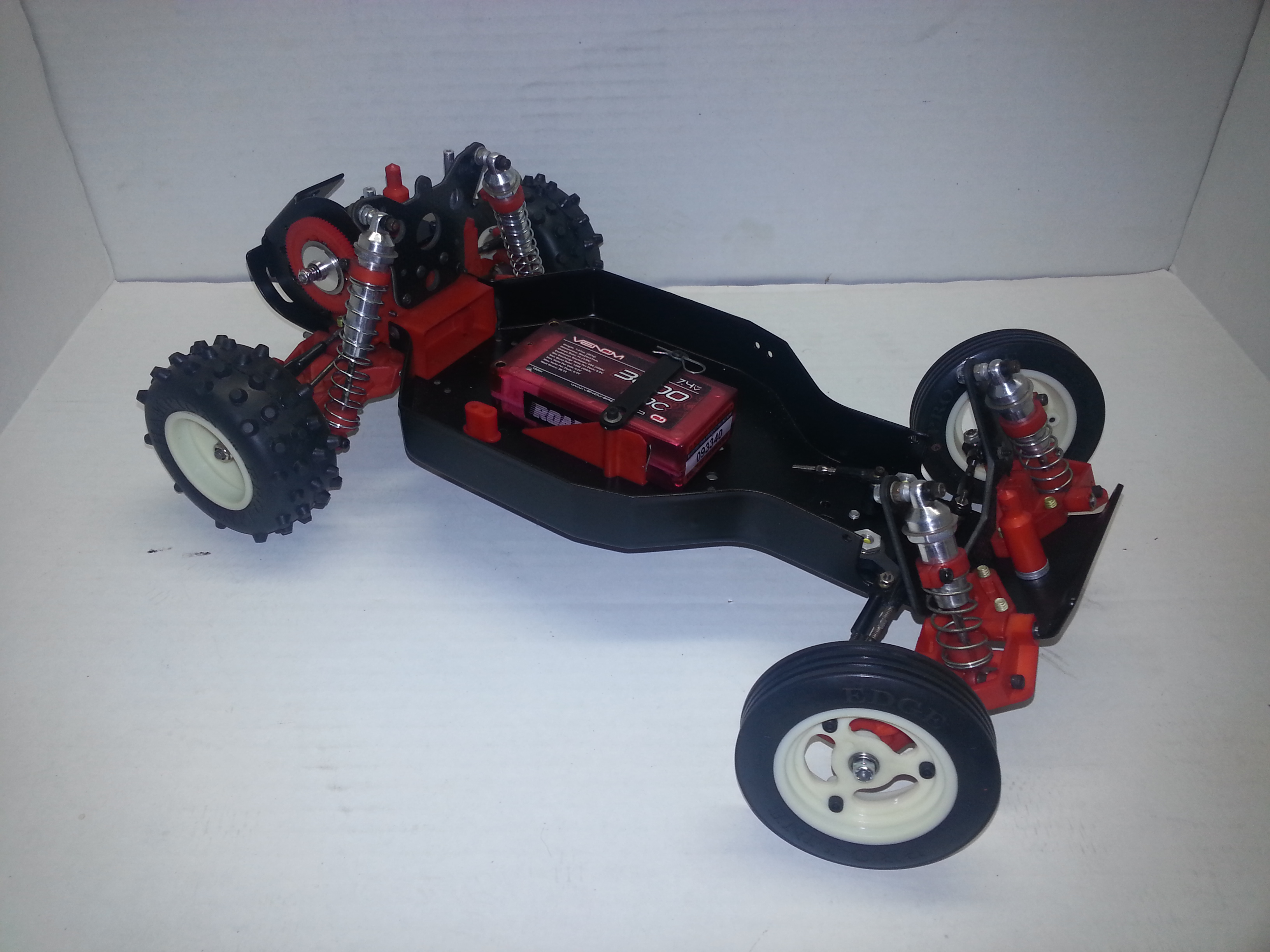

I don't know how your club races are, but up here, 17.5 stock buggy is the most competitive class and the cars are nearly as fast as some of the mod cars. I built a wide front arm, stealth trans gold pan to play with on the track and its fun but could never come close to keeping up with modern buggies. I even tried to set ride height and geometry as close as possible to my B6. I run a Novak 17.5 ballistic motor and esc and its plenty fast, but its nothing compared to my B6 running a Reedy 17.5 S-Plus. I don't want to discourage you in any way-----just a heads up that you got your work cut out for you. We also run on an indoor turf track. I would think a dirt track would be better for an old rc10. Here's a pic of my race cars. The 2.2 wheels on mine are from JC Racing. I've been toying with the rc10 hoping that I could work up some interest in vintage car racing at my local track.

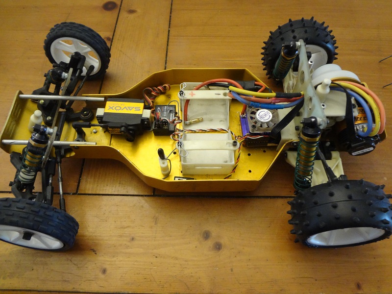

FWIW. Last summer I pieced together an old school 6-gear, short arm, back to basics RC10 to run on my little backyard dirt track. It even has dog bones and the super sloppy steering system. I did the outdrive bearing mod Basher mentioned and have a Reedy 3500kv in it right now. Tons of fun. Love it!
Here's an early photo with old school electronics.
