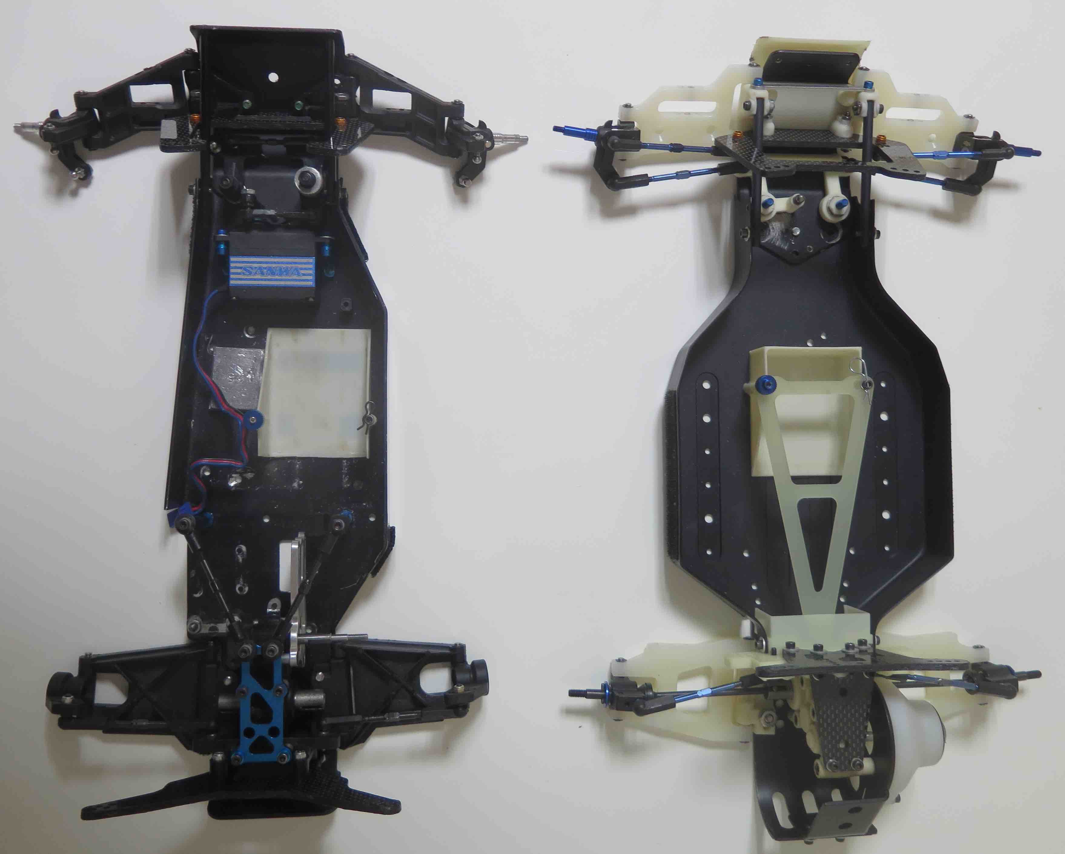

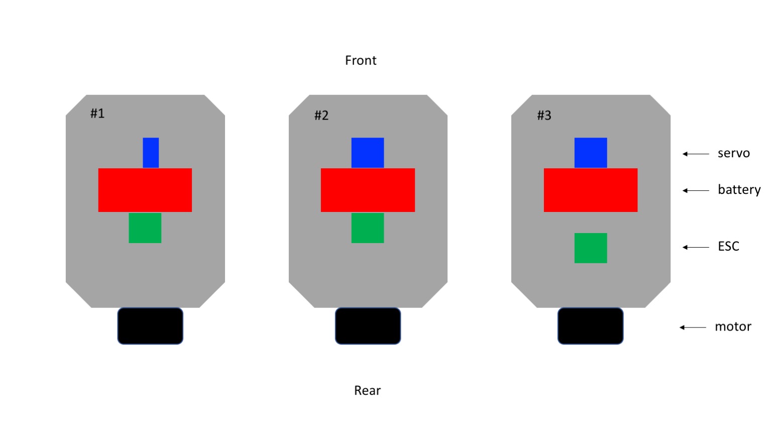

<RC10 ver.2 and ver.3>
RC10 in the first post is convert into version 2 and version 3 is newly built with used and re-re parts.
Both use the short wheel base position in rear arm mounts.
One goal here is to understand differences between two cars with different battery mounting positions (red arrows).
I finish testing version 2 and am working on version 3 now (V2 big bore shock on RC10 is new to me).
I start having one answer to which is good or bad (faster or slower).
But I would mainly like to share my experience here.
I made two RC10s. Left is version 2 and right is version 3.RC10 in the first post is convert into version 2 and version 3 is newly built with used and re-re parts.

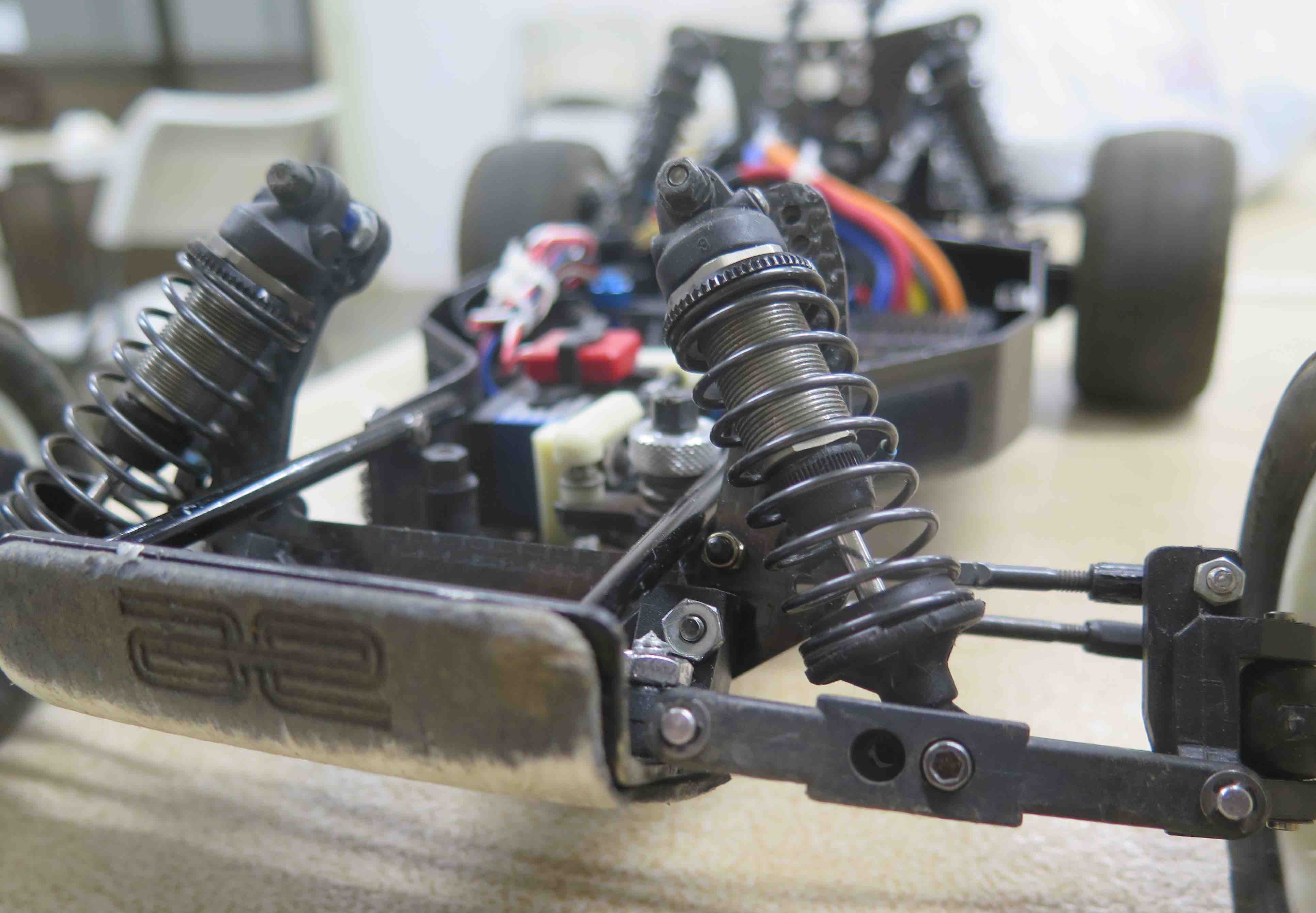

<Front> ・Add 20g weight right by the steering servo
・Front bumper from Shapeway (rapid_rc)
・Extended front shock tower from Carbon works (3mm)
・0.89 V2 shocks with big bore spring
・#32.5 oil and blue spring and #3 piston, outside hole on the arm and inside on the tower
・Shock tower and suspension mounts are tightened with hex nuts
・RC10GT steering bellcrank
・30deg caster block (ASC6210)
・Inline steering block with vintage RC10 front axle (need to use B3 type front wheel)
・Two shims on the steering block under the ball stud

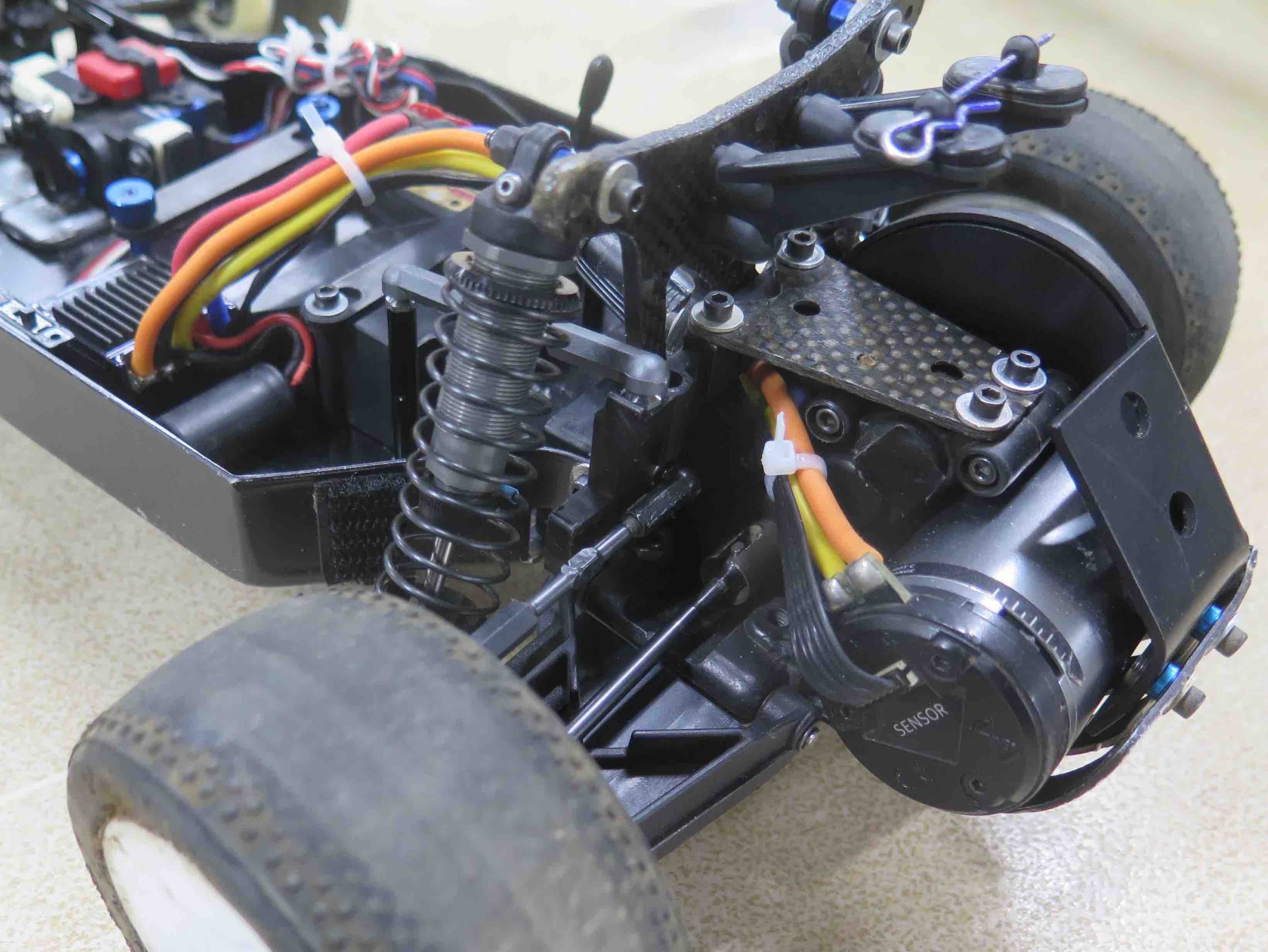

<Rear> ・Normal length shock tower with wing mount holes from Carbon works (3mm) and Kyosho RB6 wing mount
・V2 shocks from re-re RC10 worlds with big bore spring
・#30 oil and blue spring, outside hole on the arm and the most inside hole on the tower
・RC10T2 arm mounts (3 degree toe in) with short wheelbase holes
・B4 RR hub carriers (ASC9584), 0-degree toe in with axle spacer crush tube
・Vintage stealth transmission case with B4 top shaft
・SC10 rear hex adapter to achieve rear width close to 250mm with modern tires
・Yokomo B-MAX2 CVA shaft where holes are opened up to accommodate RC10 CVA coupler
・Add 2mm shim between the motor plate and chassis

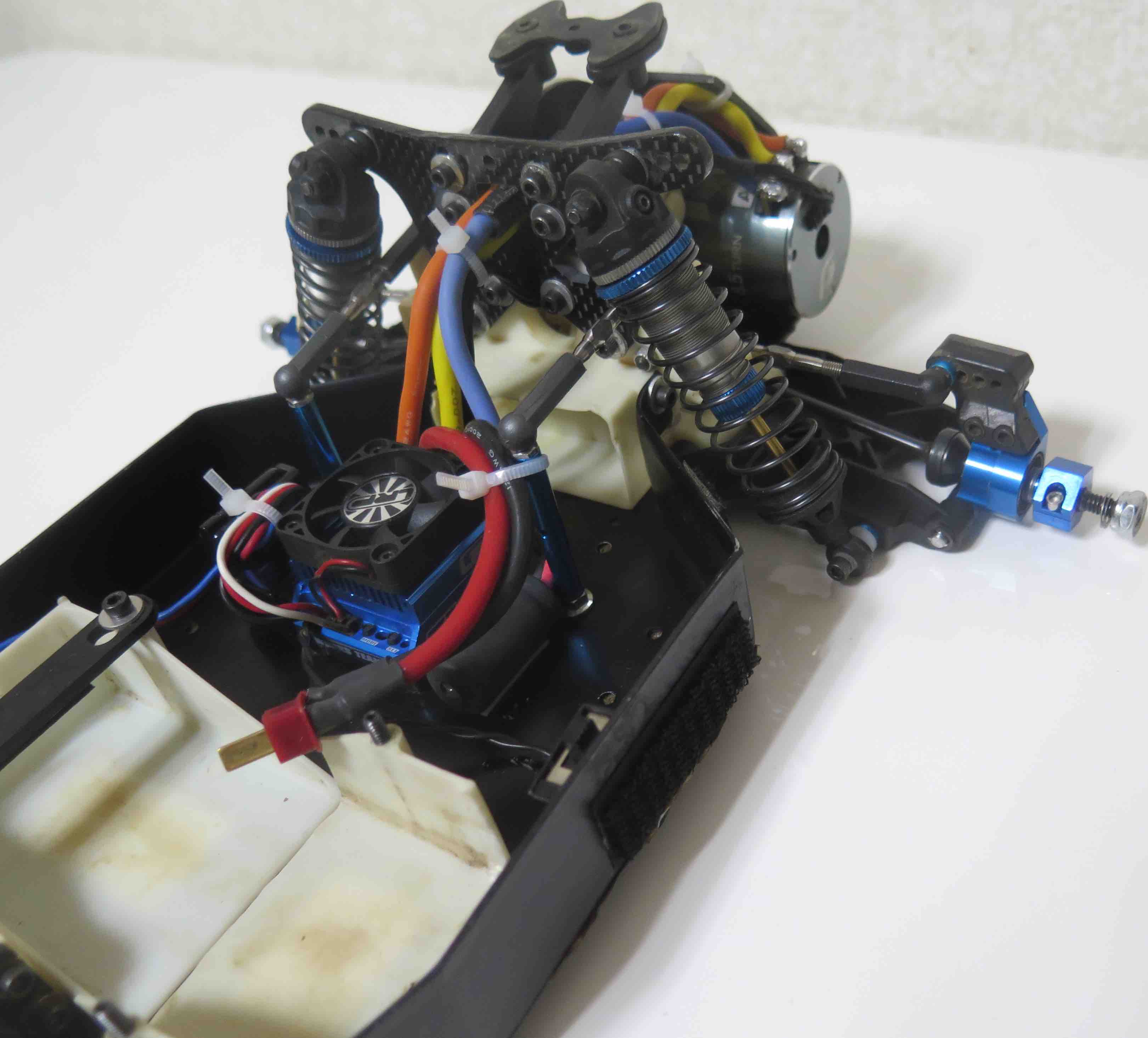

・Black RC10
・The car is twitchy and unsteady on the straight (due to too fast initial response) and suffers from understeer in acceleration. My friend who tested this car is happy with it and does not want any change. His reflex is much better than mine and driving style is aggressive (full speed and braking with sliding rear tires).

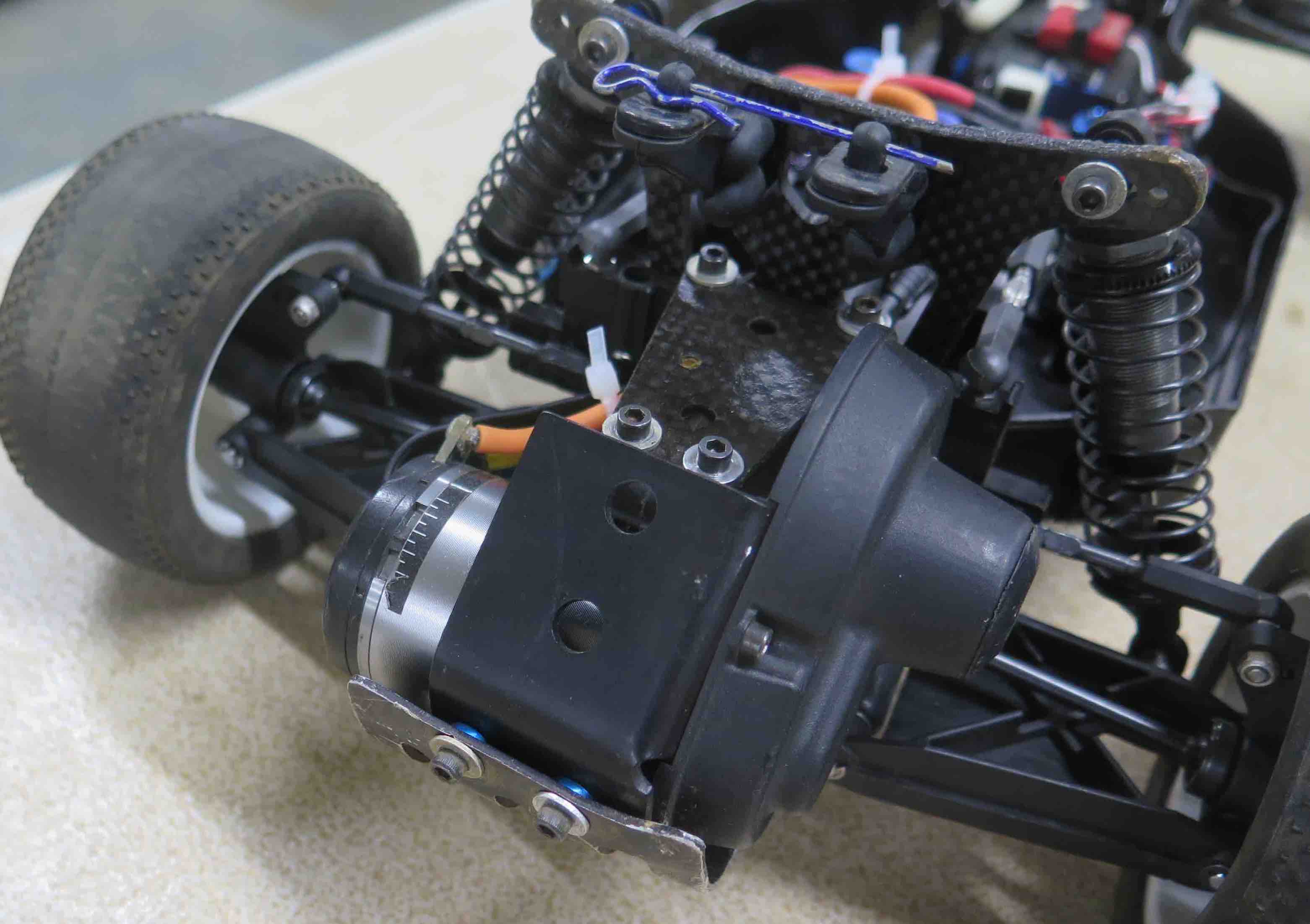

This RC10 is rebuilt from the RC10 in page 1. The battery is installed longitudinally. <Front> ・Add 20g weight right by the steering servo
<Middle> ・Short lipo behind the steering servo and set in the longitudinal direction
・B44 battery post
・RC10 battery cup attached by double sided tape
・ESC is moved forward as much as possible
・Radio receiver is placed on the opposite side of the ESC with 15g weight below it (same as B1.5 in page 2)
・Add the brace from the rear bulkhead to the chassis (different chassis' holes are used)
<Characteristic>
・Black RC10
・In a carpet track, this car ran very well with the long wheel base and the second hole from the inside on the rear shock tower

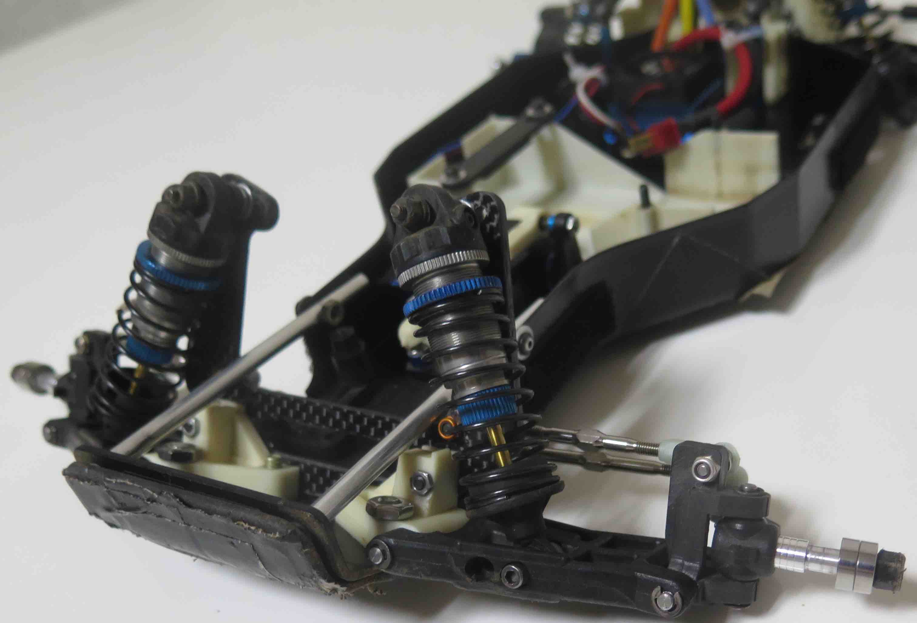

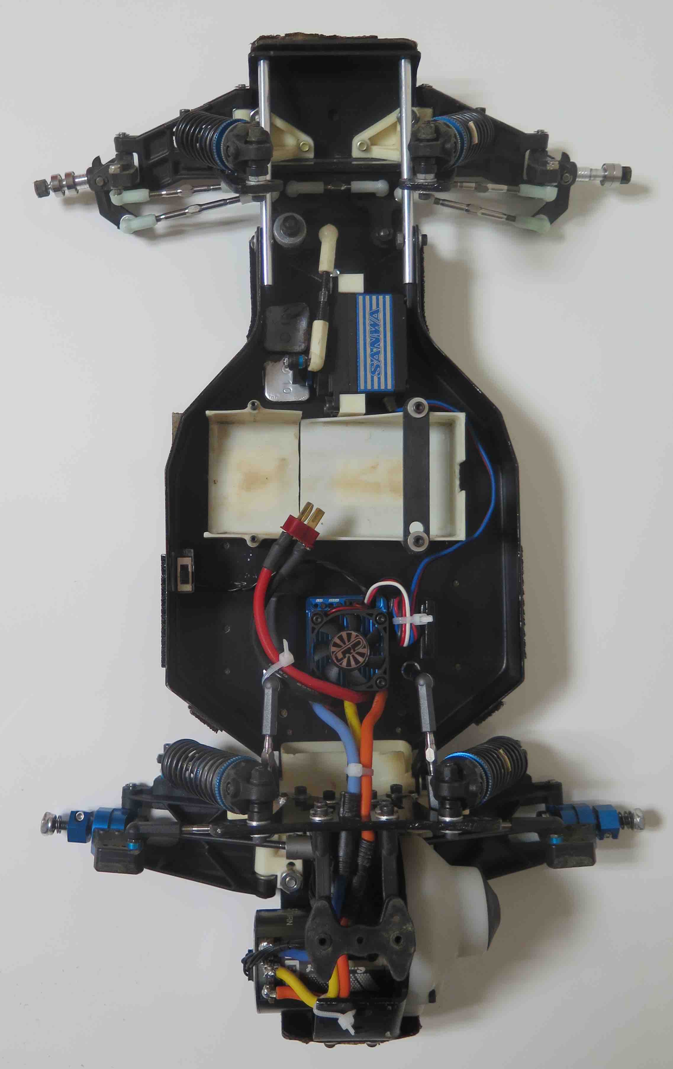

<RC10 ver.3>
For me, this car is best because it turns well, has good rear traction and jump is easy.
I will describe how I set the car which will be answer to Asso_man! and popboy905 (thank you very much for your comments) in next post.
・Extended front shock tower from Fibre Lyte
・V2 big bore shock
・#32.5 oil and white spring and #1.6 piston, outside hole on the arm and middle on the tower

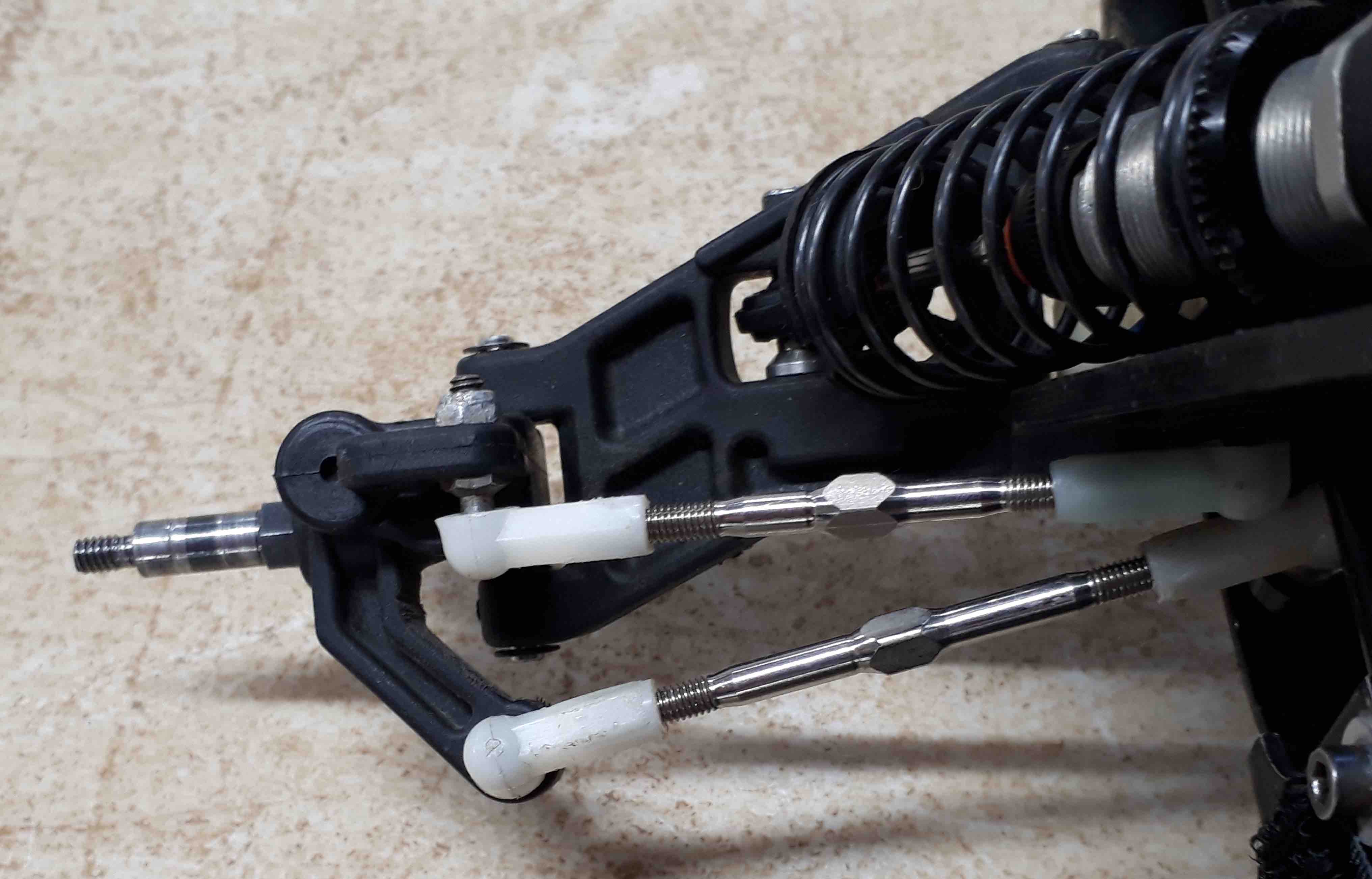

・Inline steering block with RC10GT axle (use B4 type front wheel same as the worlds re-re)
・Two shims on the steering block under the ball end
・B4/B44 low profile ball stud is used for the upper linkage on the shock tower side
<Middle>
・Short lipo behind the steering servo and set in the transverse direction
・RC10 battery cups are attached by double sided tape
・ESC is middle of the battery and the rear bulkhead
・Radio receiver is right by the ESC and the capacitor of ESC is placed in other side
<Rear> ・Low profile shock tower for big bore shocks from Carbon works (3mm) and B6 wing mount
・V2 big bore shock from B6 (maybe the longer V2 shock cylinder of B5M/B6.1 might be better to have enough droop)
・#30 oil, #1.6 piston and white spring, outside hole on the arm and the most inside hole on the tower
・Re-re white rear RC10 arm mounts (3 degree toe in) with short wheelbase holes (tightened with hex nuts for all screws)
・B4 FT aluminum hub carriers, 0-degree toe in with axle spacer crush tube
・B4/B44 low profile ball stud is used for the upper linkage on the rear bulkhead side
<Other things>
・B stamp chassis
・Lunsford turnbuckle
・Front width is same as the rear
・I set this car for an indoor clay track
・I have not run this car on a carpet yet
This RC10 is newly built. The battery is installed in the transverse direction. For me, this car is best because it turns well, has good rear traction and jump is easy.
・V2 big bore shock
<Middle>
<Other things>
・B stamp chassis

<weight distribution>
I have thought that, with modern electronics (brushless motor, Li-Po battery, servo and ESC) and modern tires, we can find some better weight distribution to run RC10 on modern tracks (I mean not loose dirt).
For RC10 ver.3, I tried to find the distribution in the following way (with the short wheelbase position on the rear arm mount). #1~3 correspond to numbers in the above figure.
#1. I put a low-profile servo, battery, and ESC close together. This made the car really twitchy because of too fast yawing response. The car also suffered from understeering in acceleration possibly because the front was too light.
#2. Then, I put a normal-size servo and 20g balance weight right by the servo. Weights were widely distributed. The car became less twitchy and turned better.
#3. Finally, I moved ESC rearward to find a positon where the car is stable but still has good yawing response. I also add a weight under the battery (battery+weight=200g) to avoid understeering in acceleration and to have stability. I will try to reduce a weight under the battery next time for agility.

I have changed a shock setting a little. Current setting is below (only differences are shown). The setting is subject to change under track layout and conditions.
Front
・inside hole on the tower (I will change the piston hole larger and/or oil to #30 next time because the front is a little bit hard)
Rear
・the second hole from outside on the tower

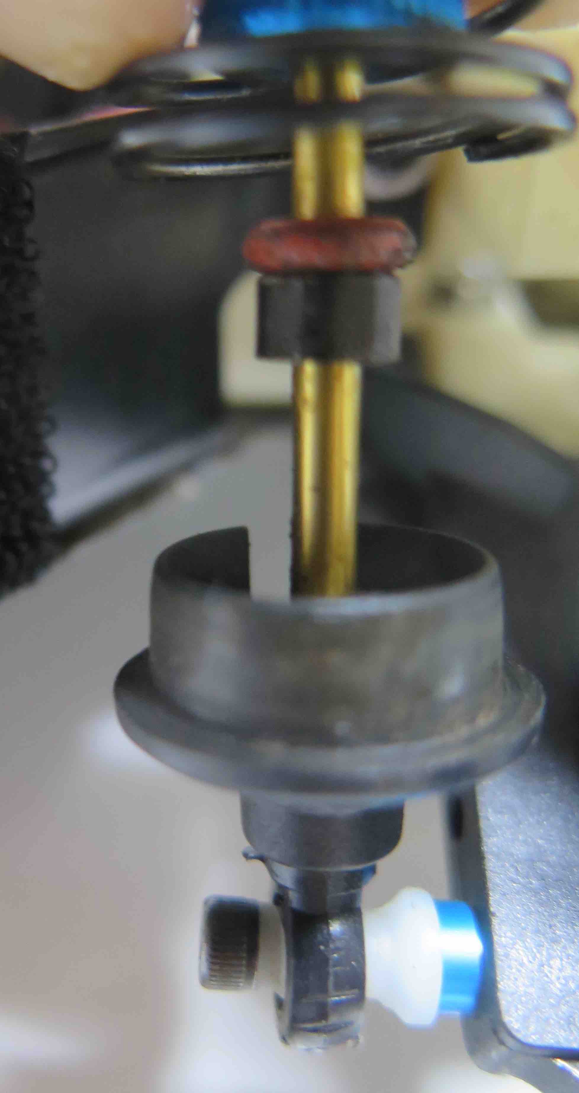

・I add a spacer on the rear shock shaft to avoid binding under compression. <Tie rod braces>

<My friend's RC10 worlds car and RC10 ver.3>
My friend has driven RC10 for years. Another friend, who uses a modern car in a stock setting, drove my RC10.
RC10 worlds car is yellow and RC10 ver.3 is red.
The current shock setting of ver.3 is
Front (B6 V2 front big bore)
Blue spring, inside hole on the tower, (#32.5 oil, #1.6 piston, and outside hole on the arm as before)
Rear (B6 V2 rear big bore, which means stadium truck front cylinder)
Blue spring, second hole from the inside on the tower, (#30 oil, #1.6 piston, and outside hole on the arm as before)
